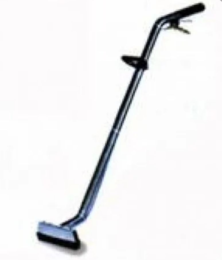

What is or was your favorite wand/tool for sucking water up off a hard floors?
What's the ideal vacuum orifice size considering objects on the floor?
Ideal with of the one head?
Thanks!
Butler used to have a nice Aluminum one that came apart in 3 pieces. Each truck had one under the passenger seat.
As we needed more they became hard to find. We just bought cheap chrome tube with squeegee head. Bought a snow shovel red handle and they work pretty good when needed.
When rinsing floors is where they are used the most. We will pressure washing and extract. Brush wand to detail and finish up.
Kaivac has the best squeegee I've ever used. Extracts so well it leaves the floor practically dry.
There problem is that is only an extraction tool. No rinse system.

Yea there should be. We have brush wands that Lisa sold us that worked great but the jets would get clogged with debris and require cleaned often when ceiling tile, drywall and other debris were on the floor.

Have that Butler squeegee here.
Rubber blades got mushy after a while .
Easy to replace...
Worked well,your answers are on equip ment made all ready.large orifices for max recovery...
Has to be lite weight but durably strong...
Your over thinking this one.
Look at examples made then refabricate your version.
You could make dual flip head.
One side for extraction.
Flip for agitation...
Good luck great post topic...

Yes we had a few and I think I bought 4 more from her when I couldn't get them from Prochem any longer.
I don't know how the heck she became a prochem rep but I've never seen her doing anything of that nature before.
I think your memory is failing to be honest.
That wand was a turd
I think she got them from whomever was building them for Prochem.
The wand was nice but poor design on the head. The jets were in the vacuum slot which required constant cleaning. Just an unnecessary pain that could have been avoided.
