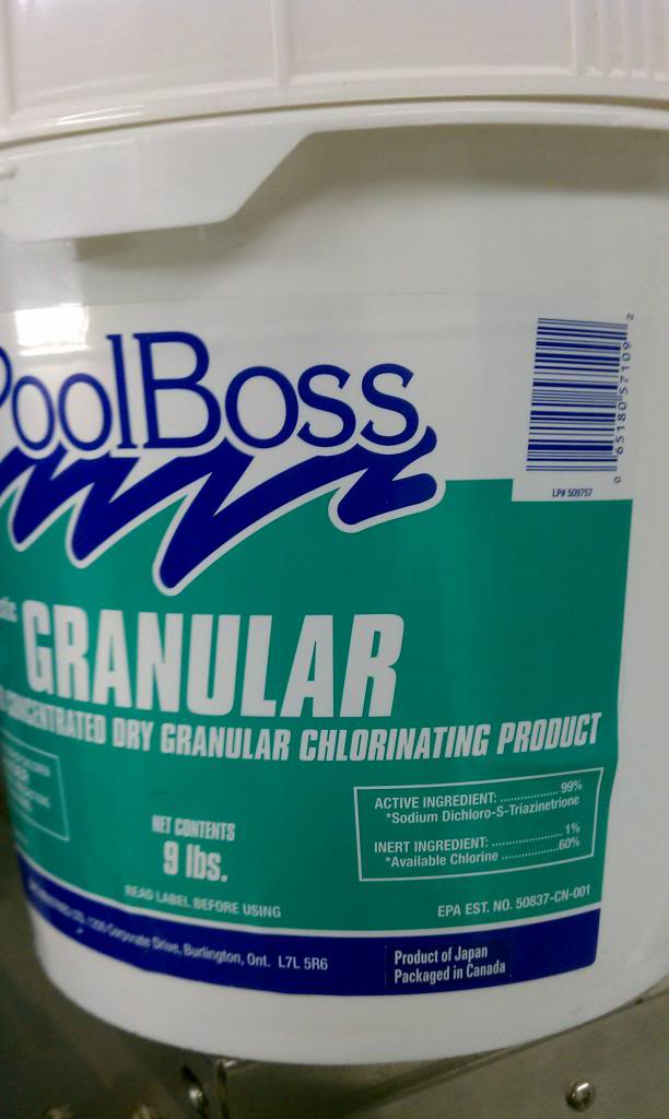

We use Sodium-Dichlor, as do a number of Centrum Force® wash tub owners. A cup or two for 1200 gallons of water. Tests have proved that this is sufficient for our intended purpose. We do not use it purposely to eradicate urine. We remove Urine by using another product. We saturate a rug with U-Turn chemistry, allow at least 30 minute dwell time, and then flush with water using our Centri-Maxx® horizontal centrifuge.
The reason we use granular Sodium-Dichlor in the wash tub has an obvious two fold objective.
1: It provides a barrier of protection in the water to prevent cross contamination of unwanted bacteria while rugs swim together in the tub during a wash cycle.
2: While charging the water for sanitation is accomplished, its properties help in neutralizing floating fugitive dyes releasing from rugs.
This begs another question: What other additive is put into the same water to help manage dye loose in the water from bleeding rugs? Only Wash Tub owners know that "Secret Sauce."
Here is one product we have used:
You can get something like it where pool and spa supplies are sold.

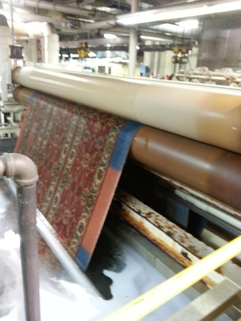

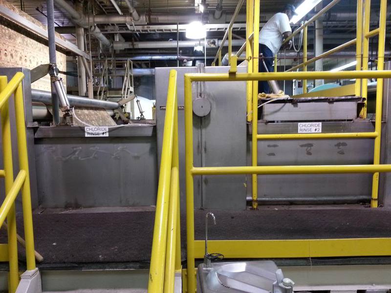

It is apparent that trained professionals have used various forms of chlorine in dilution for years in various laundry settings. Here is just one example I found fascinating recently for its use on wool:
The Great Oz
5,295
bryan
If you're going to use chlorine in your wash pit, you'd better know the safe dilution and dwell times, and have a process for treating the rugs when they come out of your pit. Karastan is purposely altering the look and feel of the wool with their process.
