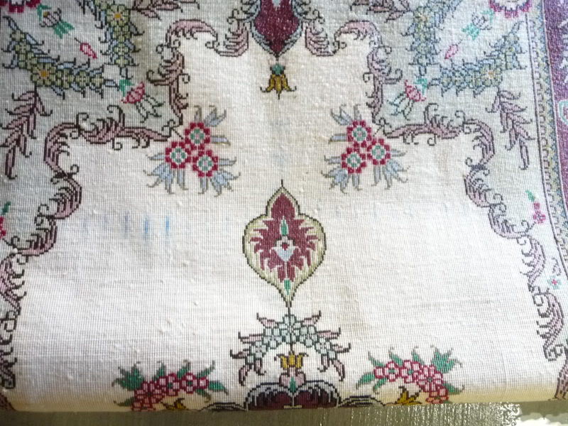

Small Silky has mystery blue line pop up on it's back after I got it wet with just water.

Did you test for color fastness. Either way i would dry clean a silk rug.

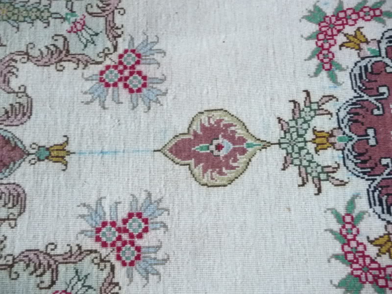

That my rug friend is a stencil mark that has bled through. Generally you find these on tufted rugs or hooked rugs to plot out the design. However, in this case it seems the weaver marked off the warps for easy ID when weaving. No way in this given world could you have known it was going to be there. And Lance, silk rug wash up just fine, as long as they are color fast and groomed properly to eliminate any texture damage afterwards.

trying to remove my cause more damage. If you cant see them on top then explain it was from the factory like that and no harm done.
And yes if they test fine for color fastness then wet clean would work great, But the dry clean would have avoided this and you can charge more for dry cleaning.
For future refferance bridgepoint has a chemical to help avoid this whene wet cleaning rugs and sofas.GL....

rub a little fels naptha soap into those bleed marks and extract with your enclosed jet PMF upholstery tool. Fels Naptha will take stains out on silk that nothing else can touch without damage.
