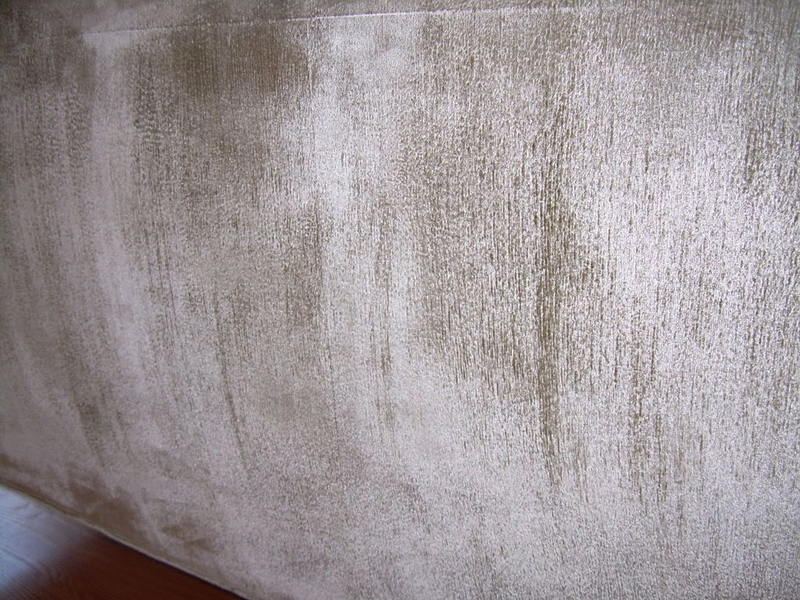

Removing tool marks from velvet
Terry
May 18, 2007
575
Terry O'Brien
upholstery cleaning marks (pattern of upholstery tool)
I've pictures and am going to upload if possible
Thanks,
Terry
K
Ken Snow
Re: Will a steamer and velvet or carding brush get the
Yes, if fabric is still damp when brushing. If this is a problem you are trying to correct, wet it down first.

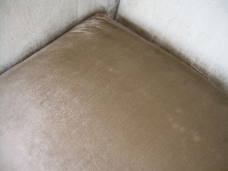

spent 51/2 hours yesterday with steamer and carding brush and bare hand in the edges. Its a 6,ooo dollar couch and customer was pleased with outcome but wanted to wait till today for final outcome, even though it was dry when leaving.
The velvet brush was too course, carding brush ok but had to be lighthanded.
Any of you know where a narrow version of the carding brush can be got, something of the style of the velvet brush but with the softer thinner bristles. Getting in the corners and edges.
One thing i've learned from this is not having all your brushes in van at all times is costly.
Lee, you mentioned gloved hand, do you mean Latex or an another type?
