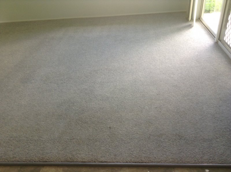

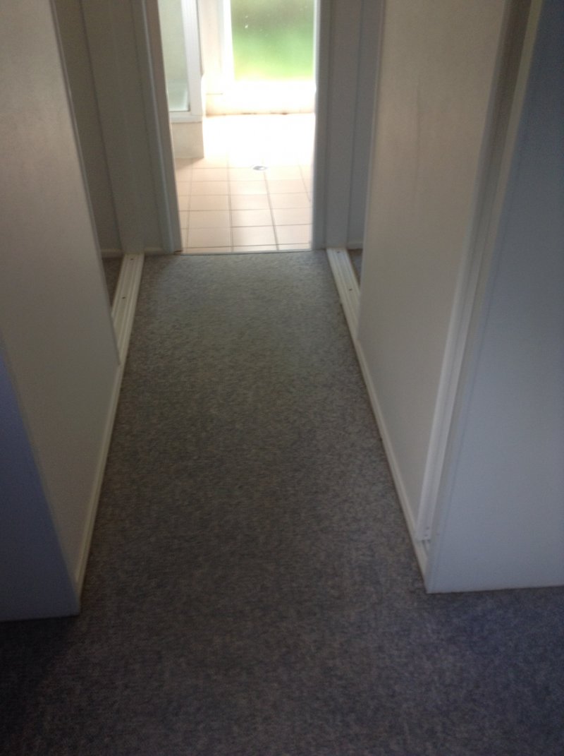

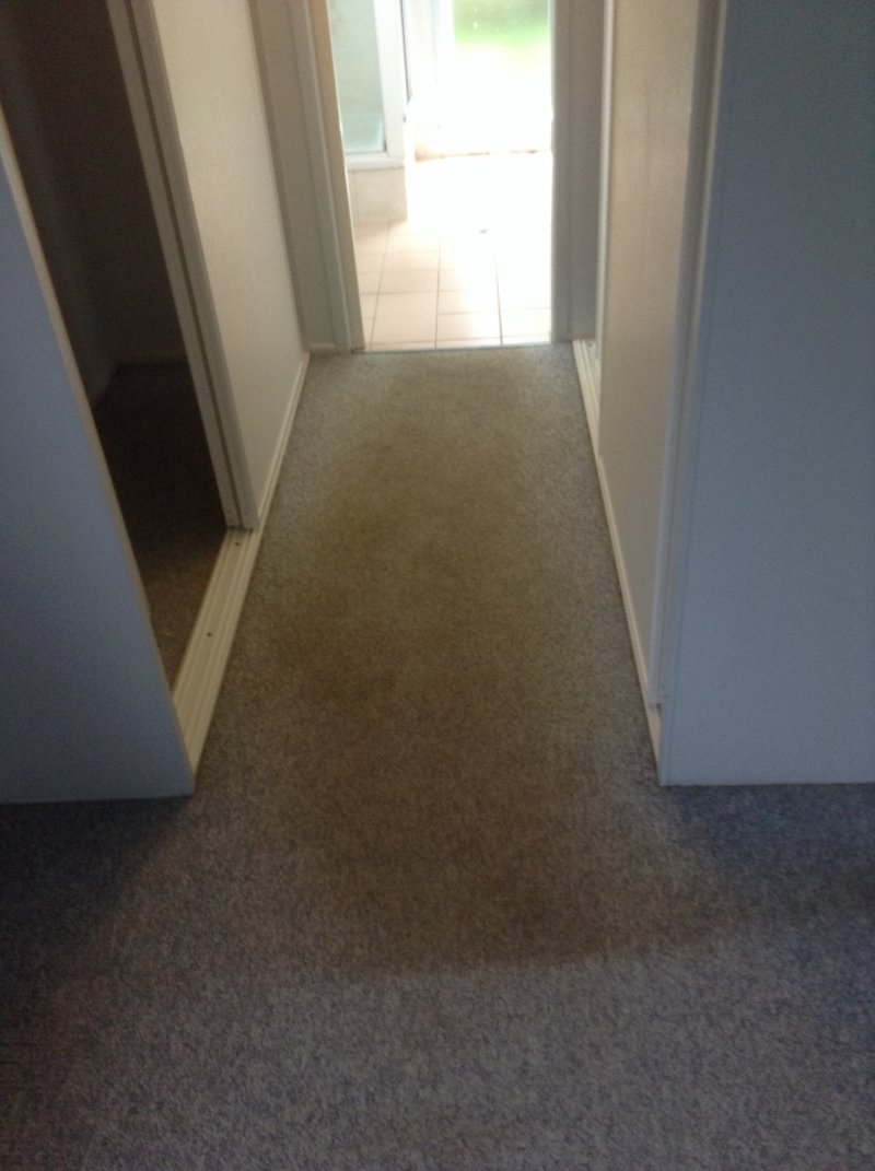

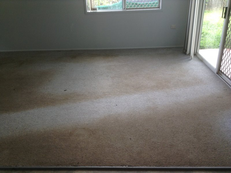

Sky, the majority of my work is Commercial with a Cimex.
This was a feral house where several cc'ers; told the agent to replace as it would never respond.
Usually, I price myself out of this marketplace.
Most of my day work in residential is upholstery or leather now, so I can't honestly comment on "3 houses per day time" as it's been sometime since I serviced that market.
Back then, I was using a small truck-mount as my favourite option.
IF I was, I would be using a different extraction machine, & most probably, (as others have said), with a CRB, but unsure as to what, because I'm not really interested anymore in that marketplace.
This house was 4 bedrooms + lounge/dining & took less than 3 hours from arrival to go for AU$730.00
Most residential carpets I would use my Sprayborg, but this needed to be agitated & rotary extracted.
Not much help I'm afraid.
