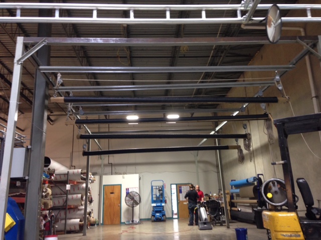

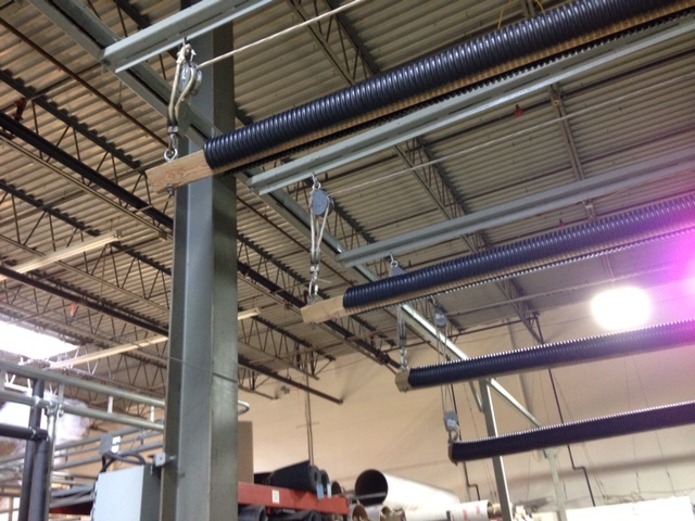

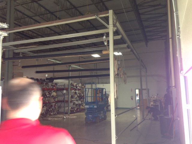

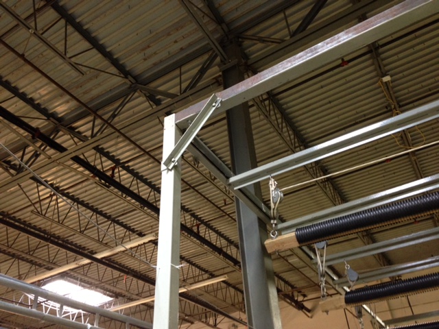

This system is commonly used in the Rug Cleaning Industry:

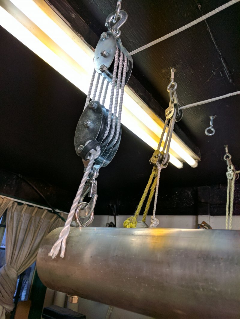

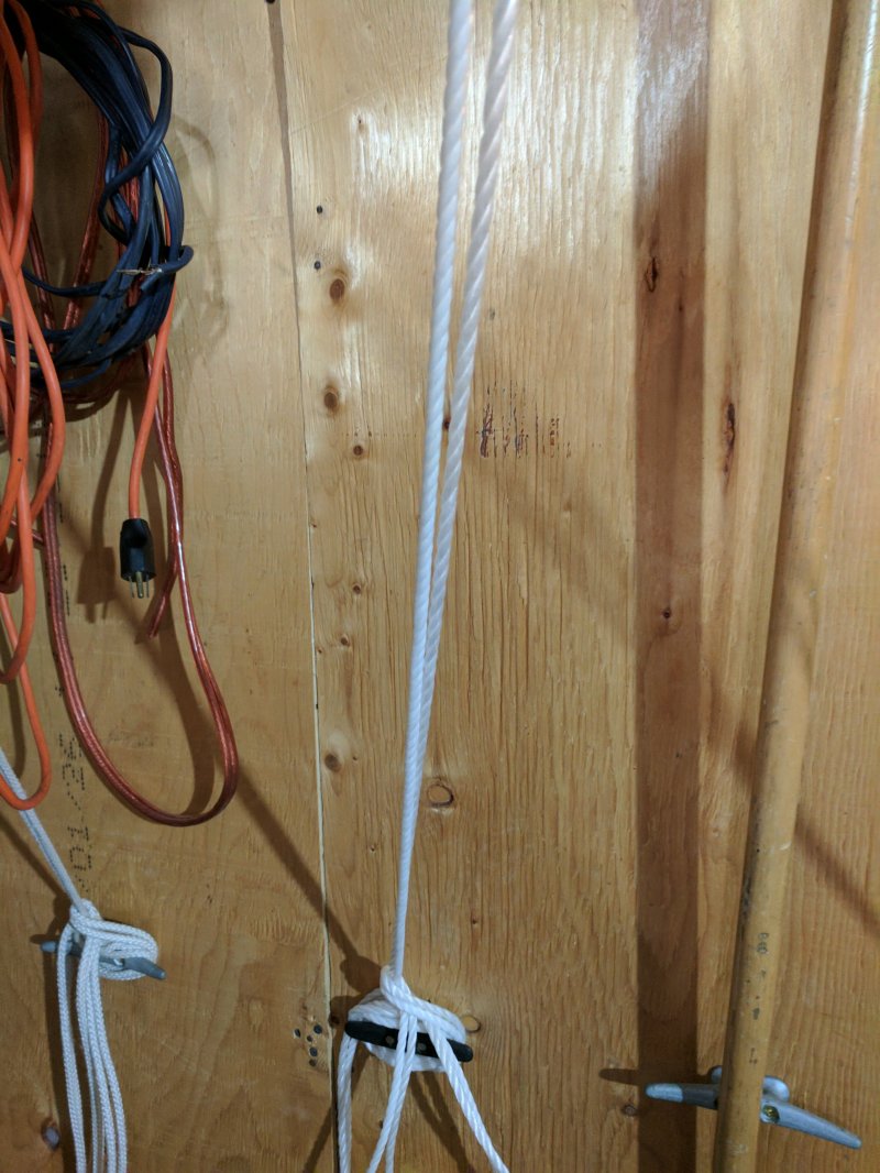

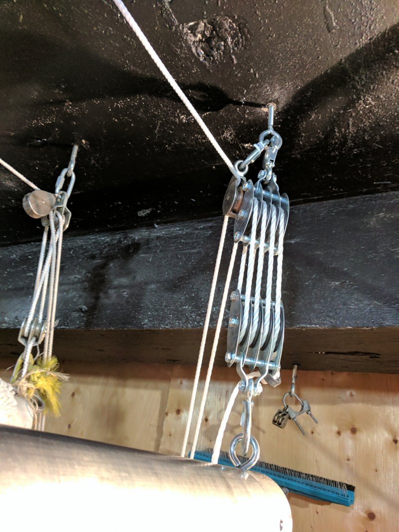

Are you using 1 single rope for all pulleys Tom? On my system I use 1 complete block and tackle on each end of the pole. I run the rope from one end through a loose pulley and pair with the second set, so that when raising or lowering the pole, I am pulling on 2 ropes, one for each set of pulleys. Your looks like it might be simpler.
28,263
Here a few pics of what I am using. It works well but if you have any suggestions, I would appreciate it.

The rope, block and tackle is not mine. Cunningham's RugCleaning.net
