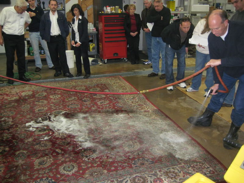

Terry - thanks for the pee video. So, fels comes in simple bars, are you using it only on the urine areas or is that how you are washing that entire rug? It just seems a bit tough not using a mix. Sorry for all the questions, I've just only used it on certain spots/stains, not a large area.
Danial - great video. There actually is a rug plant in my town where they use a fire house to wash their rugs. It can be effective, just need to be careful on some. Some plants use pressure washers, but one of my rug pals had to put "training wheels" with his to make sure his guys did not get too close and etch the fibers, which happens on a Chinese rug.

All rugs can be etched and ruined with to much preasure, not just Chinese. If I had to put training wheels on anything I think I'd just retrain someone else or have that person pushing a broom. I was going to say they could cut underlayment but you can't put wheels on a razor blade can you.
