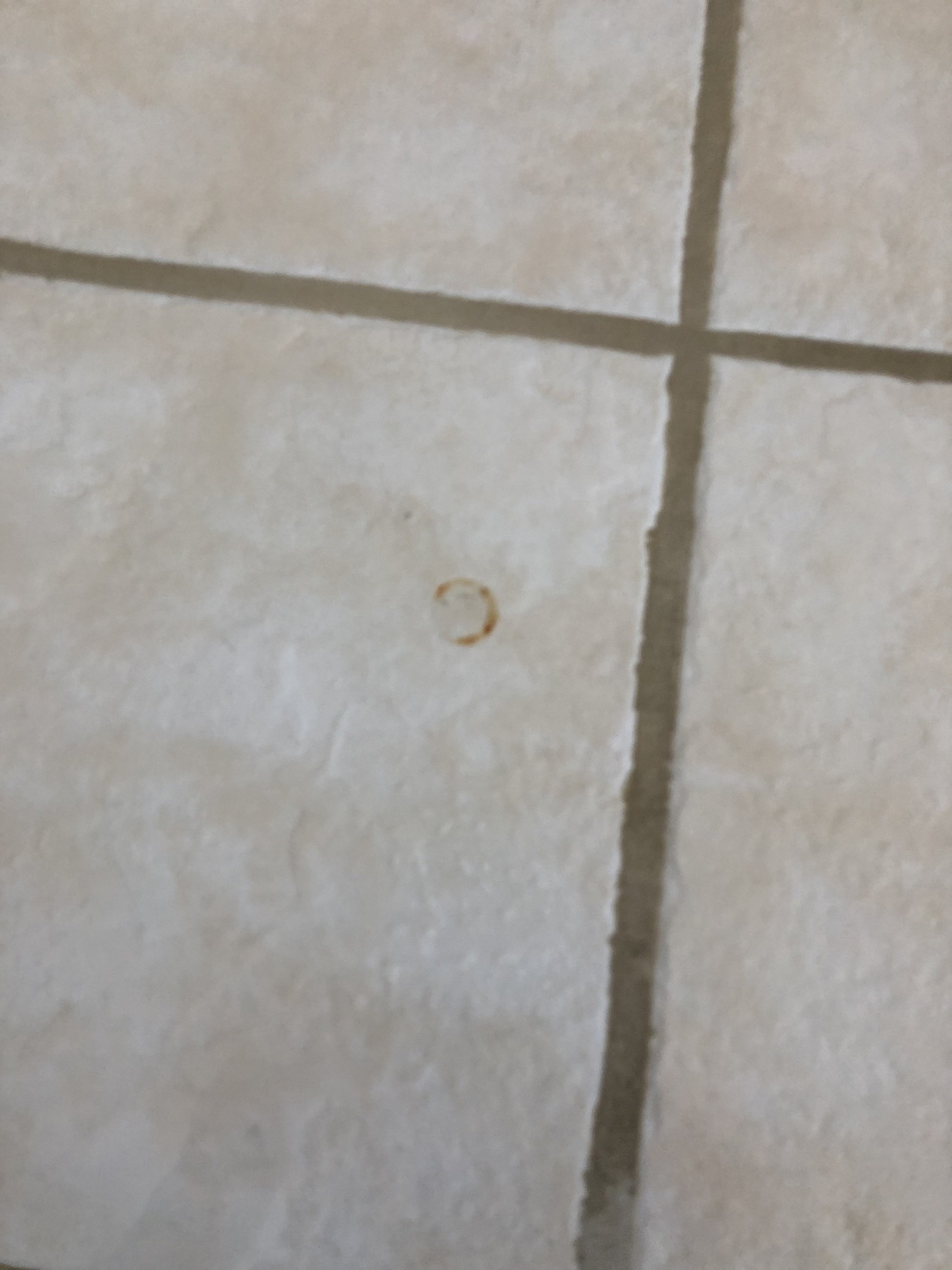

What is your method for removing rust without damaging tile?
Condog
Sep 24, 2019
437
Tony
steve_64
Aug 11, 2012
13,372
Test Wink or a mellower rust remover in a corner, most porcelain should be fine
I'm on a barkeepers kick.
Been using it on glass and fiberglass too. Cleaned the grease off my hands that the orange stuff didn't touch.
The acylic acid is a good rust remover. Same thing as wood bleach I think.
I got a set of pads for my impact drill to do tubs with at a complex that has horrible water.. We use it on chrome to remove water spots and rust.
Condog
Sep 24, 2019
437
Tony
It was a 33 cent per square foot job. He didn't expect perfection, I will get some samples from home depot and rust them and practice on them, unless I get another chance to test your advice before that.
This is the quickest method to clean tile. Set up and tear down is longer, doing the work is light years faster. For something like a small bathroom area I'll do the Trinity where set up and takedown is a lot quicker, otherwise it's the Turboforce.
Thanks for the advice, you guys are great.
It was my first job with the Turboforce, so I did it as a practice run.
