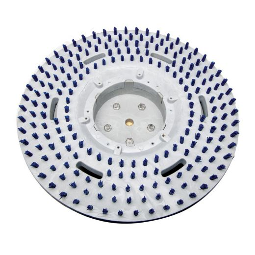

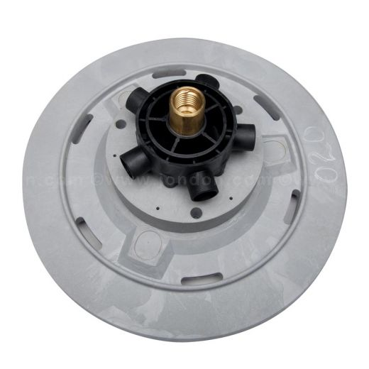

Any body have experience using their RX20 with the pad driver head? Any feedback? Mainly look at using it as a bonnet tool for excess moisture drying on CGD after HWE. Not really looking at for encapping because I have a Cimex already.

I have one. It will work.
It will spin faster then a 175 but it works
10,258
Yes I have the whole 9 yards. The down side is it’s 15”. But it fits in the van real well with other crap.

Is faster rpm the a 175 a big deal if you just do it quick / small amount of time? Example may be some bonnet extra moisture drying in "chair" areas of empty office space that needed some extra cleaning effort. I would guess the down side of faster is don't leave it on area of carpet to long because it may friction burn or damage the fiber in some way?

Get a 175. Your RX is too expensive to wear it out doing a cheap tool's job.

Thinking about making a pad driver you can just drop the rx-20 on top of with out changing heads. Something that cradles the vac slots tightly and is low profile. mostly for agitation not encap.
