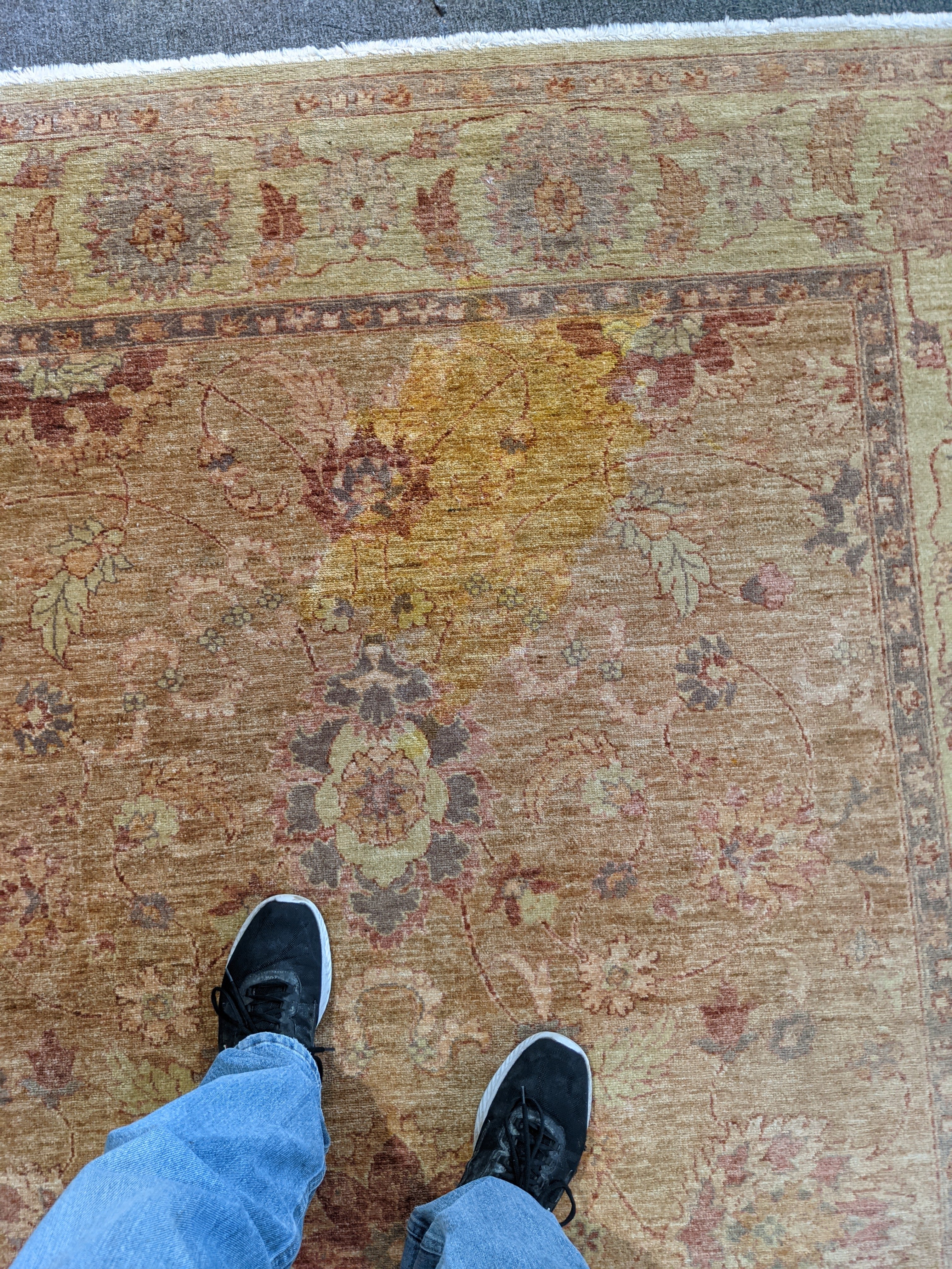

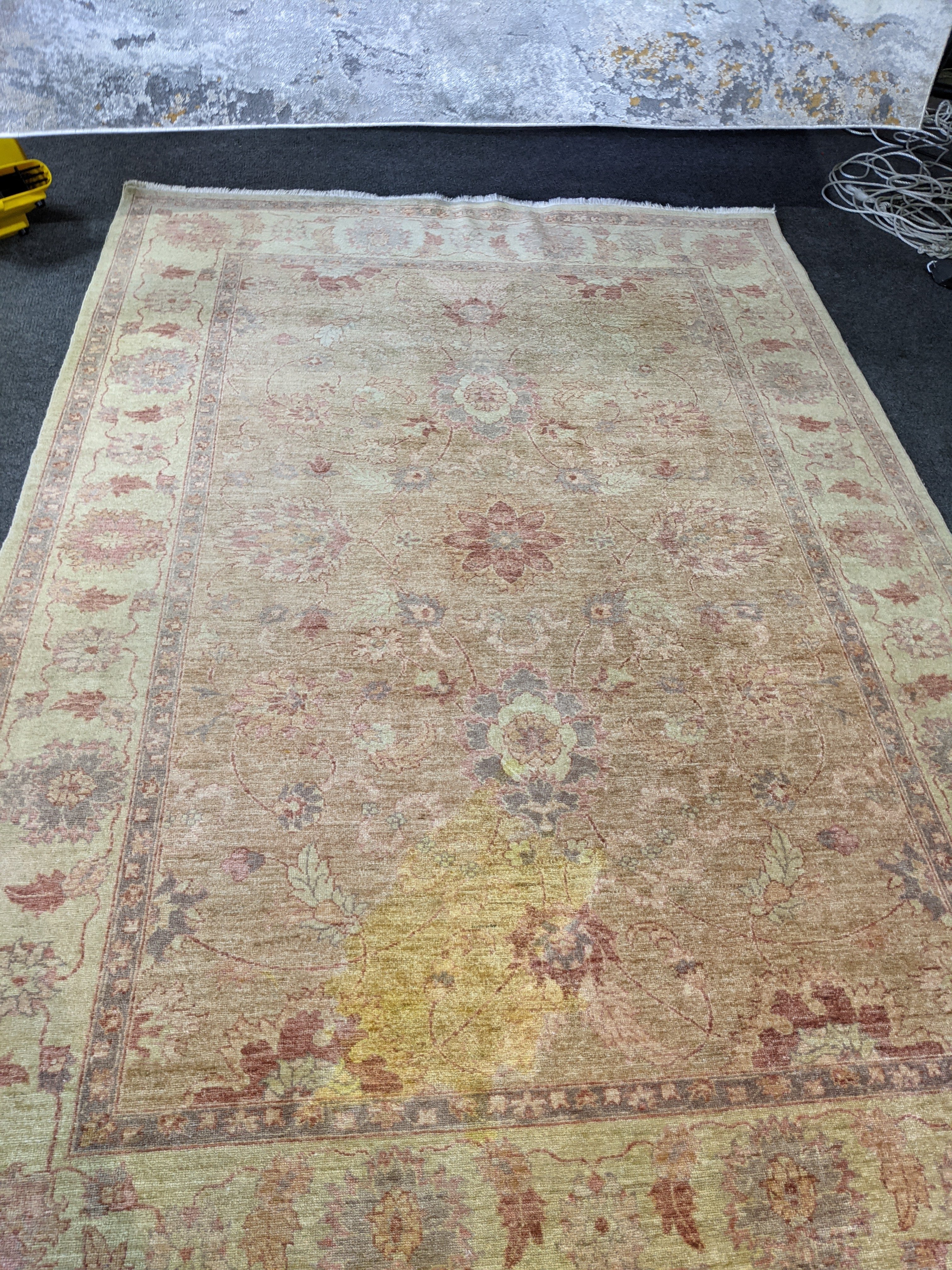

Here is a rug that the customer spilled a cup of saffron tea on. Any suggestions?

Brew up a couple of pails of saffron tea and soak the rug down. I'll hook up with you tomorrow and you can give the UV light a shot.
12,834
What is the fiber type? Has it been cleaned yet?
Avoid an acid based tannin spotter. I've seen it turn the yellow to red.
I have an idea of what to suggest, but would rather have some history before I say.
28,263

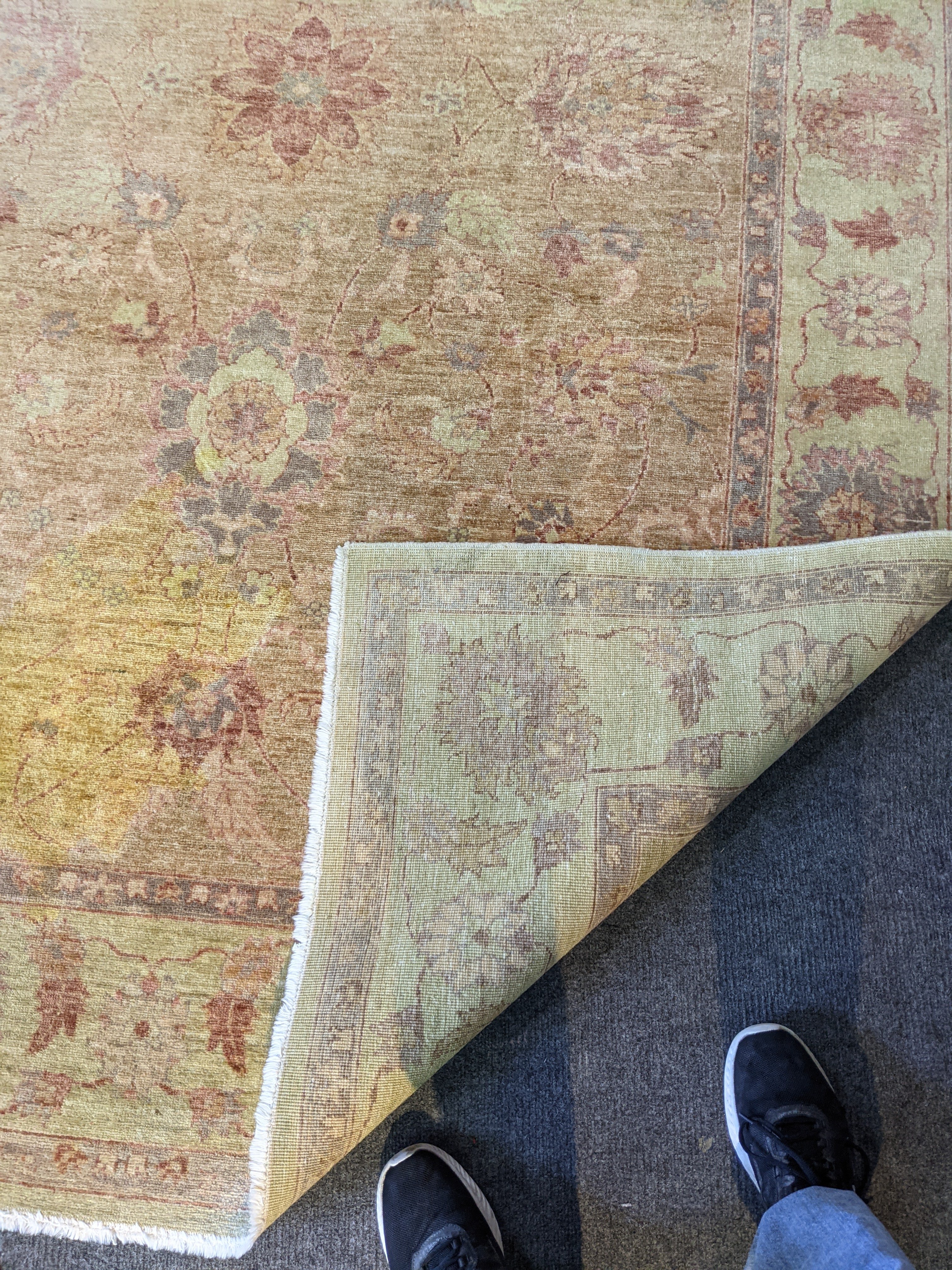

I got some good advice from the Chemmax people last night. After looking at the pictures, they determined that it is a Pakistani Chobi rug and most likely has been "tea dyed". The spill and customer cleaning attempts have likely impacted the overdye and even removing the yellow stain, if possible will still leave a discoloration. I think I will just return it to the customer and let them know that there are no affordable options. By the time someone tries to remove the stain and color it back, it will cost about the same as replacement it seems.
DAT
Apr 3, 2017
6,487
Bill Cheryl
Make more saffron tea and match it with rest of rug
The Great Oz
5,295
bryan
Try cleaning it.
We just cleaned one like that. Cleaning removed 95% of the stain, nothing would remove the rest without affecting the color of the rug fiber.
Oh yeah, we removed most of the "antique" wash as well.
Papa John
Lifetime Supportive Member
Aug 19, 2013
7,040
John Stewart
Stain Magic with UV Light. it might take a week to disappear.
but clean it first.
