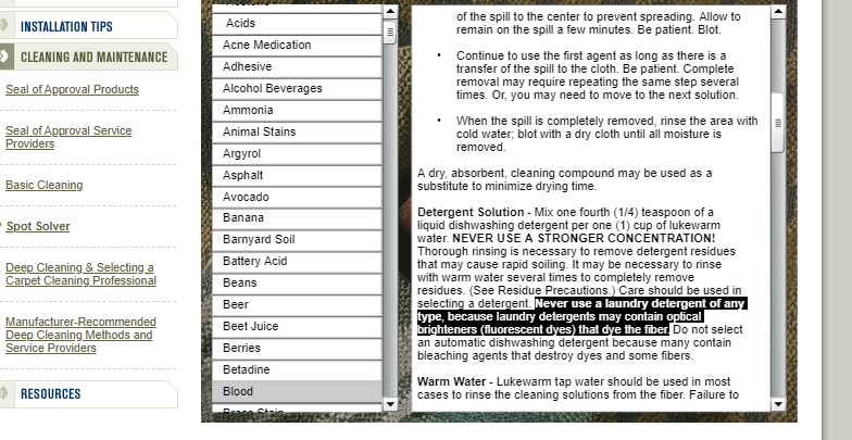

DETERGENT SOLUTION • Mix one teaspoon of clear hand dishwashing liquid or detergent powder (should NOT contain any bleaches or strong alkalies) with one cup warm (not hot) water. • Apply as described in above steps. • Rinse well.
The old CRI guide. I have the swf file but haven't converted it to html5. You can still see it on the wayback machine with a browser that supports flash.

Detergent Solution - Mix one fourth (1/4) teaspoon of a liquid dishwashing detergent per one (1) cup of lukewarm water. NEVER USE A STRONGER CONCENTRATION! Thorough rinsing is necessary to remove detergent residues that may cause rapid soiling. It may be necessary to rinse with warm water several times to completely remove residues. (See Residue Precautions.) Care should be used in selecting a detergent. Never use a laundry detergent of any type, because laundry detergents may contain optical brighteners (fluorescent dyes) that dye the fiber. Do not select an automatic dishwashing detergent because many contain bleaching agents that destroy dyes and some fibers.
