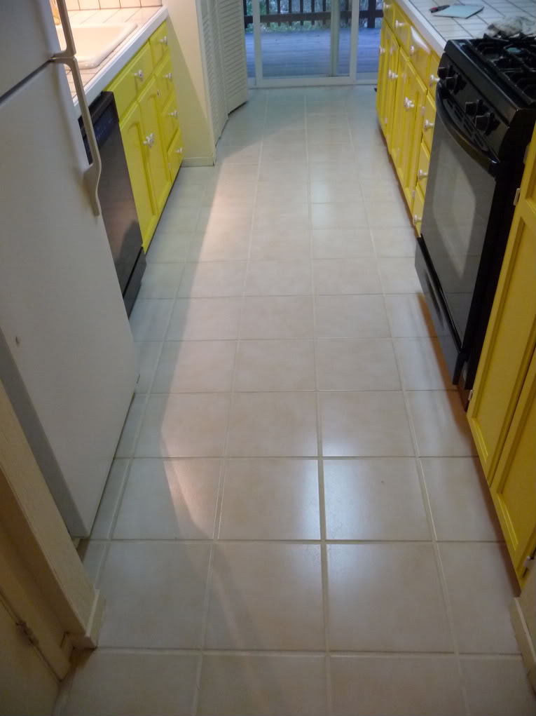

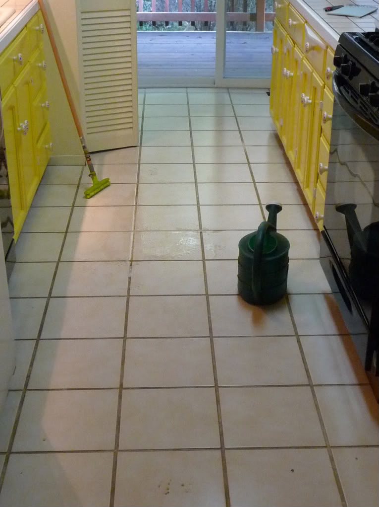

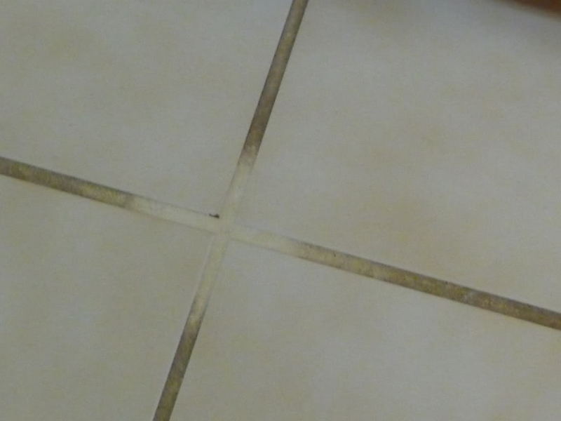

Yet watch this thing clean..
Test area from when we cleaned the carpet a week before..
Before rinsing
After..

Pretty dramatic results. Would you mind explaining your procedure on that job?
