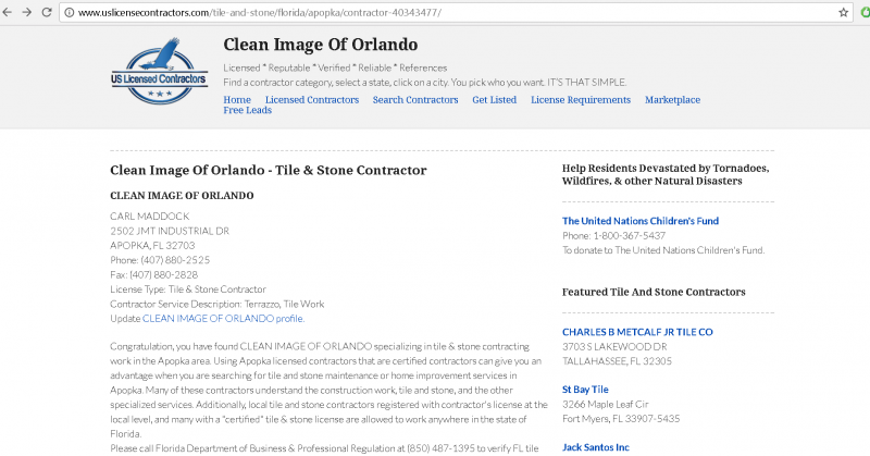

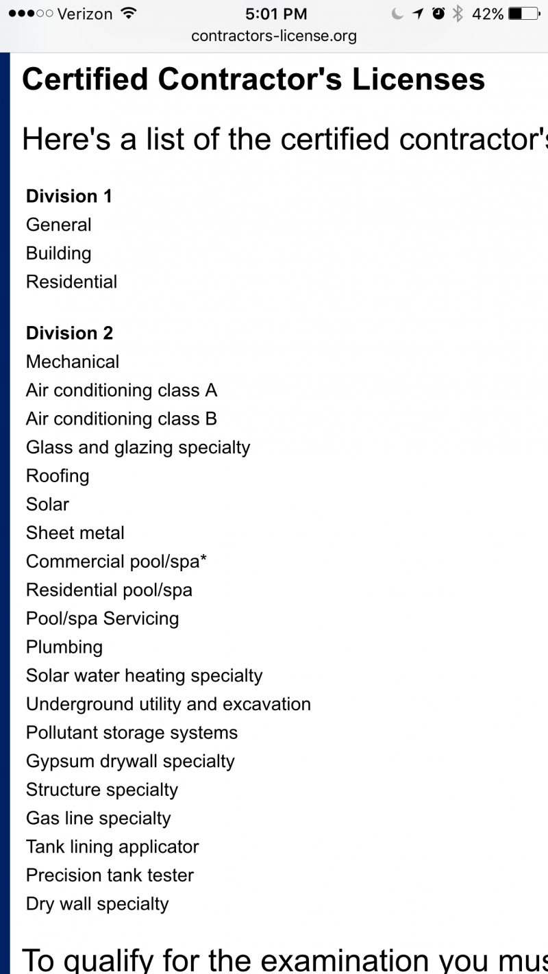

Why Florida doesn't require a license to install tile is beyond me. So does that mean any Joe off the street can simply open a tile installation business? That doesn't fly here over in California, anyone caught working without a contractor's license is fined, no warnings.
What's also interesting is how your business listing has you as "
Clean Image Of Orlando - Tile & Stone Contractor".
I would post a link but this is my 24thth post and apparently this board requires 25 before posting links. you can see the link in the pic.

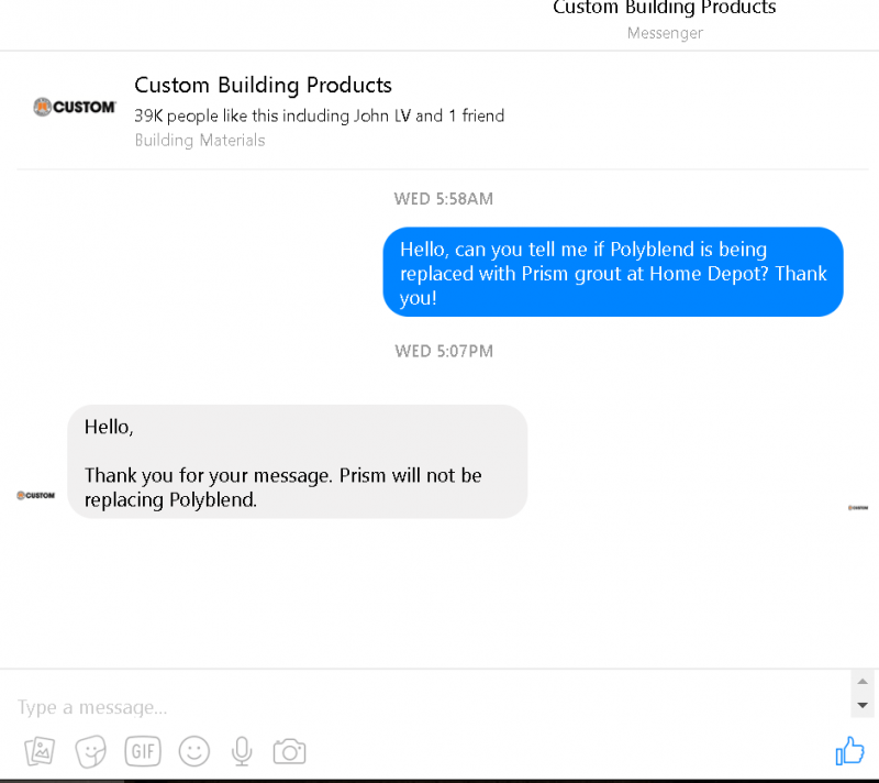

problem is that I know where this guy is going on this issue. I've dealt with it on other forums. He's posting information that is not true. Polyblend grout is available at Home Depots.
There's no intention of replacing it with Prism grout. I messaged Custom Building Product directly through facebook messenger where they confirmed what I have been saying.

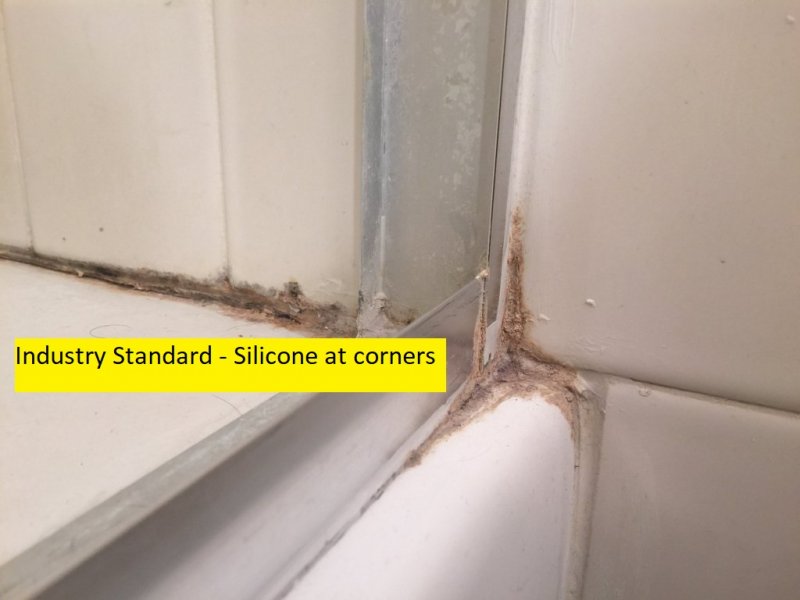

Here is the problem Jason, as a contractor, my concerns are your epoxy trapping water behind the tile. Or Any near waterproof “sealant” for that matter.
Whether it due to Florida shower construction, Florida hard water or other factors, cutting to remove perimeter caulk and having water flow out, and often 30 minutes latter it still flowing, tells me there is water in the wall cavity. This is why caulk mildews in first place. Now we’re going to replace the water proof silicone with your waterproof epoxy grout.
Do you not see the potential problems?
Impregnating sealers work well and have there place, however like you said, your not going to water proof the wall structure in a shower.
I find it kind of ignorant on your part to assume every shower is build like you build it.

In CA, it is required by code with a new installation to use a flexible joint material, such as siliconized acrylic caulk, silicone, or a urethane material where the plane changes. So where the floor meets the curb riser, seat, wall, etc., you must, by code, use a flexible material. Being on one of the largest fault lines on the planet, I see why this is the code.

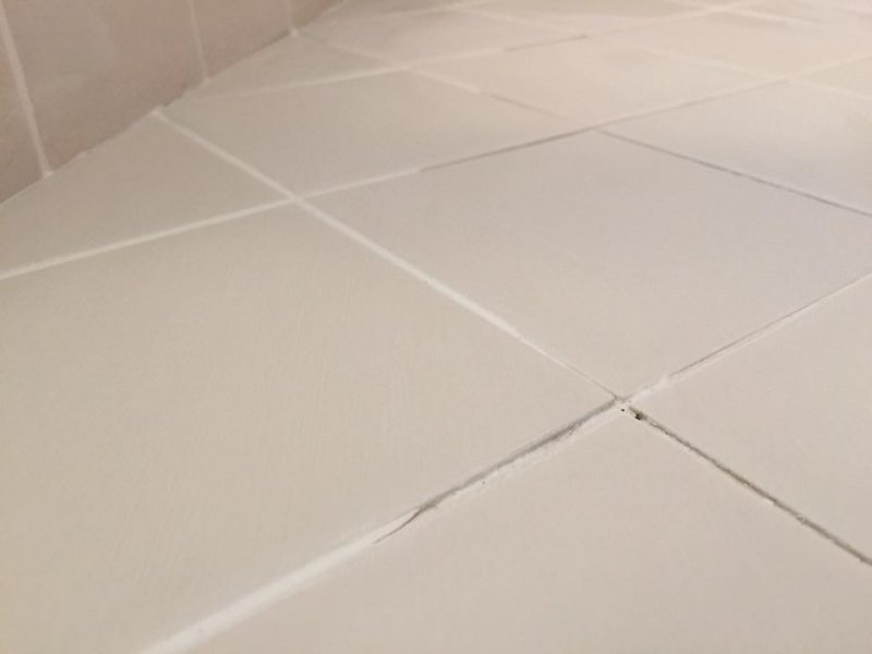

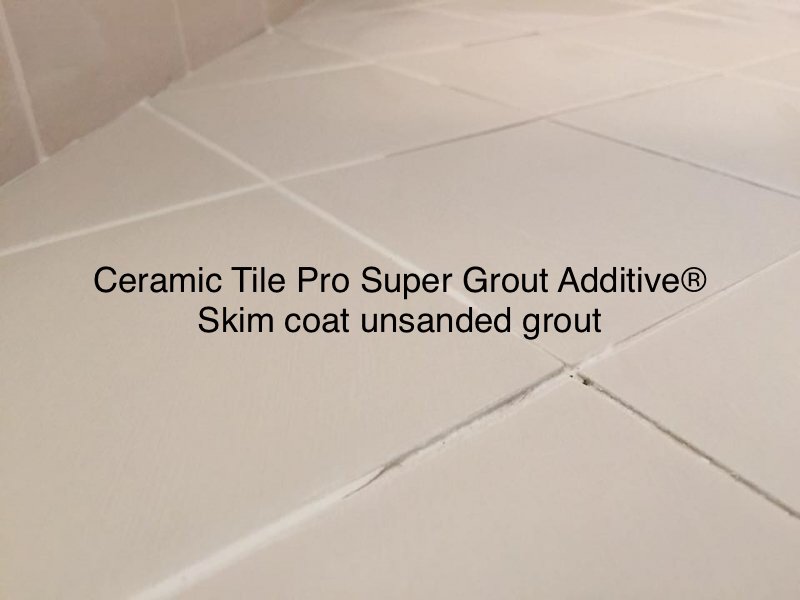

In my shower in my shop, the one that is used for training, was installed about 14 months ago. It cracked in the corners and around the floor after about 4-6 months. Non-sanded grout in the vertical joints, sanded grout around the floor perimeter. It was replaced with SGA and so far it has held up just fine. Obviously, this is a short amount of time to use as a gauge of durability and lifespan.
Some of you know my experience, some do not. While I am not a tile installation expert, by far, I have a lot of experience with all the steps, from concrete slab and studs to finished product and the restoration and repair of showers after the fact. So far, I have been impressed with SGA and I have no issues recommending it. Yes I am a distributor, but as most of you know, we offer a limited selection of each type of product so we only offer what I would consider the "best of the best."
SGA isn't for everyone. Some people will not agree with it's use, some people will love it and use it exclusively. Some people will use it sometimes. It doesn't matter, every product has fans and people that don't like it.
One of the HUGE benefits for me, is that it cures with a matte finish, like grout. It does not cure shiny like silicone or urethane. It is very strong. With a utility knife, you can cut out non-sanded grout. You cannot to the same with SGA mixed with the same non sanded grout.
Also, it cleans up with water. It's not as simple as wiping once or twice with a sponge, but the fact that it is water clean up is amazing.
One more thing, it doesn't alter the grout's color that much. It ends up a tad darker, but not so much that it's an issue.

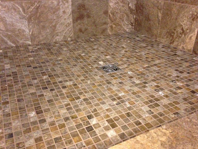

Jason, I'm intrigued enough with Super Grout Additive that I've ordered already, to use in new walk-in shower floor tile install over KBRS Tile Basin (over mortar base on solid 3/4" subfloor). My question is, how do I apply SGA (mixed per your videos with Mapei unsanded grout) into gaps for pebble tile on floor, mainly because of the variable width of gaps, which can exceed 1/8"? Do I simply allow more cure time, or should I apply in multiple steps (deeper application first, allowing to cure between second app)? I'm just concerned that the extra thickness/width of material will have difficulty curing properly.
Thanks in advance for any advice
