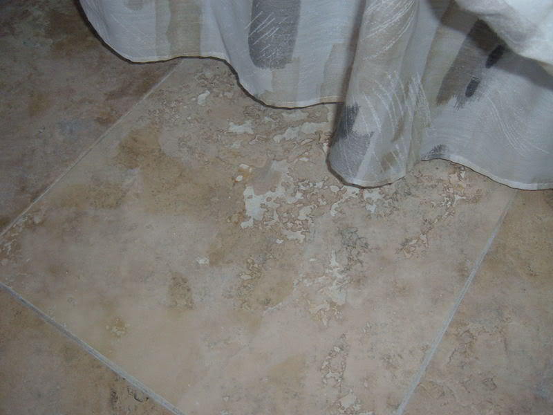

A friend of mine is having problems with a traventine floor at a house he has listed for sale. Below are some images, any help would be appreciated!

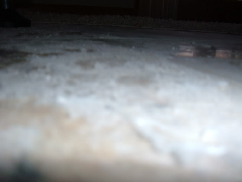

I don't have any other facts unfortunatley. The last photo is looking across at floor level. There are "fuzzies" all over the floor. The customer says you can sweep them up and they just come back.

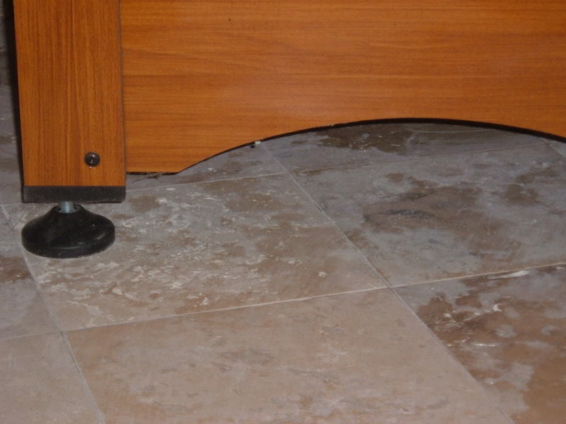

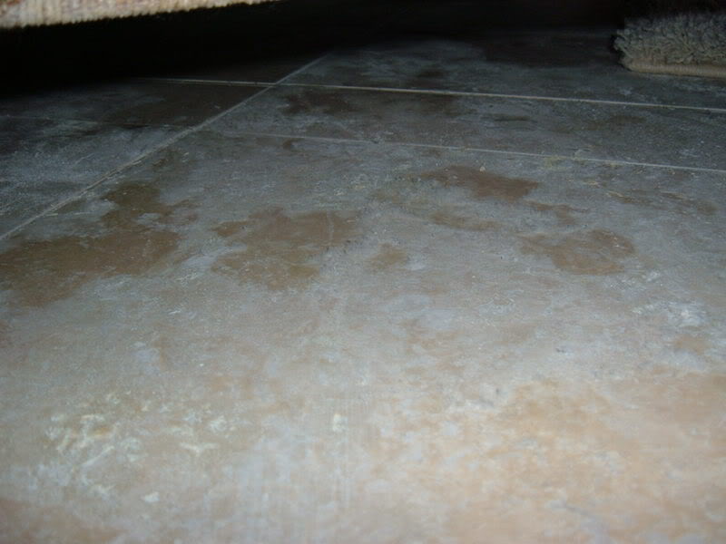

From the pictures it’s very hard to see/tell what’s going on for me. For instance in the first picture (under that piece of furniture) the “pattern” appears to go across from one tile, across a grout line and is continued onto the next tile. If that’s the case to me it would indicate that something has gone from the top down, as in being spilled or poured onto the floor – like being improperly cleaned; most often with vinegar, TSP (Grout Haze Remover) or some other acid. Vapor migration won’t normally come up through two different tiles in one continuous pattern like that. As to pattern, the same thing goes with pictures 2, 3 & 4; what ever is going on is doing it across almost the entire tile with only a few small places if at all where the tile looks normal. How long has this tile been down and has it always had this appearance? If the floor always looked like this from day one or very shortly there after I’d say someone tried to remove grout haze as if they were trying take it off of ceramic tile and etched the stone.

David, What are the fuzzies??? It almost looks like a growth of some sort.

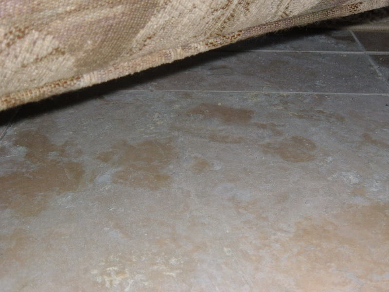

For the fuzzies, do you mean like in pictures 4 & 5 where it looks almost three dimensional? I simply have never seen anything like that before. Like you said, with the info we have and not being able to see and touch it in person it makes it hard to know exactly what’s going on. I would be curious about what he finds if he does the moister test though?
