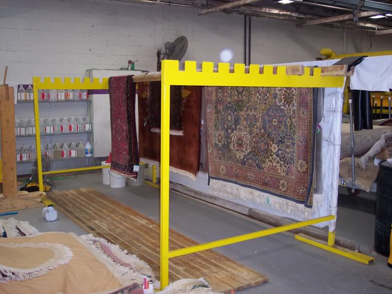

Here is one of our set ups that we built to hang rugs after fringe treatment, post washing. Rounded edges on the wood allow the rugs to slide off easy and don't require the use of round plastic hose that can cause rugs to roll off. We have 5 of these of various sizes, the largest of which is 12 ft wide, 7ft tall and has 12 poles.

After you hang the rugs over the 2x4 when they dry do you have to stretch them to get the hump out from hanging like that?

The ladder idea is interesting, but remember almost everything we hang is dry except for the fringe that is just damp. The wet rugs are in our 2nd story dry room on the automated hoist.
The heaviest rugs we hang on our tallest rack are 9 X 12, which when dry range from 50-120 lbs and we always use 2 people for large ones. the vast majority are 5 X 7 amd smaller so no problem for 1. Tthe pole is hung forist in front, filled up with rugs then shifted to the rear.
Because they are dry they do not get humps in them.
Ken

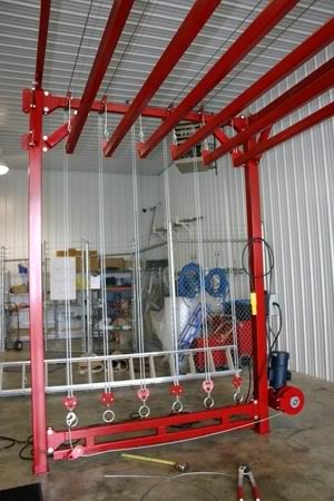

My own rug tower is much more modest but has an electric motor ( yellow - halfway down ) so that we can lift sopping wet rugs out of a submersion pit.
BTW we use 6" diameter drainage piping around the beams and so do not get any "humps or bumps" on our rugs.

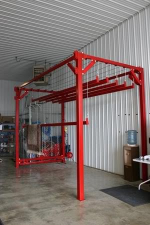

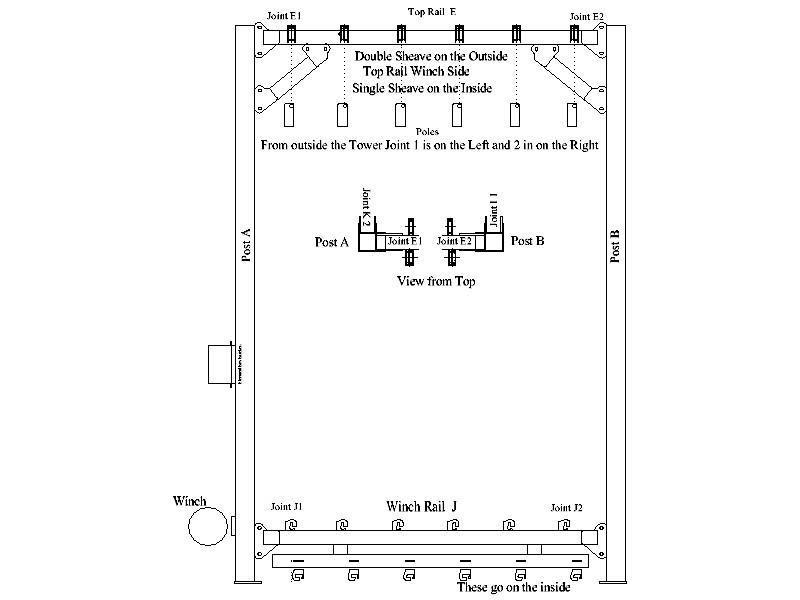

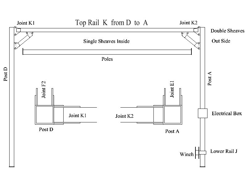

This is our 6 pole unit. It can be expanded to 26 poles. And can go over a pit.

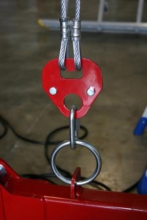

Looks are probably deceiving but those links look awfully weak. You can use bigger links, can't you?
Scott
Clark
Feb 6, 2007
226
2200 pounds is the design weight for each side and 4400 pounds for each pole. Actual shear strenght is 3600 per cable. The weak link is the ring. All other parts will go to 7500 pounds each side. The cable is 1/4" 7x19. A 20 x 13 chinese full of water is 1000 pounds. 6000 pounds is not a real load for this tower.

The 6x13x10 Tower is $5300.00. This is with a 2000 pound winch as shown in the photo. Two men can install it. The EZ Tower is more mobil and storable the cost starts at $1495.00.

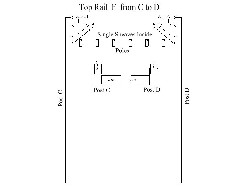

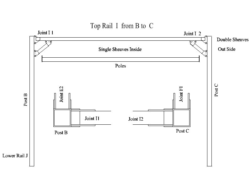

A forklift makes it very easy. We stand them up with 3 people every day. I have done it with 2. You put it together on the floor and stand up one side at a time. I can put one together with 2 other people in 2 hours. I just completed new assembly drawing. I will post them later.
Check www.rugbadger.com under equipment and Towers
