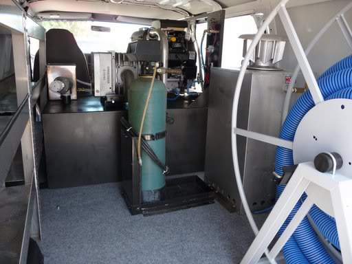

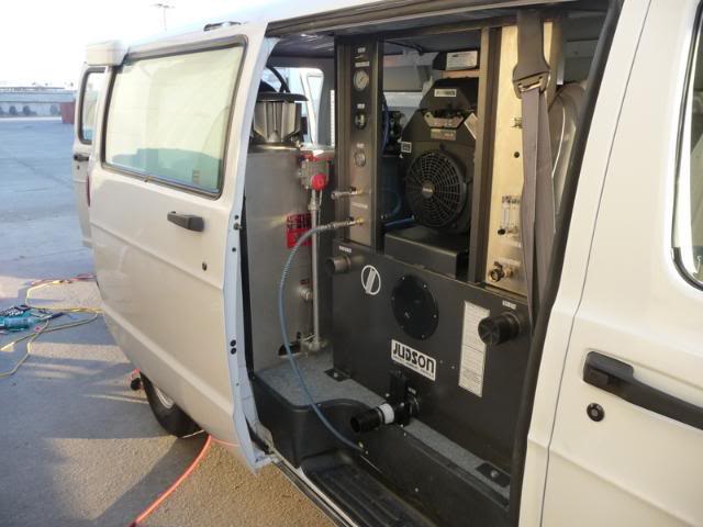

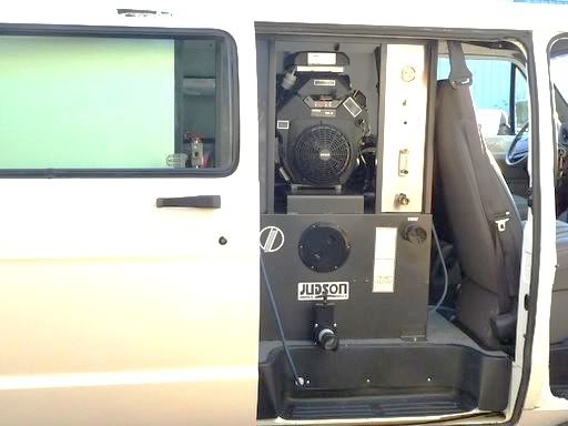

Why the belt instead of direct coupling to blower? Is it to get the blower speed higher? No belt slippage?
I thought the look of the front panel was nicely balanced.
I like the large waste tank. How much of the 150 gallon tank is usable when full?
It would be interesting to see some more of the rules and the reasons for them.
Loren, We have been in the truckmount manufacturing business probably longer than anybody.
If you just knew how many of these direct drive couplings we have had to replace or reengineer the truckmount to eliminate them...I would say it is several hundred units. A belt drive is the only way to go as long as you don't use an idler pulley. Belts are also safer on the equipment because they are capable of slipping.
For instance, if you had a blower lock up, it would not destroy the engine from the sudden stop. Your question about the actual water capacity of the water tank: The tank shutoff is set to 125 - 130 gallons.
As far as my rules...they were developed through years of repairing competitors units and discovering what did not work on our own units. I appreciate your compliment on our unit. Thanks, Les.

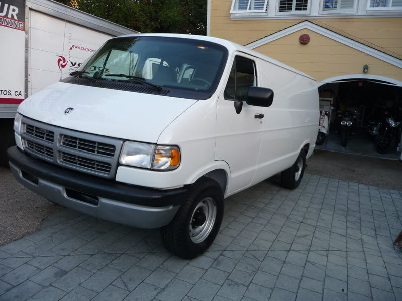

When do you think you guys will have it working and cleaning carpets?
Really looking forward to your reaction to how well it works.
Greenie
Sorry guys, I've had to do this stuff in between running my normal bidness, and you know how I am already, I was thankfull for Mikey's help. His install has been slow cause it's what I call a custom install, Mike has been spec'ng out as we go, and we've changed gears once or twice from the original plan when this thing was being welded and put together.
and...I stopped 2/3 the way through to do Another TNT install for a very good customer from San Diego who needs it by Sunday, Sorry Mikey, I stole your heater cause Little Giant didn't make it by noon on Friday, so now I'm putting that back in...lol
Should be good to go by Tue or so.
