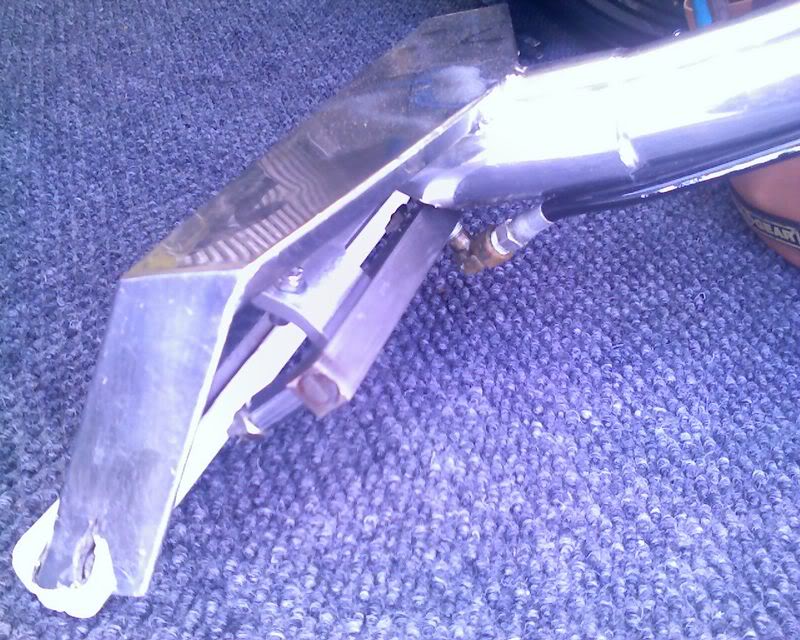

Just got to use the new wand again this afternoon. I just can't get over what a difference this thing makes on one pass only! We've been using a smaller overlap on strokes...Using over twice the flow as my old wand but still blowing steam. One thing I like about it is the jets closer to the carpet and the steam doesn't get a chance blow all over the room....Not quite so hot standing over the wand!
Greenie
JV since you have a HOT TM, you are now finally putting that heat to use, instead of bottling it up at the mount.
5 jets baby!
pretty comfy too.

Mikey/Greenie - can you please clarify where exactly the stream of water is striking? Is it hitting the glide or is it hitting the carpet just fractionally behind the glide? I don't understand how you get a shearing action if the stream is striking the glide first.
Cheers
117,255
Its 50/50....
or so.
If you use a multi jetted wand without a Glide, you'll get streaking on dirty carpets.
So..
You tweak the jets/manifolds up just enough to stop the streaking but still get a good rinse.
At 06 it works fine, at 012 it works killer!
