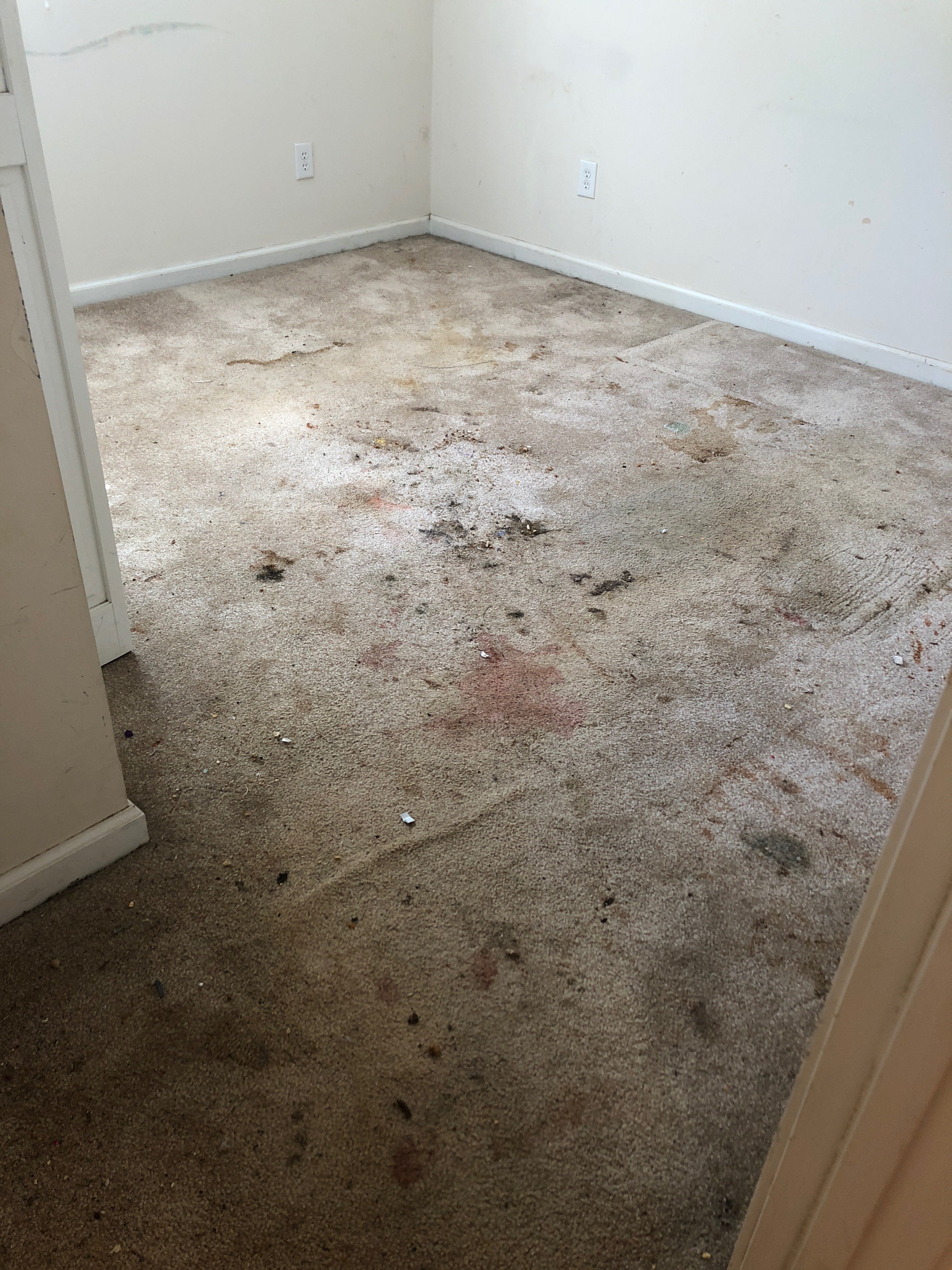

It’s not fecal blotches that the picture makes it look. It’s a combination of grease and chewbaccer. Mostly drink spills as well. I’ll have an after pic in a bit 🖕🏻

Now you’re calling me a liar which I don’t take lightly. There’s no evidence of a litter box in that room and the dark spot don’t smell like fecal matter
But to make your judgmental ass feel all bubbly inside🖕🏻, I offered to not charge them after I cleaned it because I told them it would come out more presentable than I expected since they’re selling the home
I cleaned a total of 9 areas of carpet and tile in this home and the seller was happy with my cleaning.
So hall-monitor Fred, did I do it better? Should I repent for my wicked evil ways of doing business?

I try not to disturb the funk in the pad by doing a strong pull back rinse with a heavy acid rinse over the dry carpet running through the wand before I treat the entire room with my HF.
I'm aware of the mess underneath and this is the best way not to get callbacks and the dry time is much faster

Yes I would after I cleaned it the way I did today. And I tell the customers all the time that sometimes I can’t make it look new but I can make it “barefoot status”

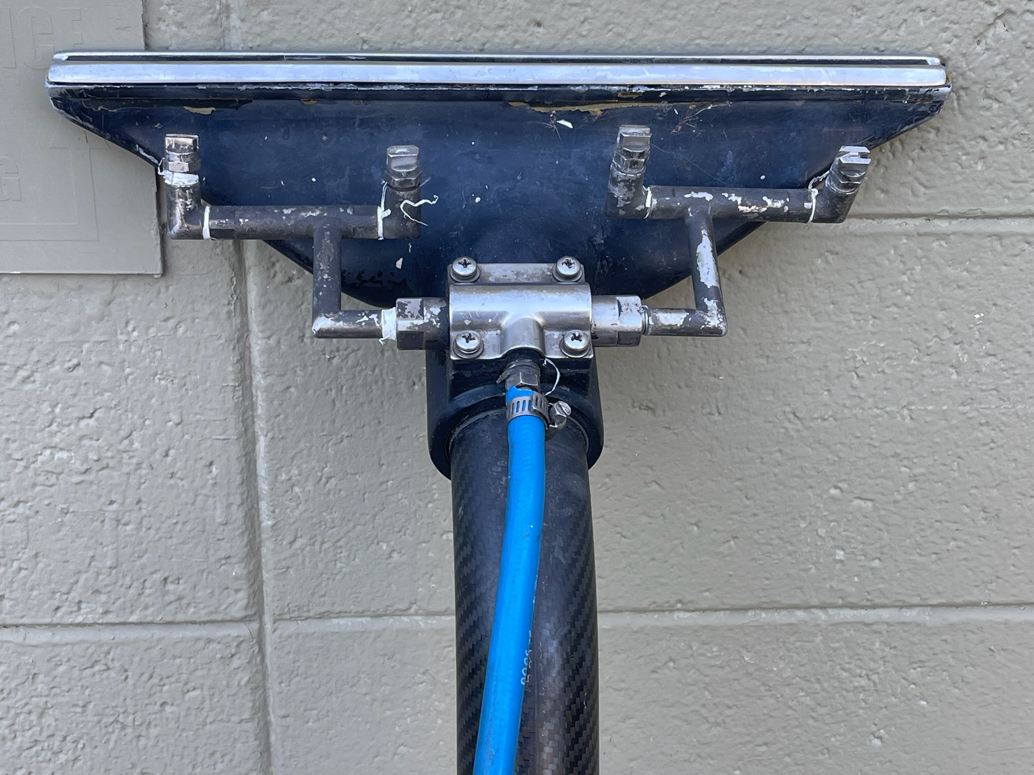

I'll have it on my site as soon as I have the new Glides for it.
29" Westpak S bend.
Flat Face Glide
Rejetted
Extender Benders
InLine strainer
Assist grip choice
$435 delivered.
Nice. Let me know when they are ready, I'll order one. Slowly I'm addressing the most ridiculous part of my operations one thing at a time. I want to relegate my hand tool that I've been cleaning stairs with to spotting asap 🙃

If the proper methods and chemistry is used to kill as much funk as possible with the process to get the carpet dryer faster to prevent any more bacterial growth, there’s nothing wrong with making the decision to clean it at the customer’s request
I’ve cleaned so much worse carpet that should’ve been thrown out over the last 21years I’ve been doing this and I’ve had ZERO calls on “my Timmy got sick a week after you cleaned” from any of my customers.

The main goal of cleaning carpet in that condition has two main points that need to be confirmed before you leave that residence
1. After the treatment of carpet and proper rinse agent is used, you need to make certain the water you recover smells as clean as the water that was used to flush it out. What do I Mean by that? Once you go over the concerned areas, pull the vac hose off your wand and smell the water inside your wand. If it smells like funk, keep rinsing until that water smells clean. That tells you there's no more funk on the exposed carpet
2. With all the flushing and SEVERAL dry passes, a fan needs to be put on that carpet to speed up the drying process to prevent any heavy wicking
I don't care what the attorney wannabe Fred says. This cleaning process is so much better than just leaving it for the customer to handle, whether it be them pulling that carpet up funky to expose them to the hazardous funk or even the customer going out and renting a rugDR to make the situation really biohazardous
Hell, in the past I was asked to clean a carpet after a landlord kicked out a HOARDER just so they wouldn't feel dirty pulling up the carpet to replace it, which I did clean it.
You'll run into several of these situation in the near future, so feel free to make the judgements for yourself. Just remember that what your goal of what condition the carpet needs to be might not be the same goal as the customer as long as your machine can perform the needed pressure/vacuum/heat to clean in this scenario
