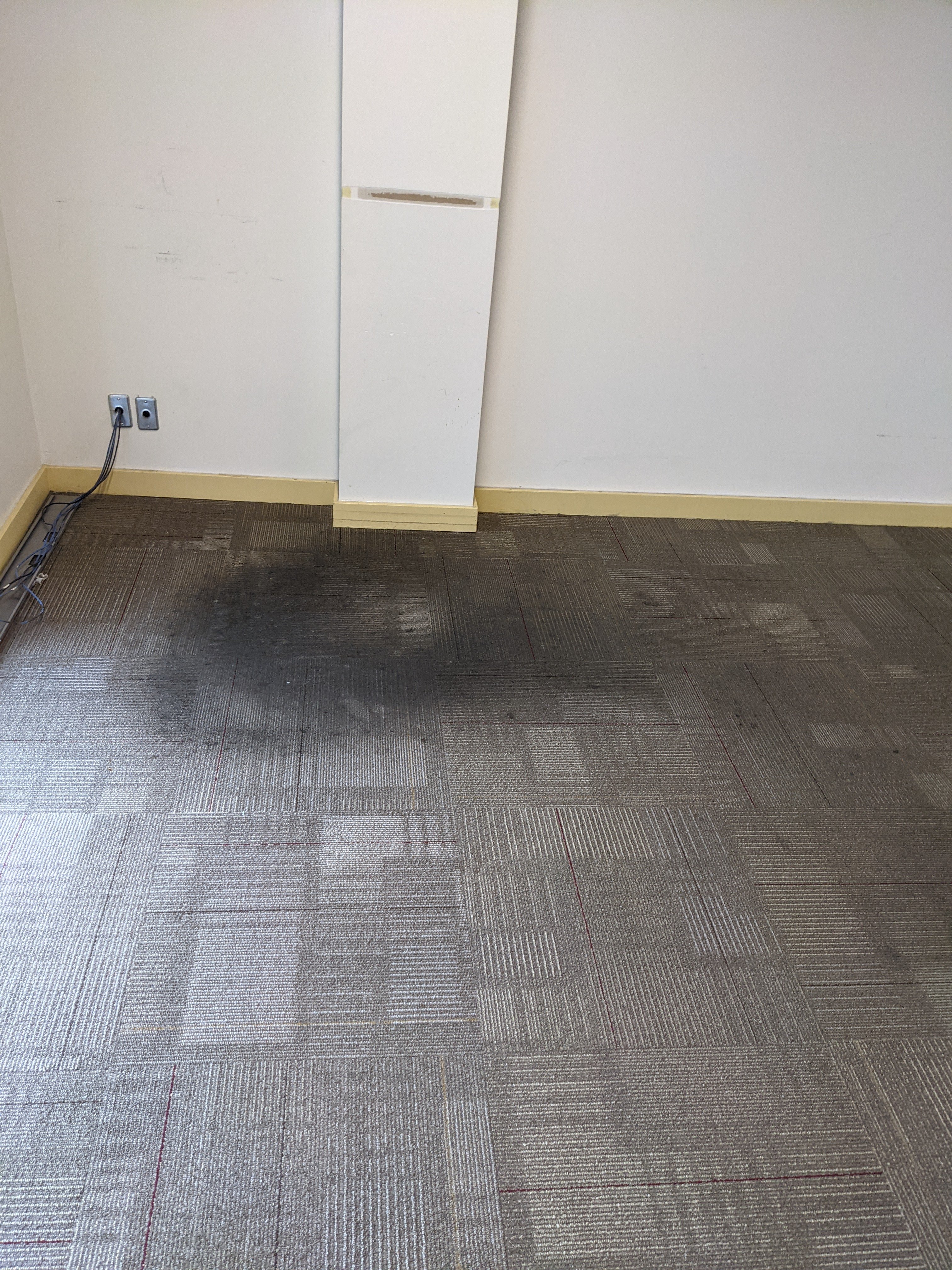

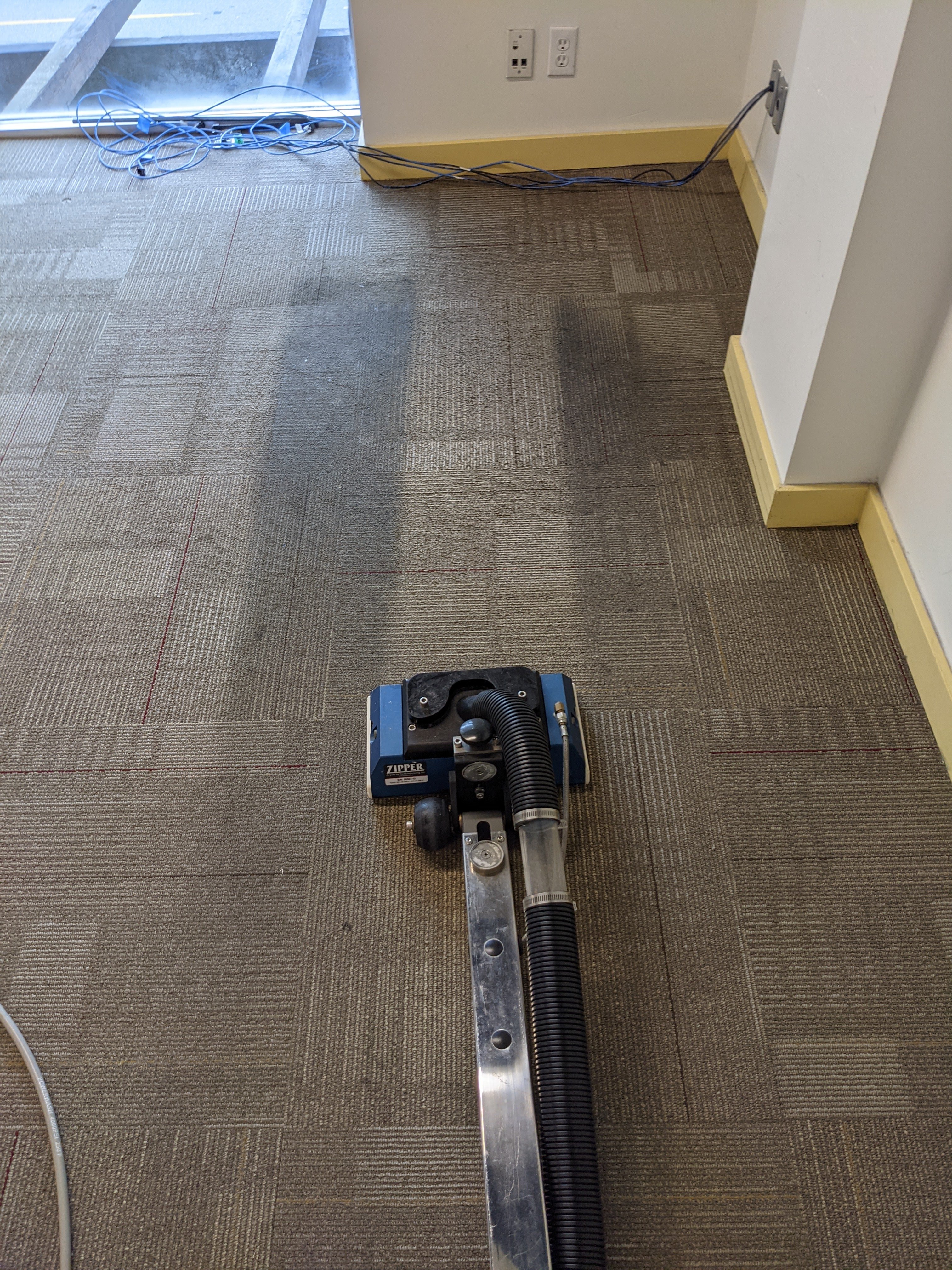

Just Zipping through this 1000 sqft office. Prevacuum, prespray with Saigers Code Red and nothing stands in our way.

Is that the spinny-type? Been thinking about getting one.

Once you get the hang of working away from your hose, you can keep both hands on and push/pull evenly. Has to be at the right height to move without locking down yet extract efficiently. Usually adjust it so that you can just slip a business card under the rear glide

Is the Zipper kinda unwieldy / impractical in tight spaces? Like furnished residential?
I find it unwieldy in residential. I like it in more wide open commercial. I have seen guys use it in residential but I find it would slow me down. Would definitely flush well though.

It's easier on my back. If I had to use a wand on this job, it would have taken me longer and I would have had to work much harder.
It is not the right tool to use in furnished, tight spaced, residential. I know a couple idiots here who use it on everything, including residential, and I can only imagine how many tight corners and small areas they're missing.
The best place for using is open, perfectly flat floor that doesn't make it bounce. Anything else, bring out the wand

If you square up against the wall or along side it you're not missing anything. The places like closets or areas around furniture you can't reach with it, just cut in with a wand. It's easy if you want it to be.
