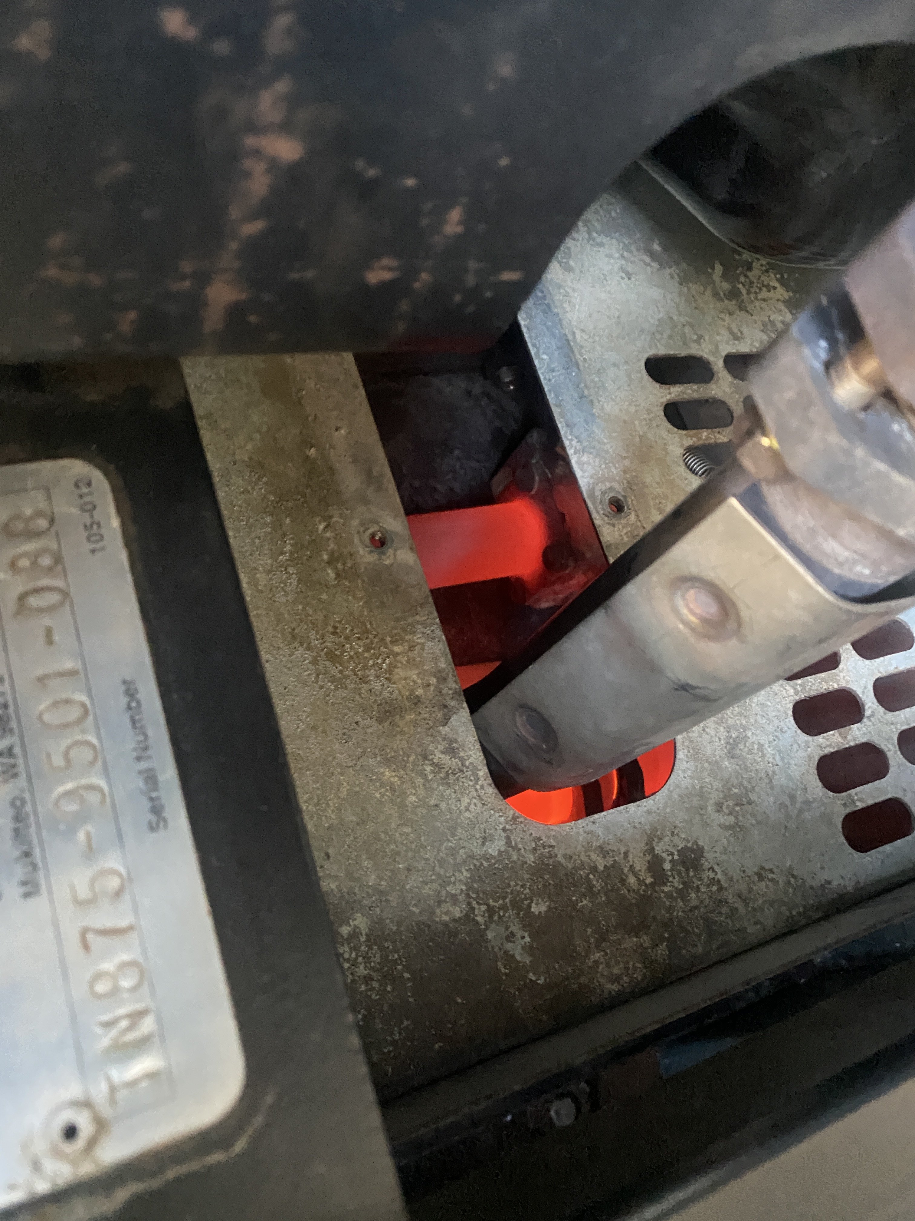

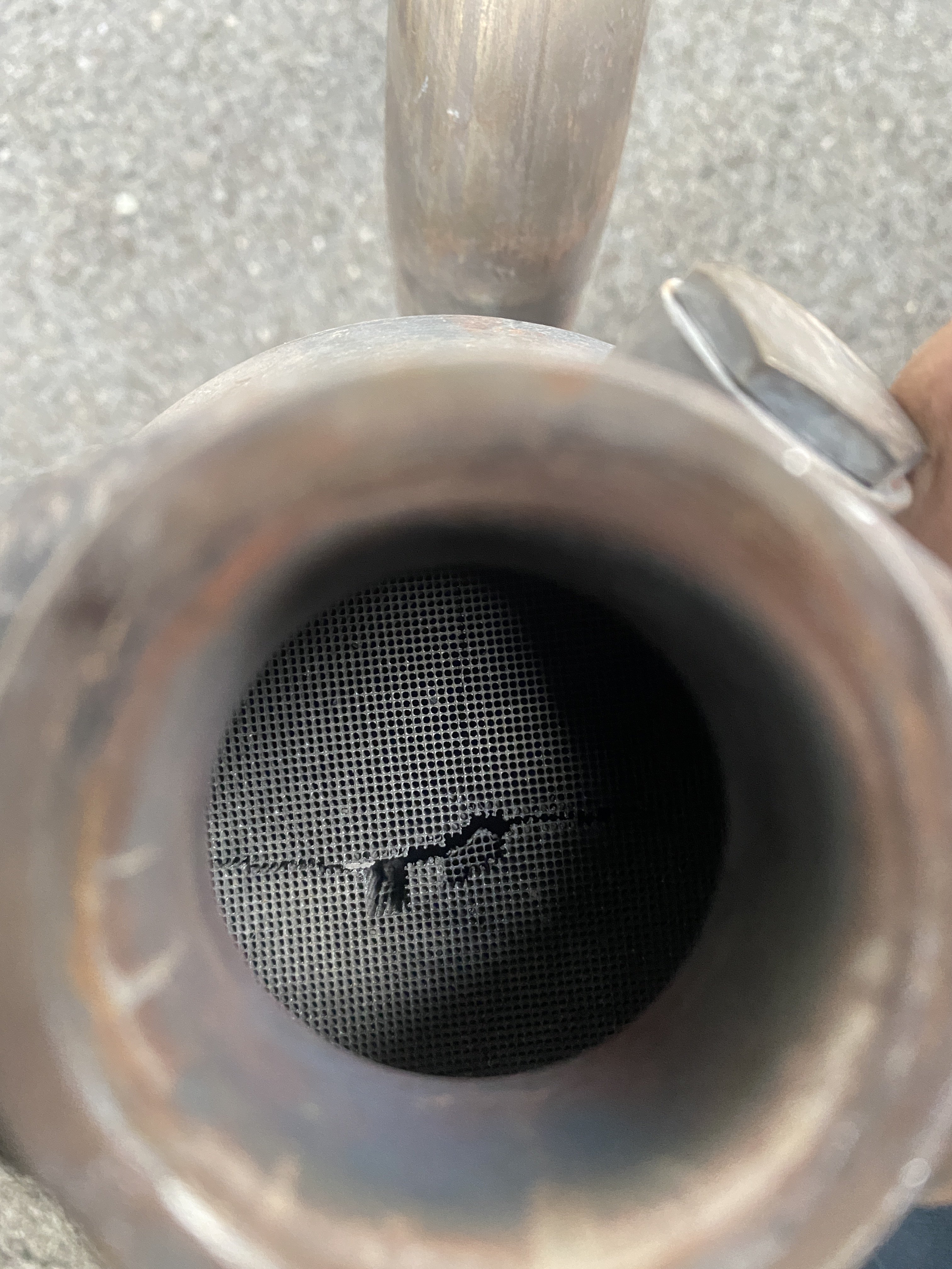

Sounds like it needs a tune up. ( new coil packs and plugs/wires and clean mass airflow sensor. I’ve replaced cats that have been cherry red in 3/4 ton 6.0 vortec pickups due to misfire. All the Unburned fuel toasts the cats and the rapid cool down will also Crack the insides along with the extreme heat. Also determine that your thermostat is not stuck open. engine would be using more fuel to make up temperature.

I have the same readings with the fuel pressure at 32psi and the spark plugs are showing very lean burning and the exhaust manifold pipes are glowing red. did you ever find a way to bring it up to the 41-47psi? I've replaced everything except the fuel manifold which will be here in a couple days
