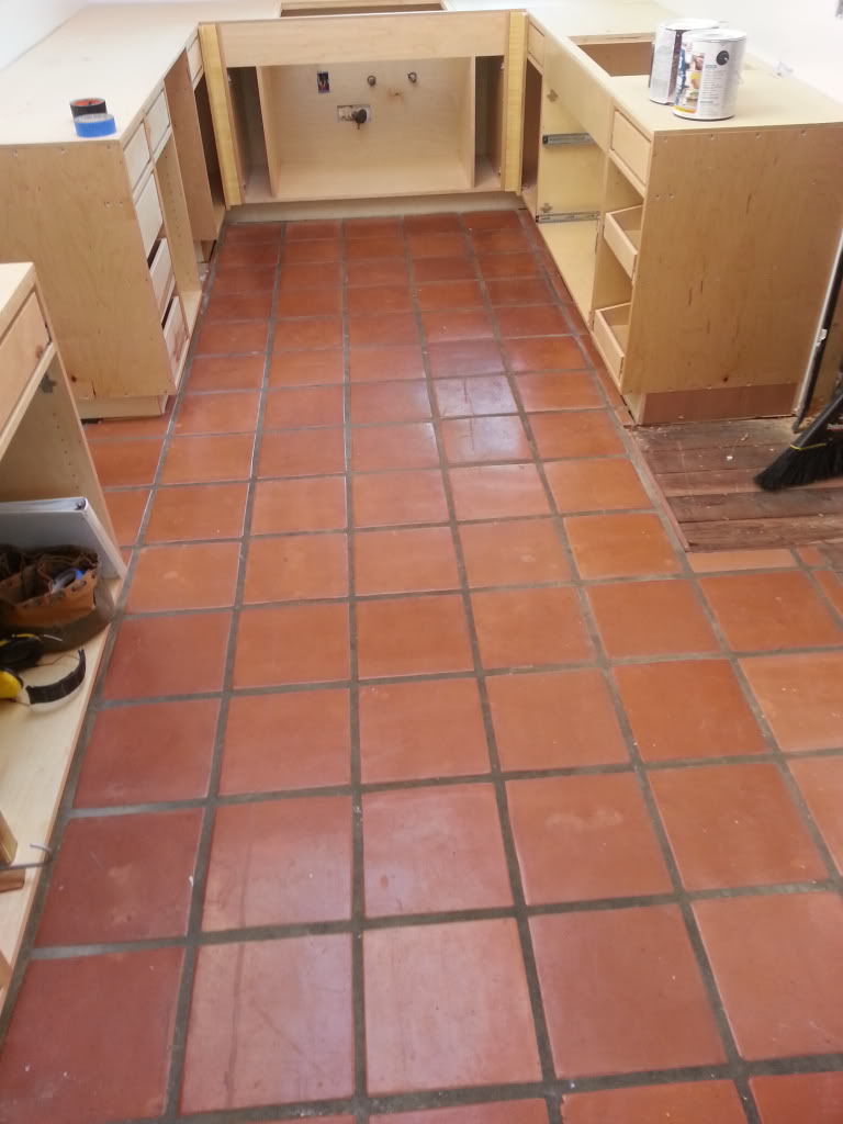

just these 70 or so feet took 2 hours to strip.
I'll go back tomorrow to apply 4 coats of wax/ finish
pretty much have to charge $10 a foot to make carpet money stripping Saltillo tiles.
20 plus year old floor, never dealt with..

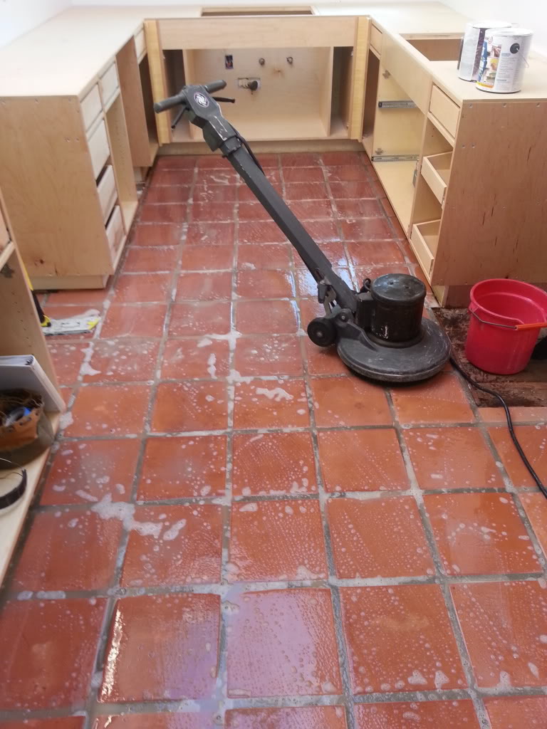

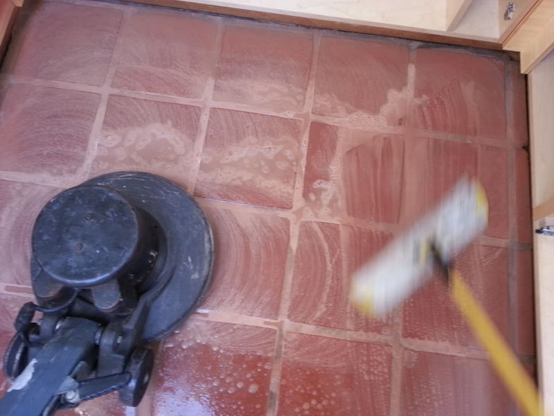

soaking in Zep stripper

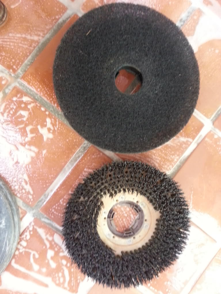

Went over and over and over with a Malgrit brush and a black pad..

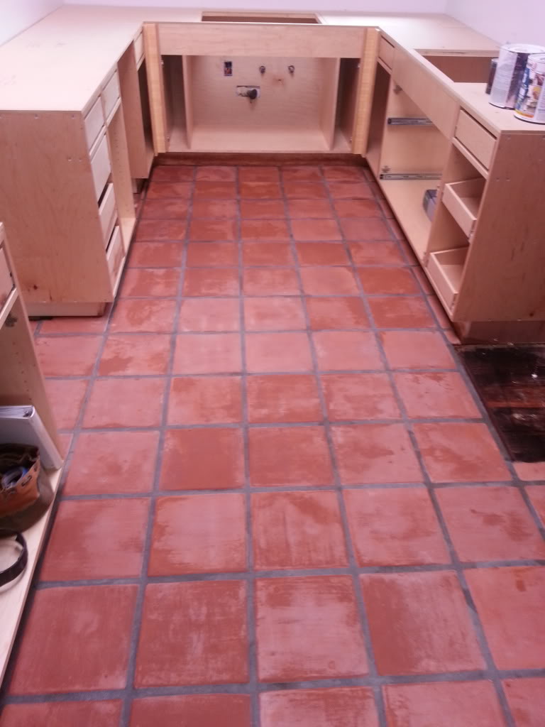

fully naked and drying..

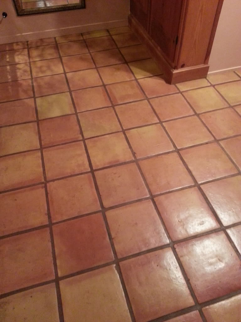

I wish I had fred in my back pocket. Mike I'm not knocking the floor, but with a better finish it would have looked better.
117,249
Fred has nothing to do with MY ability to post a word press blog.
and seven coats of a concrete sealer would have been ridiculous consider the same worn out floor continues seamlessly on to the left of the kitchen.
117,249
let me get this straight, polished marble looks "better" than honed or tumbled?
I guess that explains the bald head look...lol
I personally don't like an ultra glossy floor, and neither does this homeowner..

I like the flat look also. Too shiny and you are blinded at certain times of the day.
117,249
Its a house brand product called Brilliant Shine. Its the janitorial shops highest solids product
