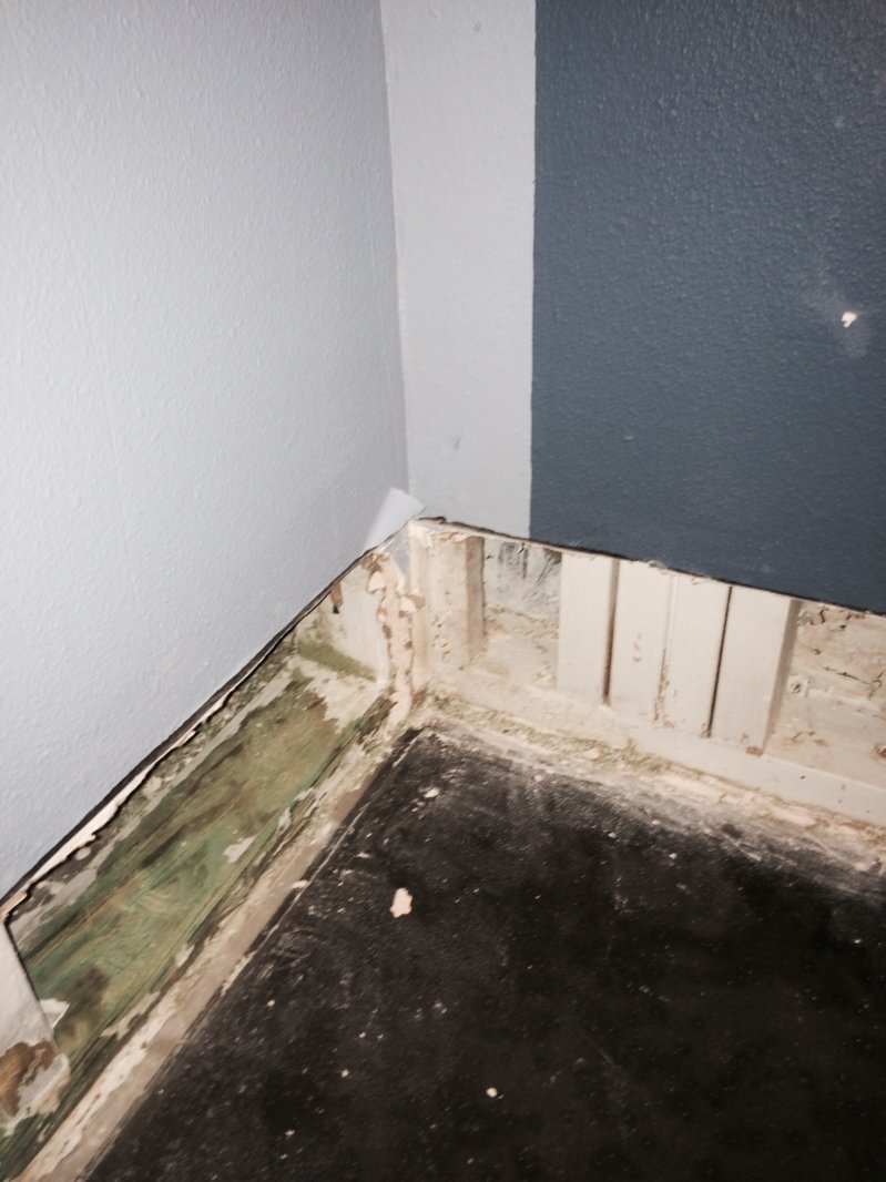

Im not sure the technical term. I think technically its a bottom plate as a sill plate refers to something that has an open cavity underneath. This board is flush into the concrete slab floor and there is nothing behind it except the foundation of the house. This picture is of the same board along the same foundation wall in the water closet. This area did not have mold remediation. The framework and foundation is identical to the ones on the bedroom that share the foundation wall and bottom frame board. The only difference is the walls in the bedrooms have insulation and sheetrock. The sheetrock has been cut all the way to the wet insulation and all wet stuff has been romved. Plenty of air flow.

No, PT wood comes that way, but it's typically used where it comes in contact with concrete, I see it used for bottom plates a lot below grade.

The pressure treated base plate in this picture appears to be saturated. The slab and adjoining wall also visually appear to be wet or have a high moisture content. If this slab floor sat in water for three days I seriously doubt it is back to normal moisture content. The base plate is in contact with the slab, and if the slab has an elevated moisture content so will the plate. How did you check the slab moisture content? If the slab is the problem which I suspect it is you should use slow airflow (to ensure you don't choke off the cappillary action) and employ a desiccant to achieve the lowest possible GPP. As mentioned the smallest possible containment area around the affected material will be a big benefit. Based on the assumption above, even with slow airflow, low GPP, and containment it could take a number of days if not longer to achieve normal moisture content levels in the slab and thus the base plate. Always hard to say for sure without all the facts and more info, but based on the info presented this would be the most logical explanation.
The picture I posted was from day 1 when the guys were extracting water. The board in the picture is also not the one giving me problems. It was just the only picture I had on my phone. All of those bottom boards running against the slab have some green stuff sprayed on them previously. The bottom boards behind the bedroom walls had the green stuff and then white paint on top of the green stuff. That combination created a very thich texture almost like gum and was holding the moisture in the board. The bottom boards that just had green were drying and the bottom boards that just had the white paint were drying fine as well.

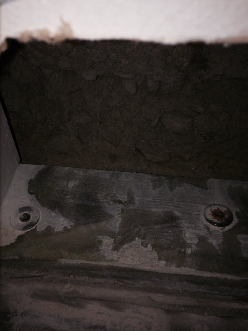

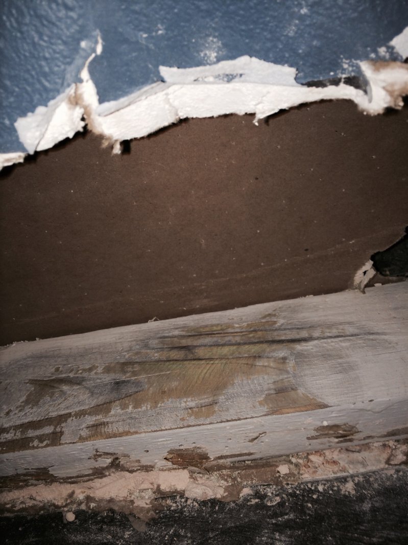

Just checked it and moisture is coming down quickly since I sanded the goop off. Down to 25-35% already so should be dry soon.

The bottom pic is a good one to see the difference. Wall on left has the green AND white. Wall on left is just the white paint.

BMS usually supplies crews with Zinsser Bin Primer/ Shellac... I'd reapply it and test it before closing in the wall, if your doing the repairs.
