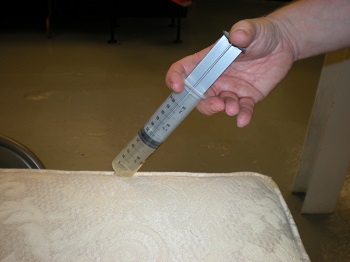

If cleaning with the above mentioned products have not removed the odor, choose deodorizers that use little or no fragrance in their formulation. Depending on the extent of the penetration of the urine, such products can be applied by spray or by injection.
"URINE OFTEN PENETRATES INSIDE OF CUSHIONS, - INJECTION MUST BE USED TO EFFECTIVELY TREAT URINE RELATED ODORS"
If you decide that injection is necessary, be aware that liquid that is injected will often wick to the surface and potentially cause water stains, browning, or color bleeding.
