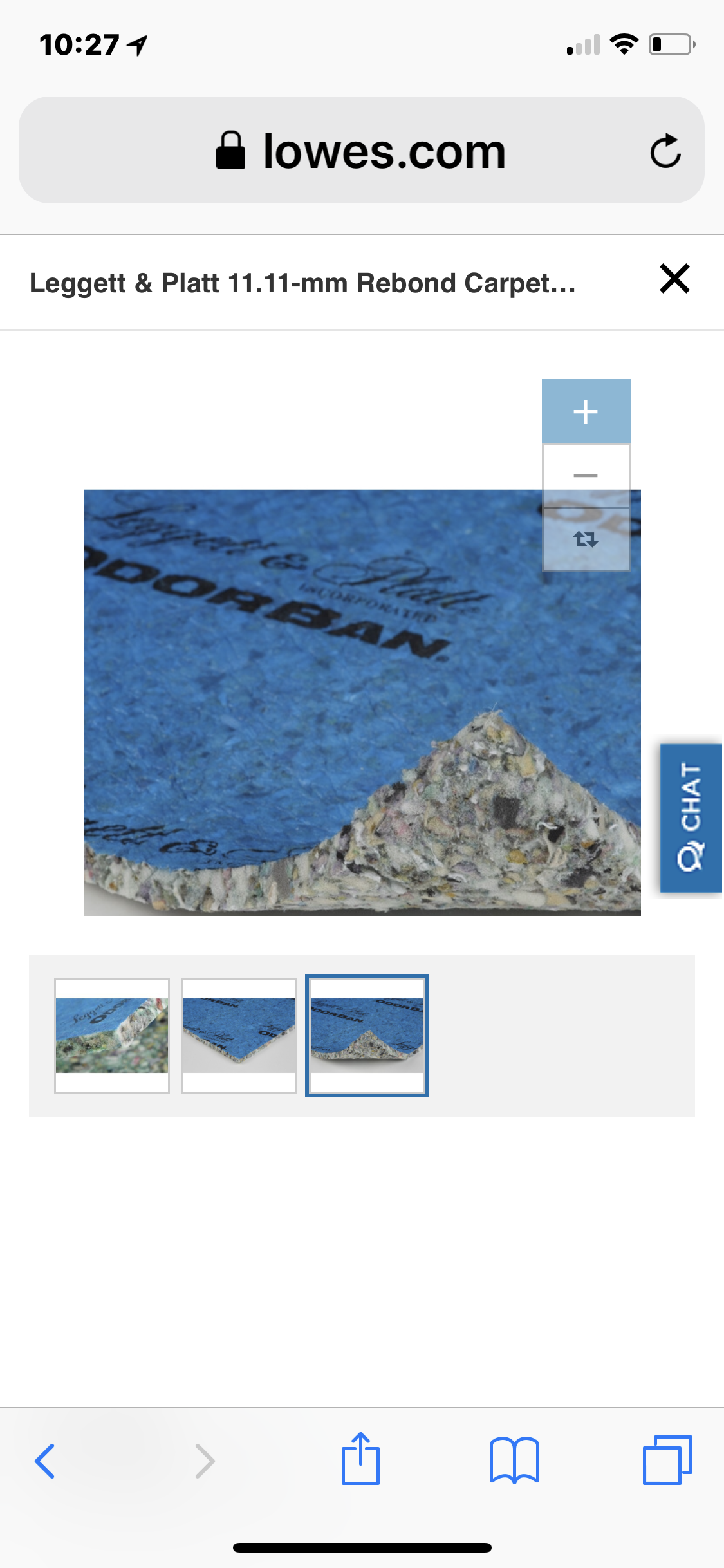

I bet that pet pad wont stop urine around the edges near tack strip, where males are likely to urinate.
if its stapled to the subfloor and seams aren't taped, it wont help much in the rest of the pad as well.
