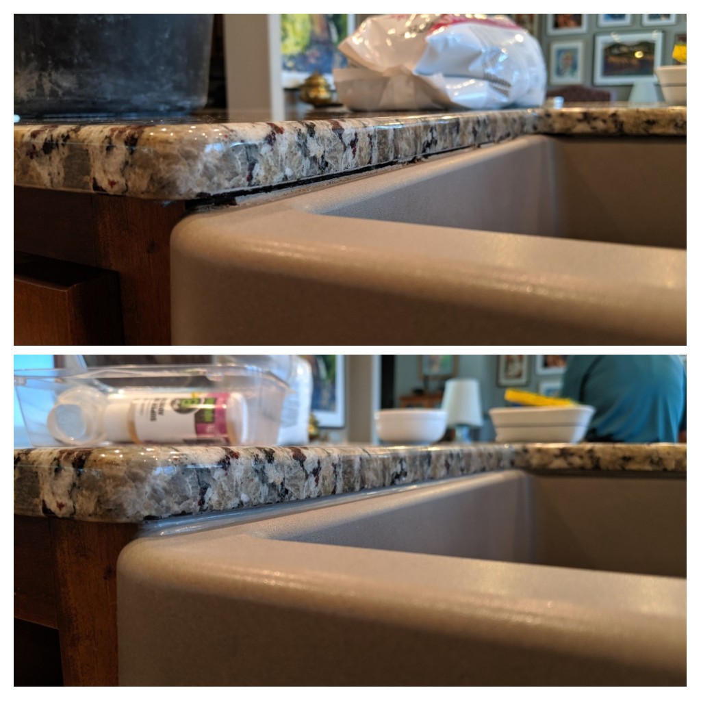

I better after shot of the triangulated sides would have been appreciated

That looks like it's going to continue downward. Have they been sitting on the sink? Is the sink sitting on the cabinet frame?
