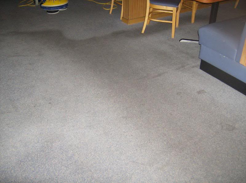

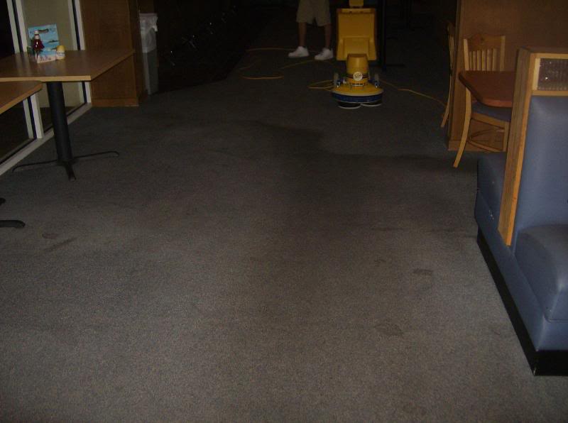

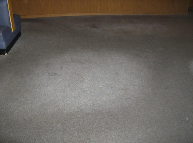

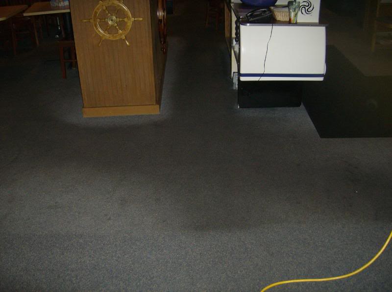

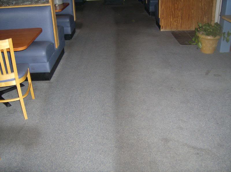

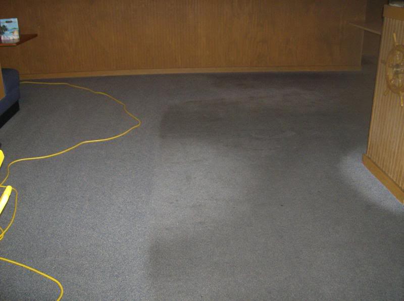

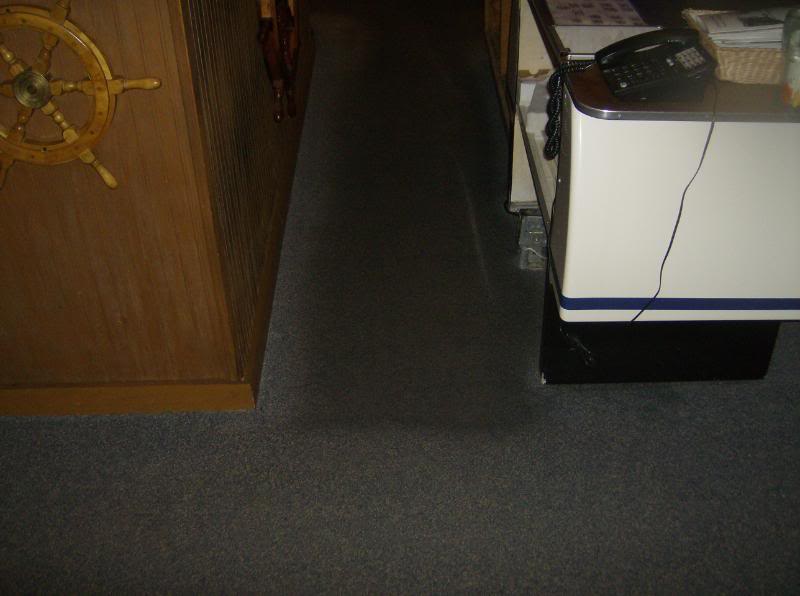

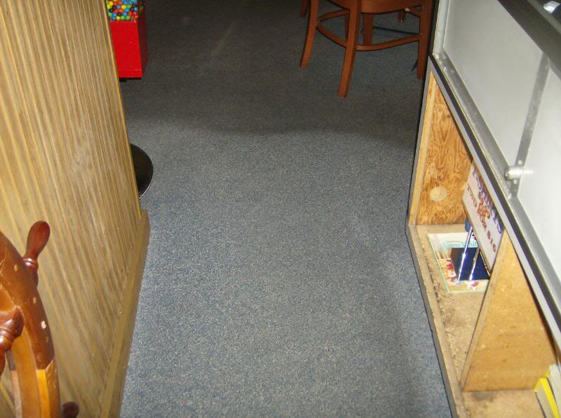

it is a seafood joint that i quoted about 6 months ago..i was too high so he kept getting it done by cheaper cleaners..it looked like crap, they had it wet for 2 days after the cleaning and it soiled back up in 2-3 days..he finally called.

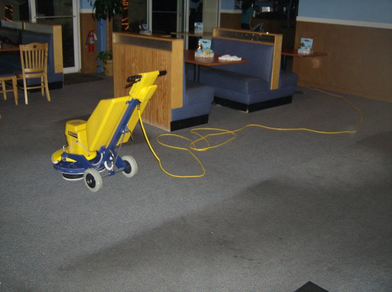

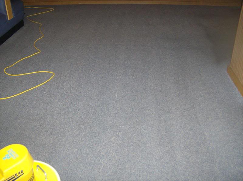

i decided to bring the cimex along for the ride just to see what it did. i was ready to stick it but a few passes with the cimex and bam!!! it was awesome.
i went a little heavy with the Releasit ds..instead of mixing 4oz per gallon i was mixing 6 oz per gallon. super hot water and away we went..
excellent supply was great with the tips and were dead on with their info..
here are the pics
i will try to put them in a before and after order..

i am pretty sure it was a lot of residue from the others..it was pretty black in areas but only a few times did it act like it was a solid surface..
the restaurant is 1280 sqft and it took us 2 hrs, but we moved all chairs and tables.
