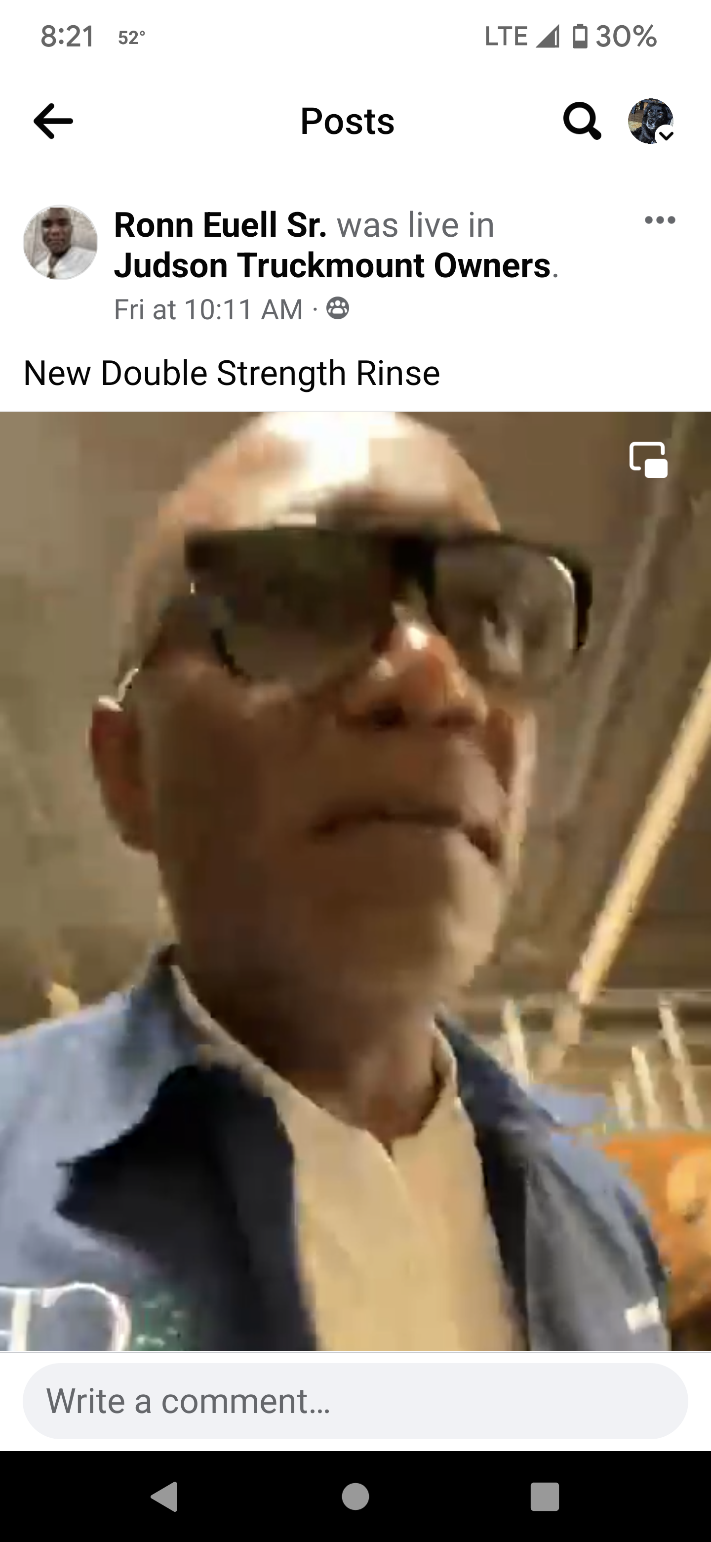

Video says double the strength
11,530

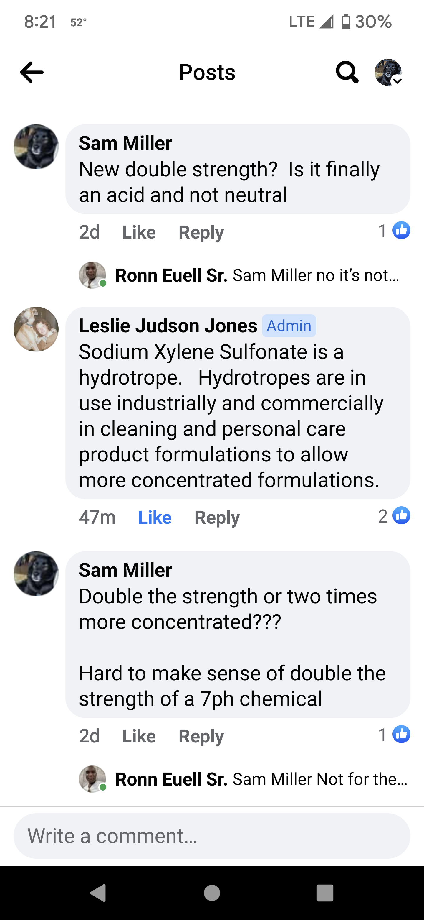

Judson 02 rinse is double the strength.
A 7 ph rinse new improved, but they basically made it more concentrated so it goes further.
It's not stronger surfactant wise?
It's a rinse I was hoping for a lower PH to neutralize ph.
117,247
I'm not speaking for Les Jones formulation, as I don't know anything about it.
Sam, is your goal to rinse or to neutralize?
Unless you are cleaning natural fibers, or you are using a "nuke" prespray, a product that helps to rinse and remove cleaning agent residues is good enough, even if neutral instead of acid.
Acid rinses are dual purpose: They should help to rinse and remove residues, as well as lower pH on the fiber to prevent damage to acid dyes (fading or bleeding), prevent cellulose browning, or to leave natural fibers soft.
But if you don't need those functions, a neutral pH rinse agent should do what you need.
You could do a pH test reading on the carpet yarns after cleaning to see how well each product is working for you.
Reactions: jeffexe and SamIam

Video said double strength
11,530
I asked the question more concentrated?
And Les confirmed that with his post.
So it goes twice as far as before.
The wording had me questioning the product.
Not the product itself.
