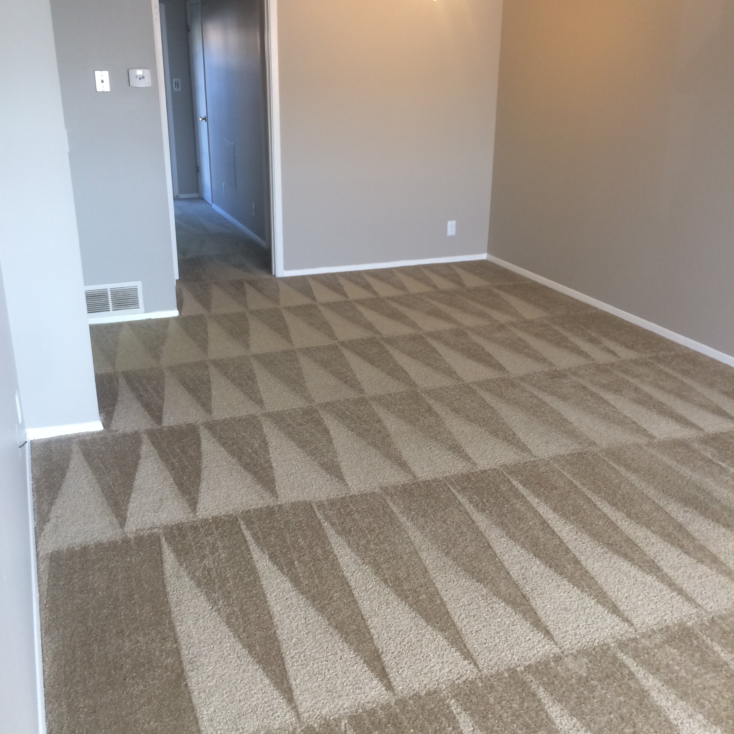

I have had the oppurtunity to work with multiple carpet cleaners over the course of my career. It seems that i have recieved a lot of different opinions regarding this topic. I believe that it is unprofessional to leave a bunch of diamond shaped wand marks behind and it can also look like you are trying to hide something I always rake out!. Please give me your opinion on this.
We basically groom out wand marks.
Was raised that way and out of respect for our family we continue that but we just believe if we can get it to look more like the day it was installed the better.
10,261
What about commercial carpet, do you groom that? What about Cimex swirls? Asking for a friend? What about that 25,000 sq. ft. with the Cimex, you groom it?
On dense pile the swirls are going to be visible and yes we have to or risk that it will be unacceptable to the clients. We have the jumbo groomers that have two heads attached to one handle.
In general the vast majority is not groomed because the swirls do not show when dry.

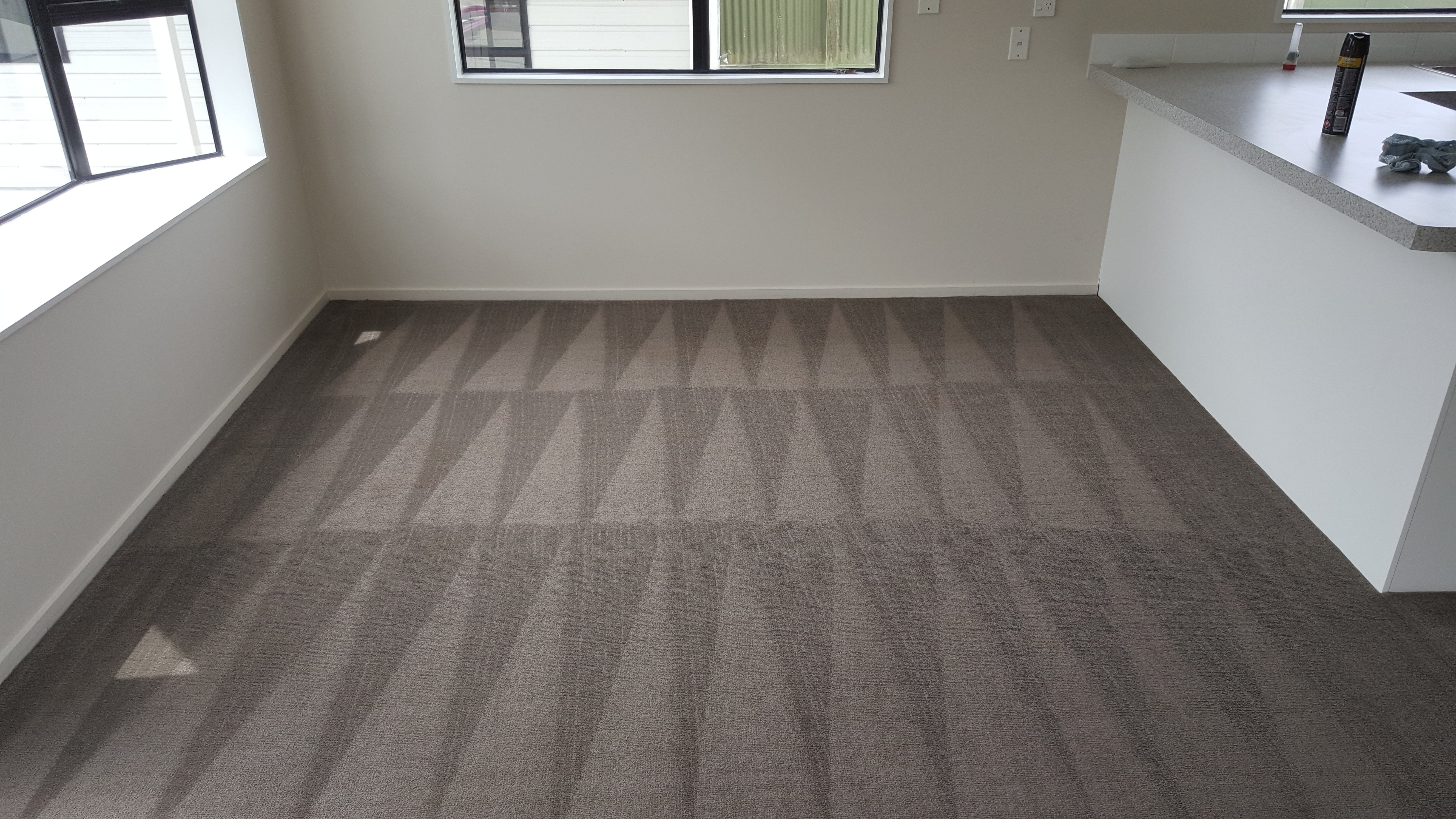

i think straight wand strokes looks better thn the diamond patterns. if you apply protector then a grandi brush or something like it should be used. it spreads the portector into the nap and helps it to dry faster.
you could go by the room and decide. a formal dining room is groomed. but family rooms and bedrooms are going to get foot traffic right away, so straight wand strokes makes it nice until that fades away. i've seen utube videos that show grooming but because it wasn't deep cleaned there is still dirt showing. that doesn't look as good as some diamonds in it.
res in good shape gets groomed
trashed chit doesn't
as long as wand strokes are straight/square to the world, they don't look "bad" to most.
when they're haphazard they look like a jumbled mess of ugliness
and if you're one that says your custys like the look of RE rotary swirls.....I question your or your custy's sanity......
