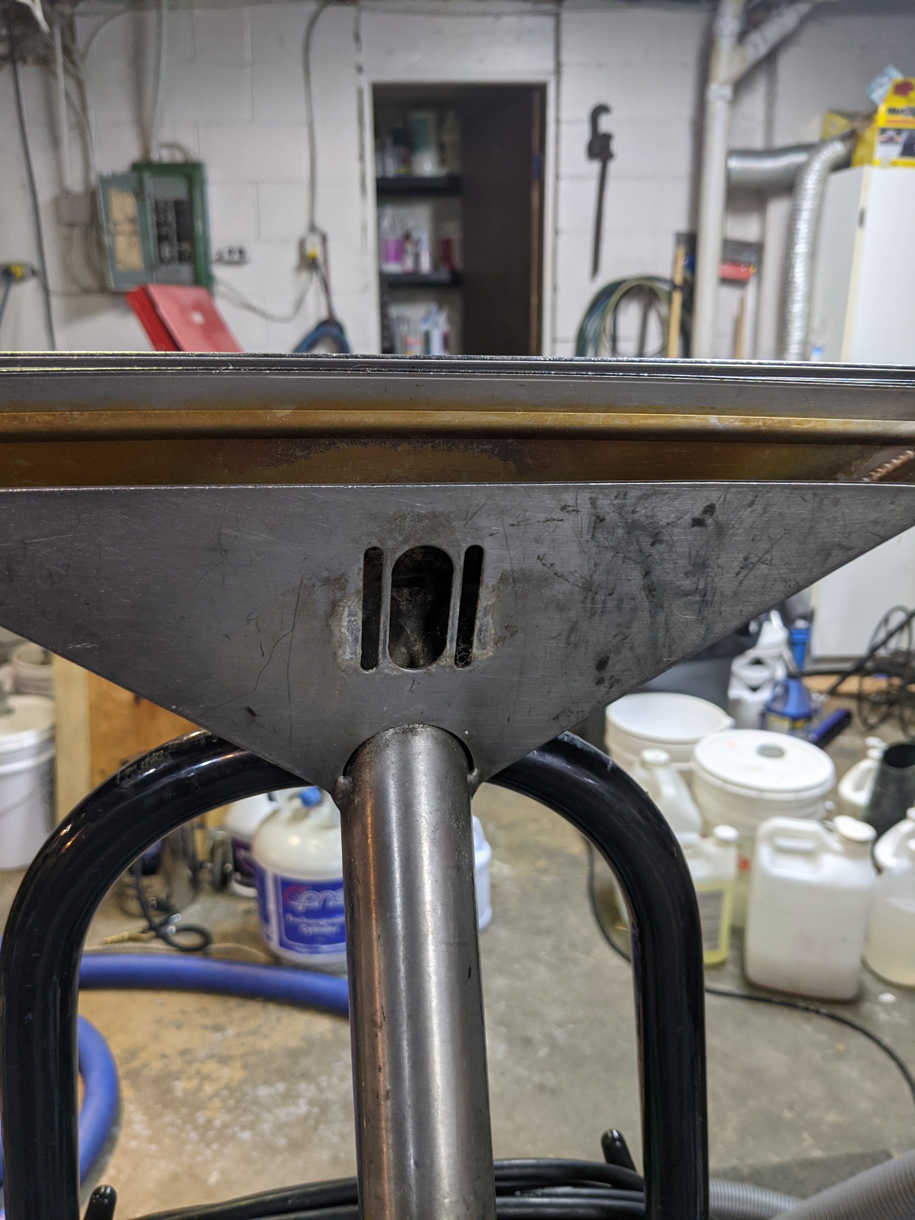

I still have a couple. I like the concept but they wouldn't pick up very well in the middle depending on the power of the unit and the style of the carpet. Very heavy wand. Probably an internal fit glide would help.
Can you tell me what the Jet size is on that thing

9 flow?
Can I borrow one?
I'm not sure how it correlates to a t or v jet but I remember it putting out what seemed a lot of water. There is some adjustment on the steamway wand to raise or lower the jet. Probably easier to find a jet locally but I could mail you this one. It is brass so probably worn out.
What's your theory on why it was distorting? Was it from the jet being too strong in the center or on the ends from possible?
is that like a trick question?
flood jets (FJ) are heavy in the center (from my experience)
..more pressure/more water/more impact.
too...the jet is prettydamnclose to fiber
the slotted thingie on the wand head allows adjustment up or down jet height if needed
(for angle of spray)
I'm told the stock FJ is equivalent to 07 flow
it's a good flush wand, but TEE and VEE jets are simply a better mousetrap than FJ
