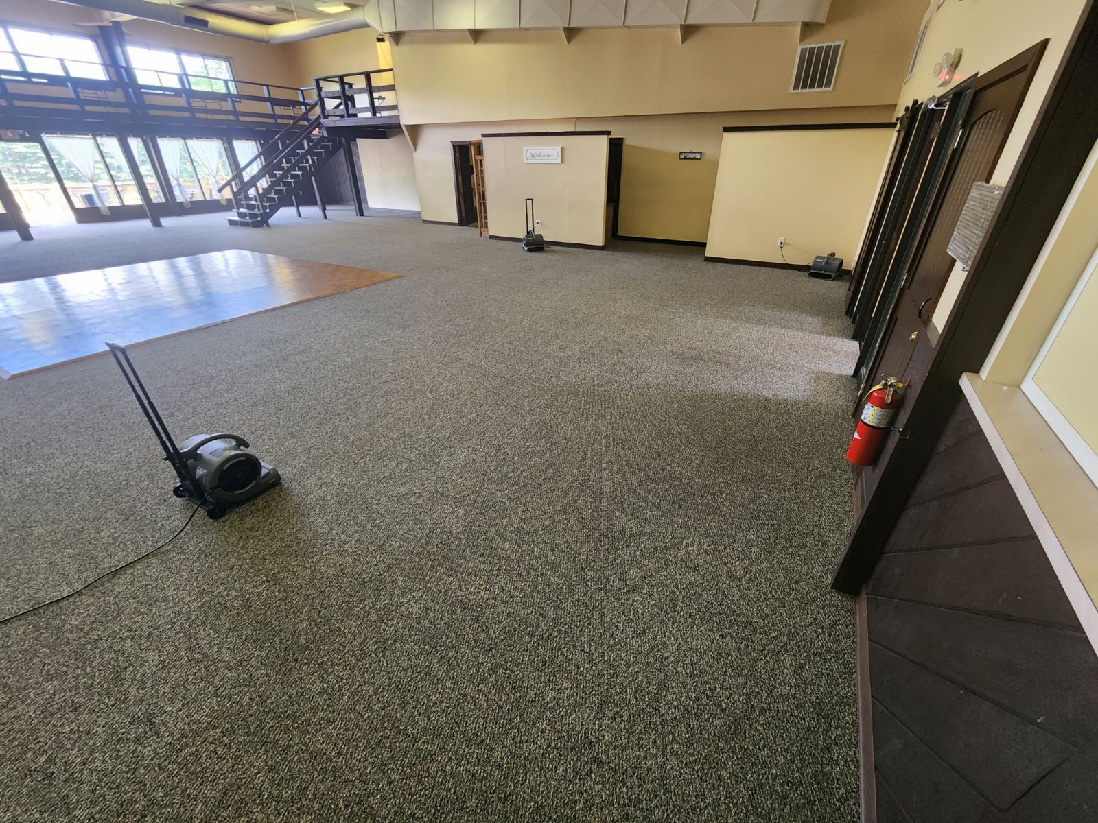

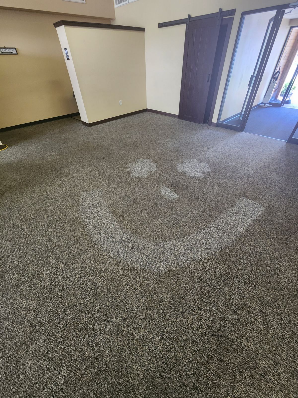

Our best customer yet found us searching the web last week. The roof leaked last month and soaked the carpets. All was repaired and dried out but the carpet looked terrible. She thought it was water damage because the dark area was exactly where the water was. When I met her and took measurements of the space I brought in a spray bottle of encap and a terry cloth. Sure enough the dark area wiped right up. It was soil wicking from where the water had drenched it. The manager was very happy with how it all turned out today. Cleaned up nicely.
