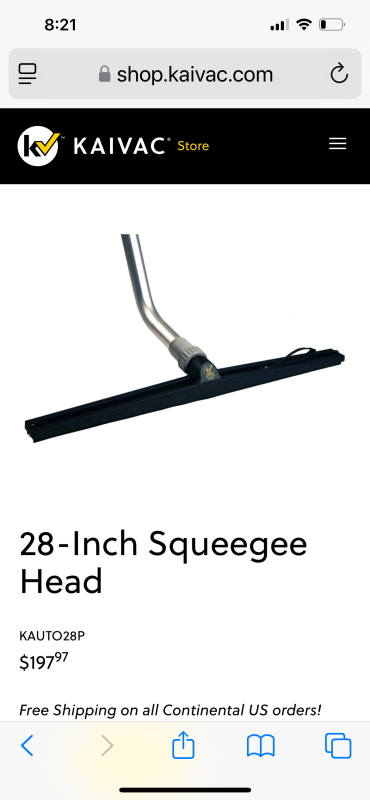

This with a Rigid wet vac is the cats ass for stripping small floors. I wouldn’t even want to get a good Mikey floor tool in that. It will swivel to even get behind toilets beloit or not.
It’s gone up a hundred since the last I bought, but it’s so worth it.

Get the rubbermaid blue wax bucket and the 18” rayon flat mop on a dust mop ring and handle, and now you can really fly. All that is a little pricey to start, but if you want to do a lot, it’s the only way to go. Now you know why I pull a trailer🤣
Reactions: Living The Dream
9,839
Most of the floor guys use a Tennent or Nobles or something with the squeegee on the front and push it around. When Diana was on the #truck with me, I wanted to buy one for her.😂 She nixed that real fast. She said, I don’t want to push a tank full of water around. She just used the Kiavac Squeege wand and 50’ of hose. Actually it was effortless. (says me😏)
