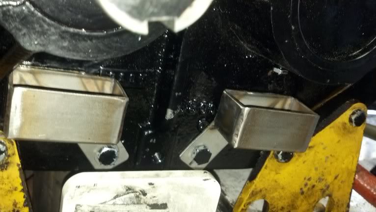

I suppose I should pop off the bearing side and have it rebuilt..
I had some nifty grease cups made to catch the spooge

Jimbo said:
Clever grease catchers!
Hell, i would patent them. :p Will your guy make me a set, how much? What a great idea!
