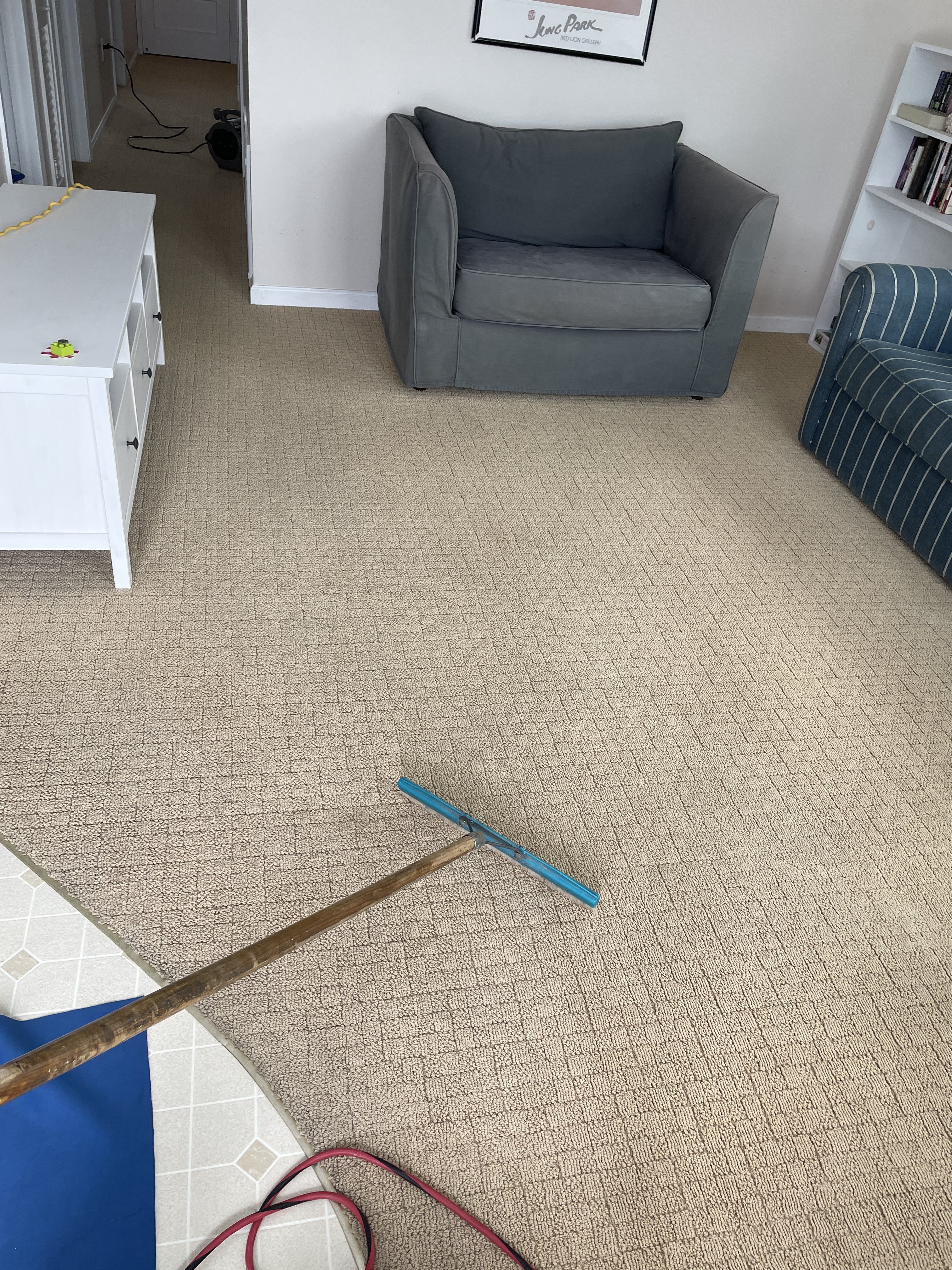

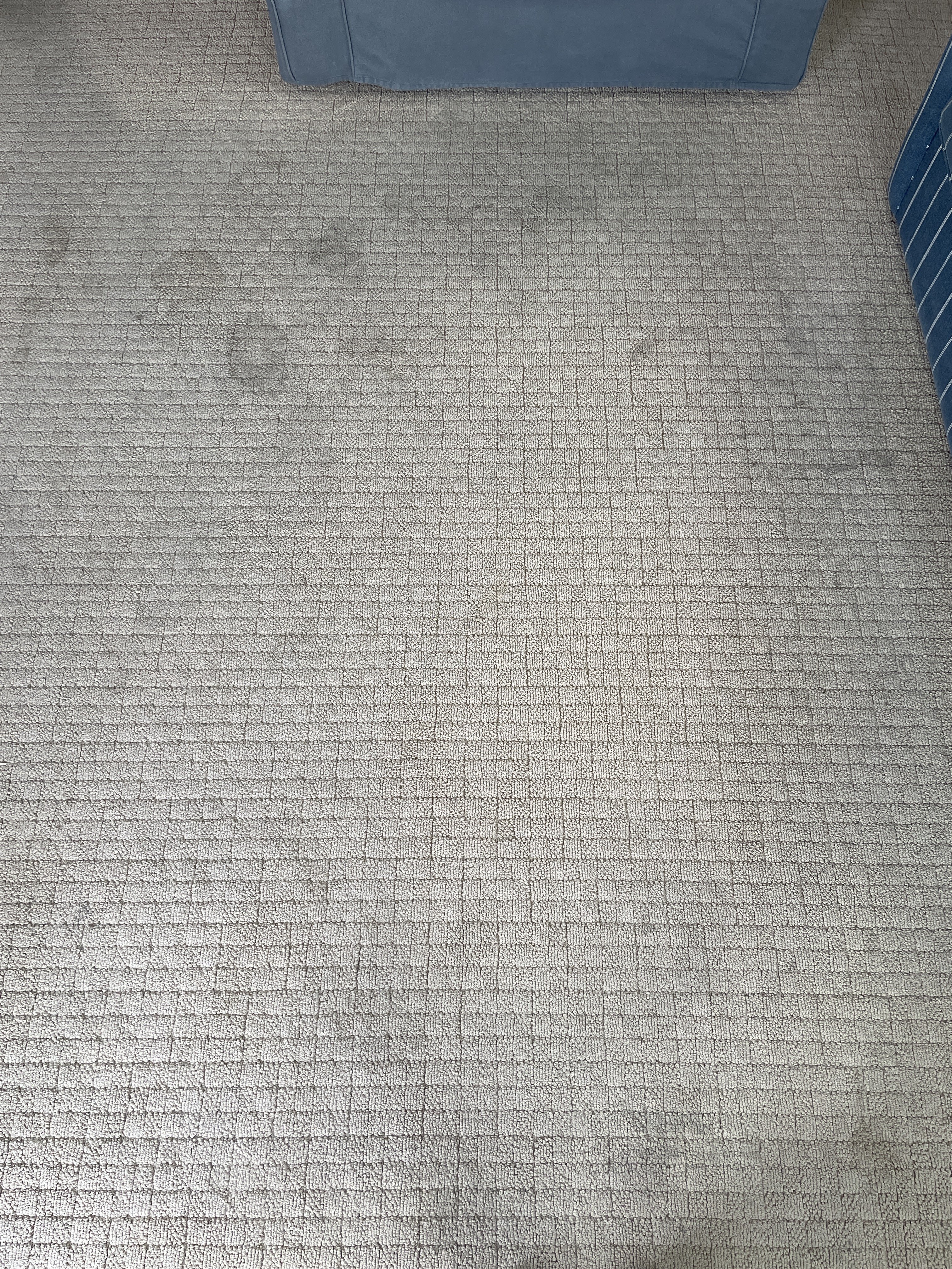

I sold a $300 touch up today for a customer that has a rental. I am gonna pad this in a month. I HWE today, but did a VLM in a demonstration today. I assured her, no more worries if her place needs a cleaning with a 2 hr window of changeover. Here is how it went
Before (I HWE under the couches, done)
After

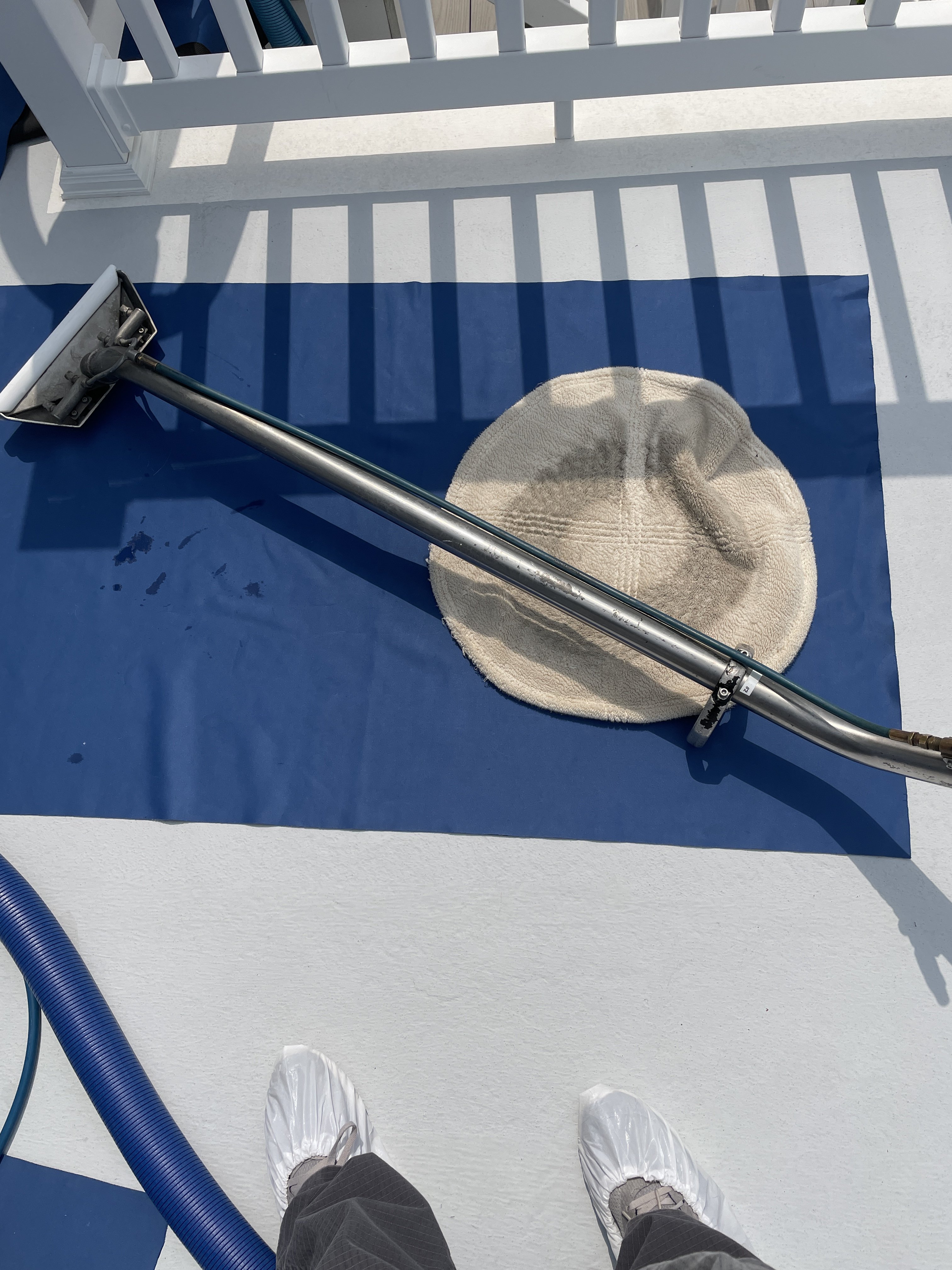

I did not do a good job padding, because I was set up for HWE already. I did this as a demo to show how I could put a band aid on it for the immediate time. I only sprayed a few ounces of Pad Cap Pro, NO dwell time, and was an instant no brainer for my customer t0 book a 30 minute appt in a month for $300. Win Win. She is so comforted now.

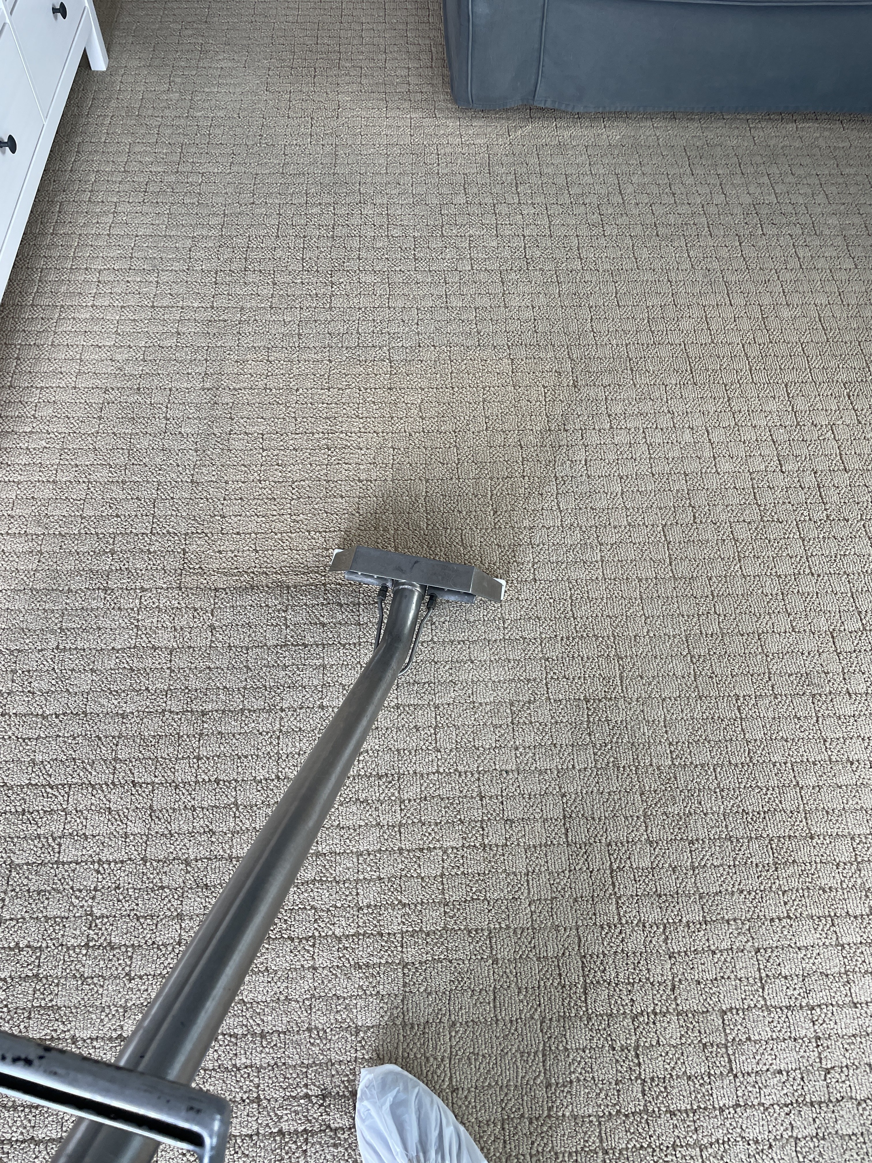

THEN I HWE after the hack pad job (the original work order. this pad was just a demo. Google cant sell for you like you can)

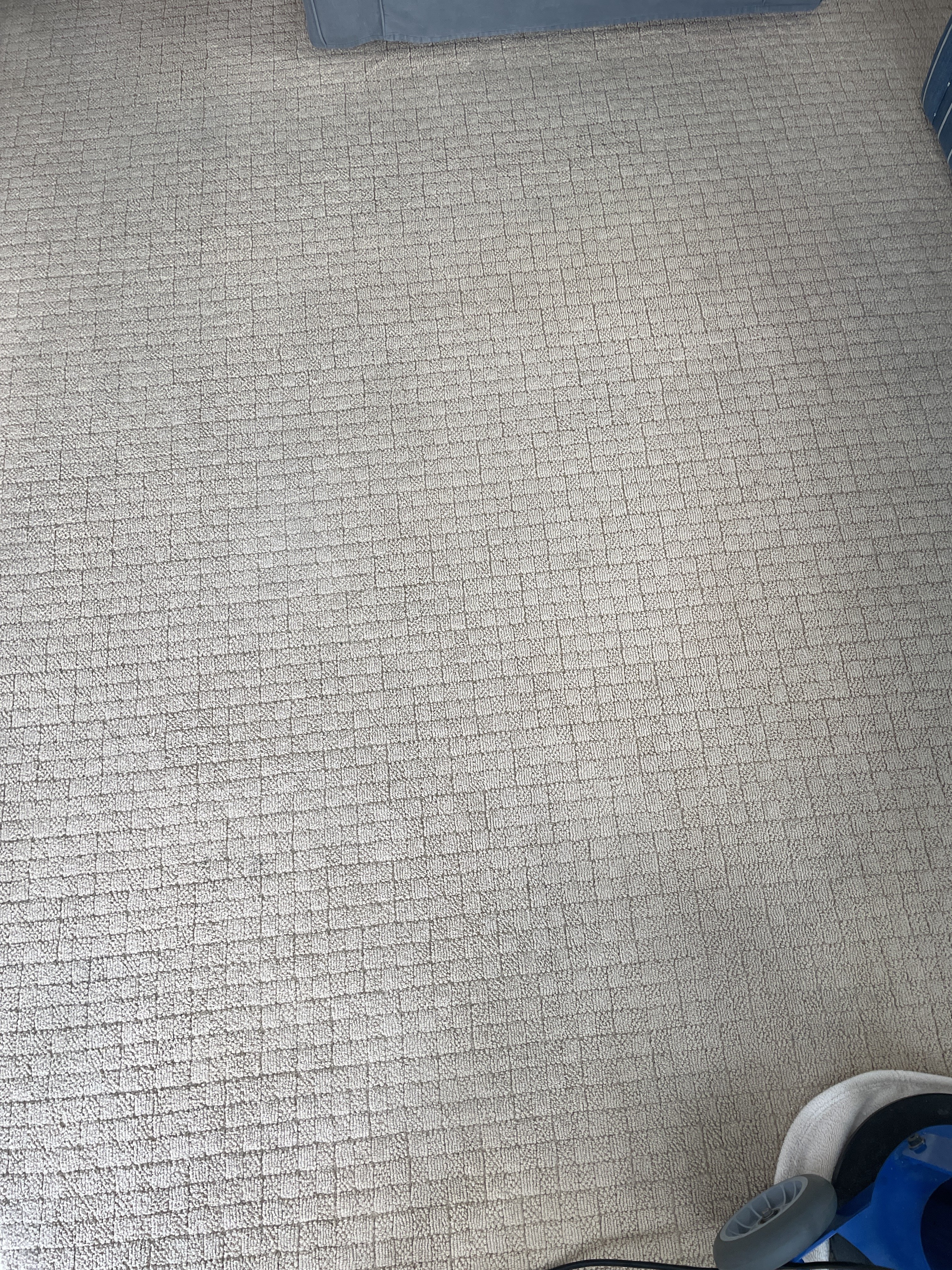

Fisnished
You can see the HWE did zing it, but if they knew I could have made it better without being as invasive and dry time restricted, they would have done this last season.

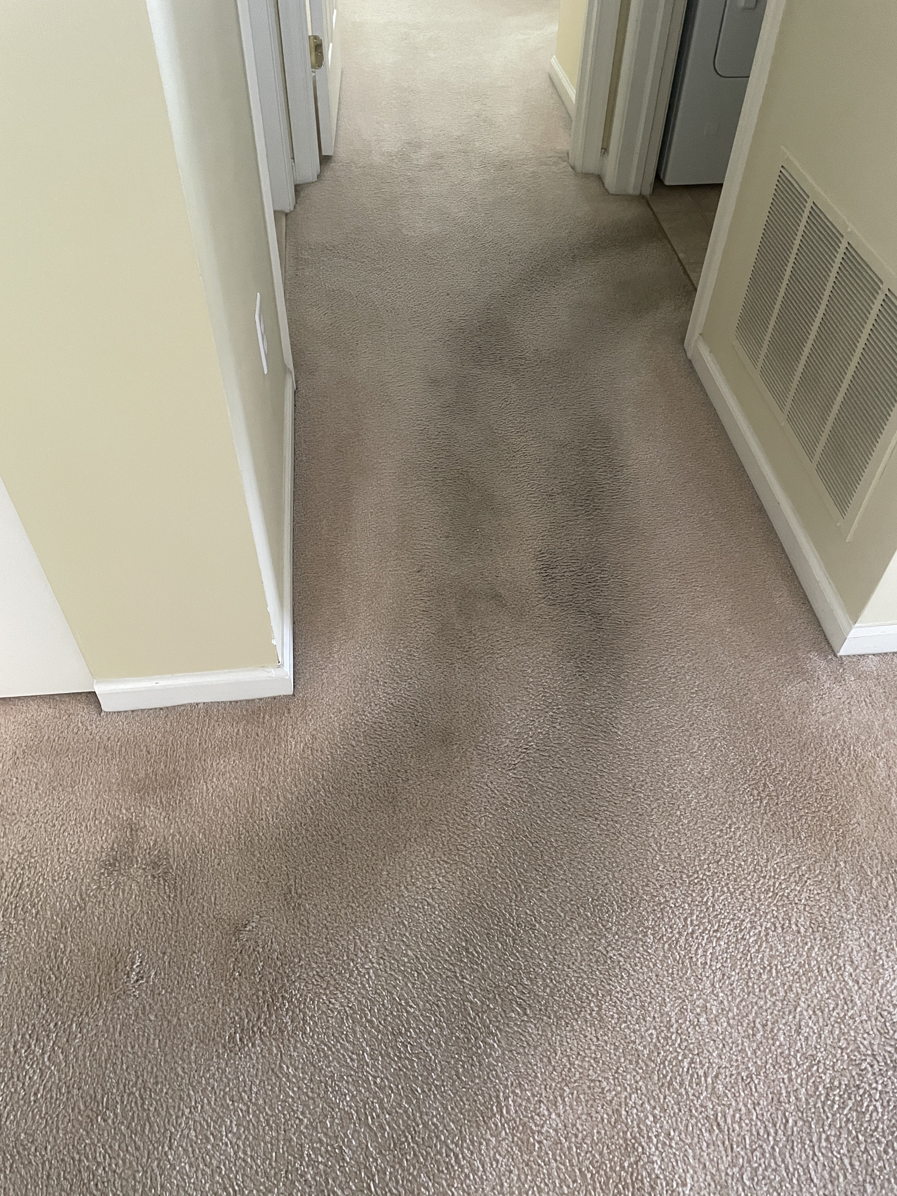

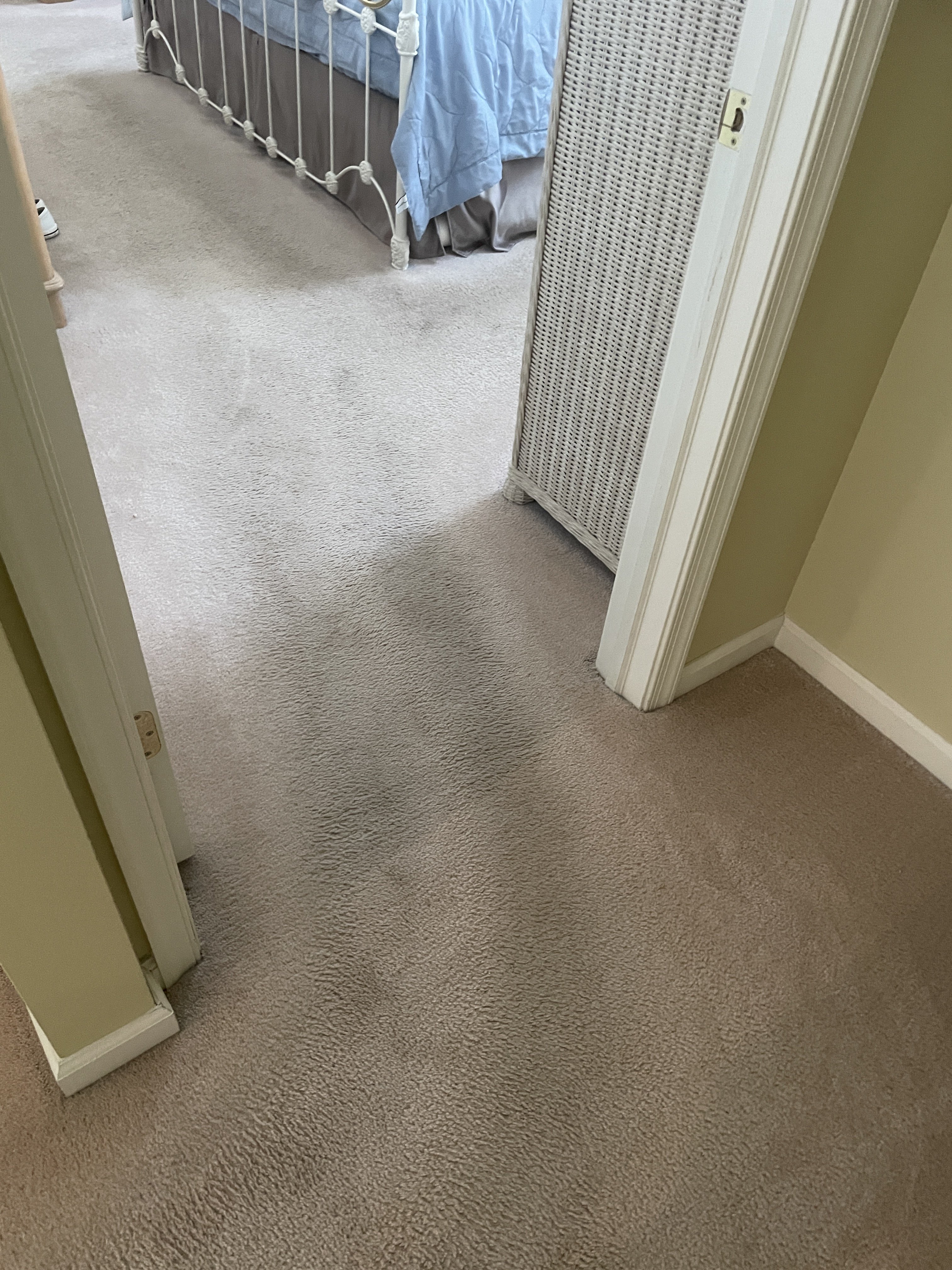

So Im gonna do this job in a few weeks. I am gonna Hybrid Clean. HWE first, then I want to Pad it. So after its HWE and still looks nasty, do I just start VLM, or should I come back when its completley dry, like the next day? I am doing this as an experiment and then may market this in the winter. If I get it better than just HWE.
So I got the Odyssey, some Pad Cap Pro, Tops Spotter to try to get better visual results.

they key to any method is agitation, so if you HWE without agitation, then you will be happy with bonnet cleaning. If you use agitation with HWE, you wont need to pad it.
So a good dry vac, then VLM with the striped agitation pad, HWE, then a cotton pad to finish. Would that be the correct steps?

You can do any combination, or do both:
1.1 Prescrub and HWE: If that’s what you decide, you don’t need to use an encap product. Just scrub in your favorite prespray and extract.
1.2 VLM and (Maybe) HWE: On a job that isn’t as bad as this, VLM and only HWE if the carpet doesn’t look good enough when you’re done. This method is what ends up selling guys on VLM, as it ends up working far better than expected most of the time. (Or the tendency to want to not work to hard makes a lot of tired old guys see it as “good enough”)
2.1 HWE and VLM: Carpets that are grossly soiled can sometimes look blotchy or streaked afterward. VLM, and in the old days shampoo, has the ability to agglomerate soil and leave “friendly” residues that scatter light and make the carpet appear to be cleaner. Don’t hate on me VLM guys, but that is one of the secrets of the method. My father was doing this in the early 70s.
2.2 HWE and VLM after the carpet dries. Now that we are deep into the “poly revolution”, wicking after HWE is getting to be more common, and VLM fixes it quickly.
In the end, you do what seems to make sense based in the carpet fiber type, soil load, your experience....and what the job and/or the customer is worth.

Thanks! These parrallell tracks are very common in 55+ communities. If I can "fix" them, it will be good. I will post the results.

2.1 is very interesting, I was thinking something like that happened when I did a VLM instead of HWE and looked so much better. It was exactly what it needed since they always looked just grungy.
Rubber sole shoes old retirees traveling the same paths shuffling.
It's one of the hardest things to break free.
The friction and rubber.
I tell people get different shoes or slippers.
The other thing is barefoot with lotion, that cleans up easier. just soils fast when the lotion oil up feet and walk.
Usually around the primary room around the bed.
