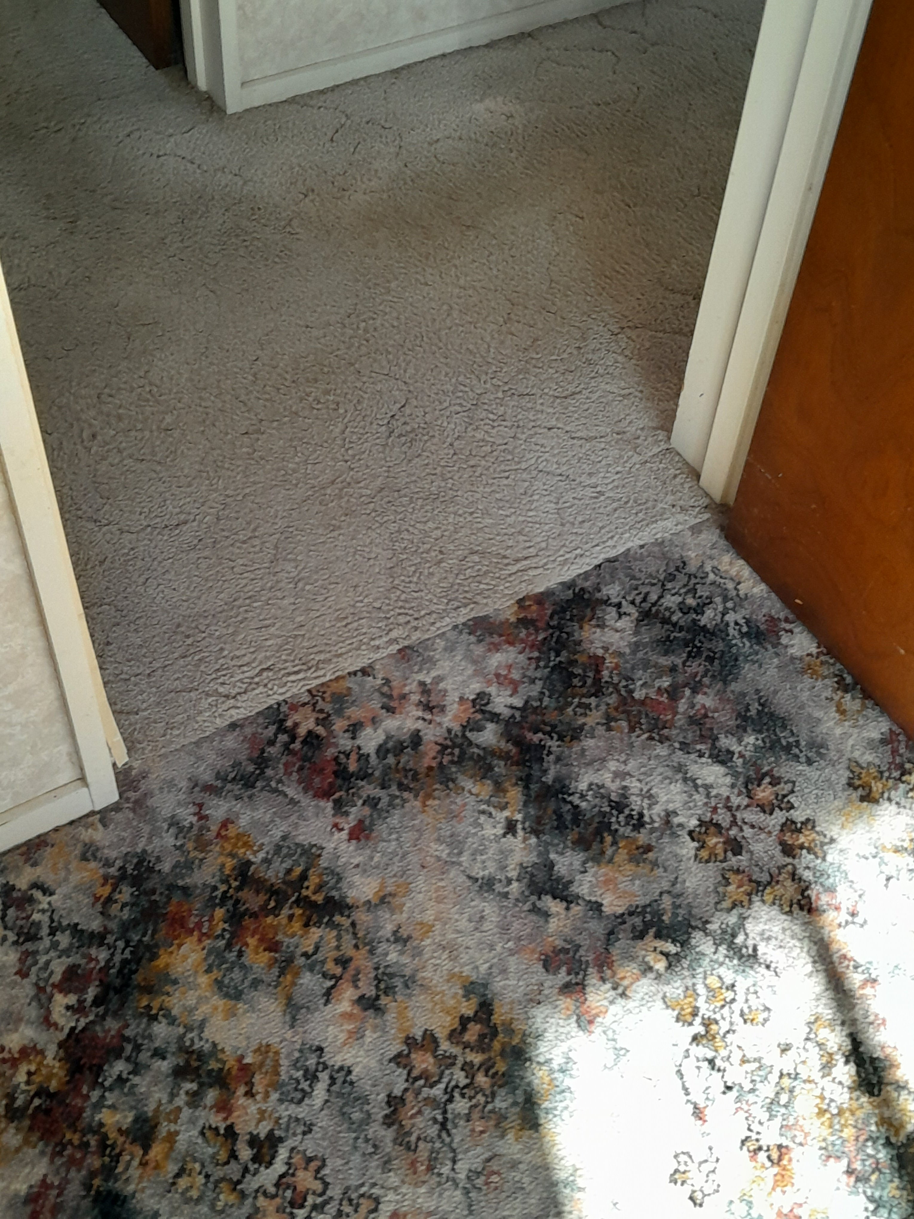

14,632
Poly gives its image almost immediately after the first year by showing the matted down look (crushed fibers)
And nylon is good at showing pile distortion (wavy look of pile laying another direction)
And wool is so expensive, the customer will tell you before you step on it. Lol
