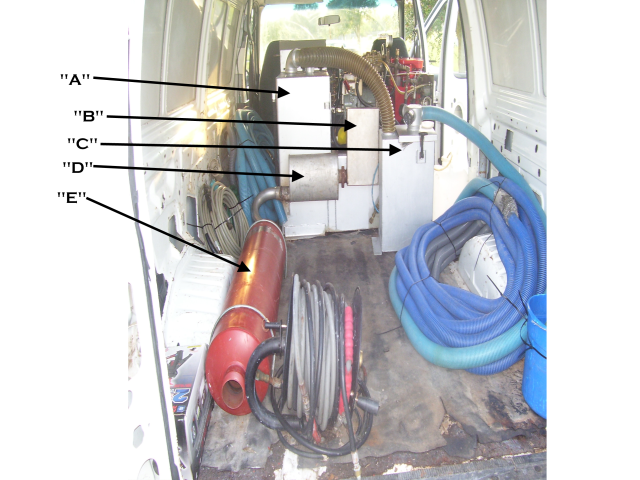

What are these parts:

A -Waste tank
B-Water Box
C-Filter Box
D- Muffler
E-Silencer
L
lesterj2
Re: Quick Explanation if Possible
Mikey P said:
A -Waste tank
B-Water Box
C-Filter Box
D- Muffler
E-Silencer
ok thanks for the input... but if possible could you tell me the functions of each piece of equipment...
Be alot easier to just find a distributor near you,they should know the basics.

Can't tell, but looking at the other pics, not sure if "B" is a water box or not.
WISE
S
Shawn Forsythe
"B" is a heat exchanger.

SRI Cleaning said:
B is the blower heat exchanger
so what is the purpose of the heat exchanger...
im thinking its like a mounted water heater, correct me if im wrong... :?
SRI Cleaning
May 4, 2007
1,131
Anthony Firmani
Yes, there are 2 of them. They take heat and use it to heat the water. The one in the picture is on the outlet of the blower. As the blower is running it creates heat. the exchanger captures that heat and uses it to heat the water. There should be one on the other side of the machine. This one has the engines exhaust running throught it and it heats the water even more. The one in the picture hangs off the side of the machine, the other one should be right behind the motor and it probably has a bunch of sensors and wires coming out of the top of it.

here is a pic of the other one...
and its connected to the muffler in the bottom pic in the bottom right corner...
