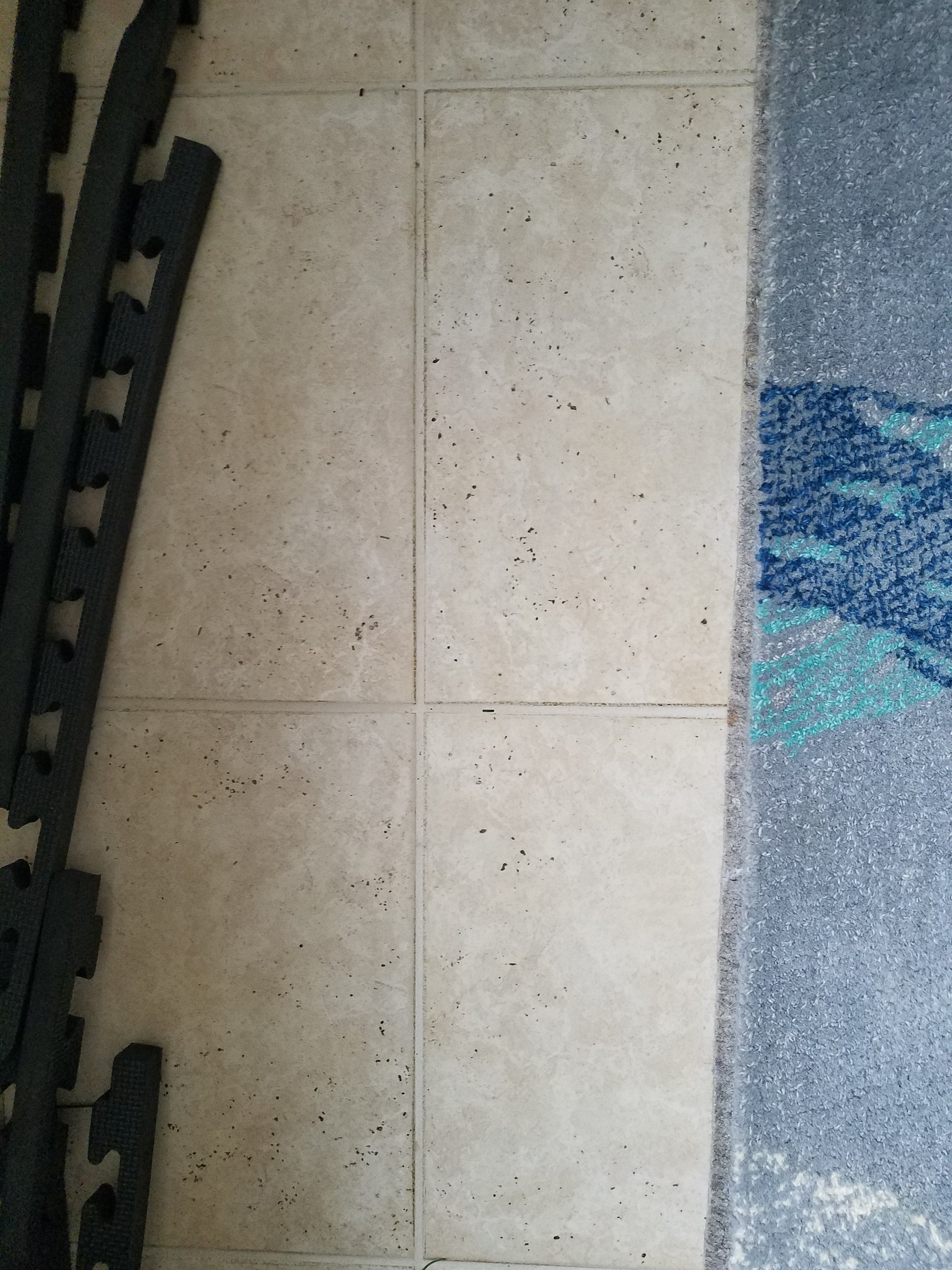

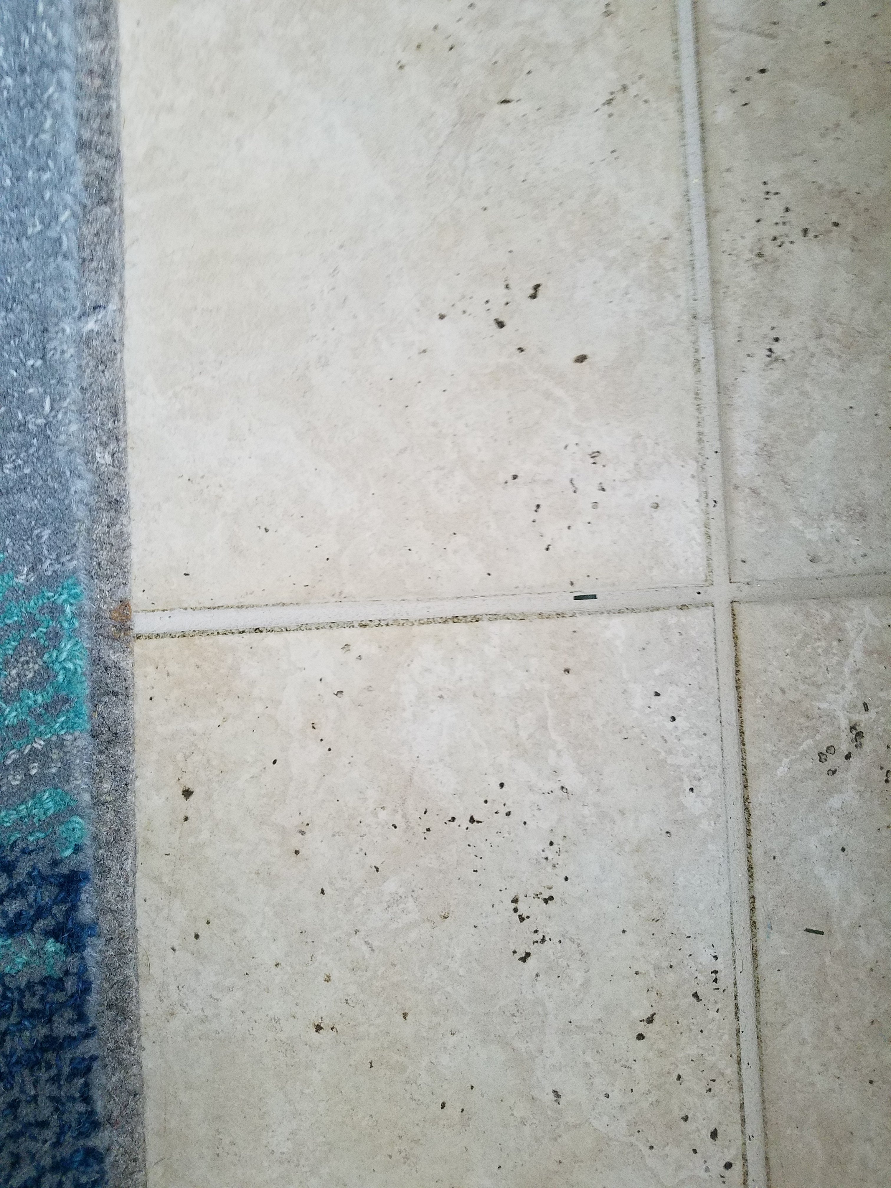

What color color seal is this???
jcooper
3,232
Jerry Cooper
Yea, screwed by the color sealers! Need to know what color this is so I can go fix it.
Got done with the carpets, Ms Smith should we do a test spot on the grout I'm giving you a quote on?"
Crap flaked off from just a grout brush... And she's watching.... Ugggggg!:hopeless: Can't leave her looking like that... So, I'll probably go fix the test area with more junk for free even if she doesn't want the whole 1500sqft done!
Bottom photo is color I need.
89988
89990
This is the color I need. Kinda off white, kinda light tan, kinda who the heck knows.....
Thanks fellas.

too hard to tell from pics cause lighting etc.... but if you want out of it and dont want to leave her with it looking like that then go buy antique white, bright white, and bone CBP crap from home depot... probably what was used anyways. It should be one of the 3 common white colors. About $12 per bottle.

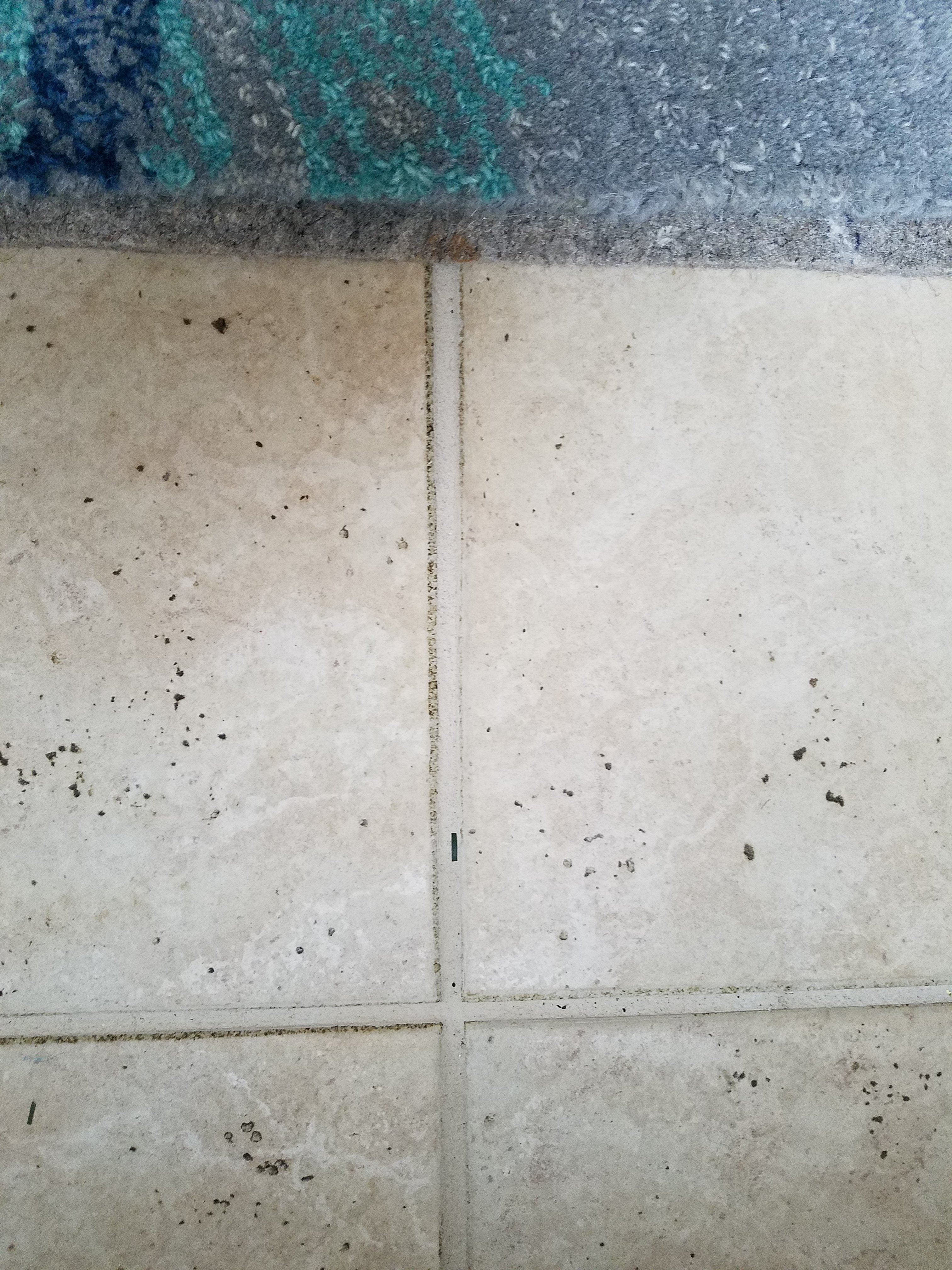

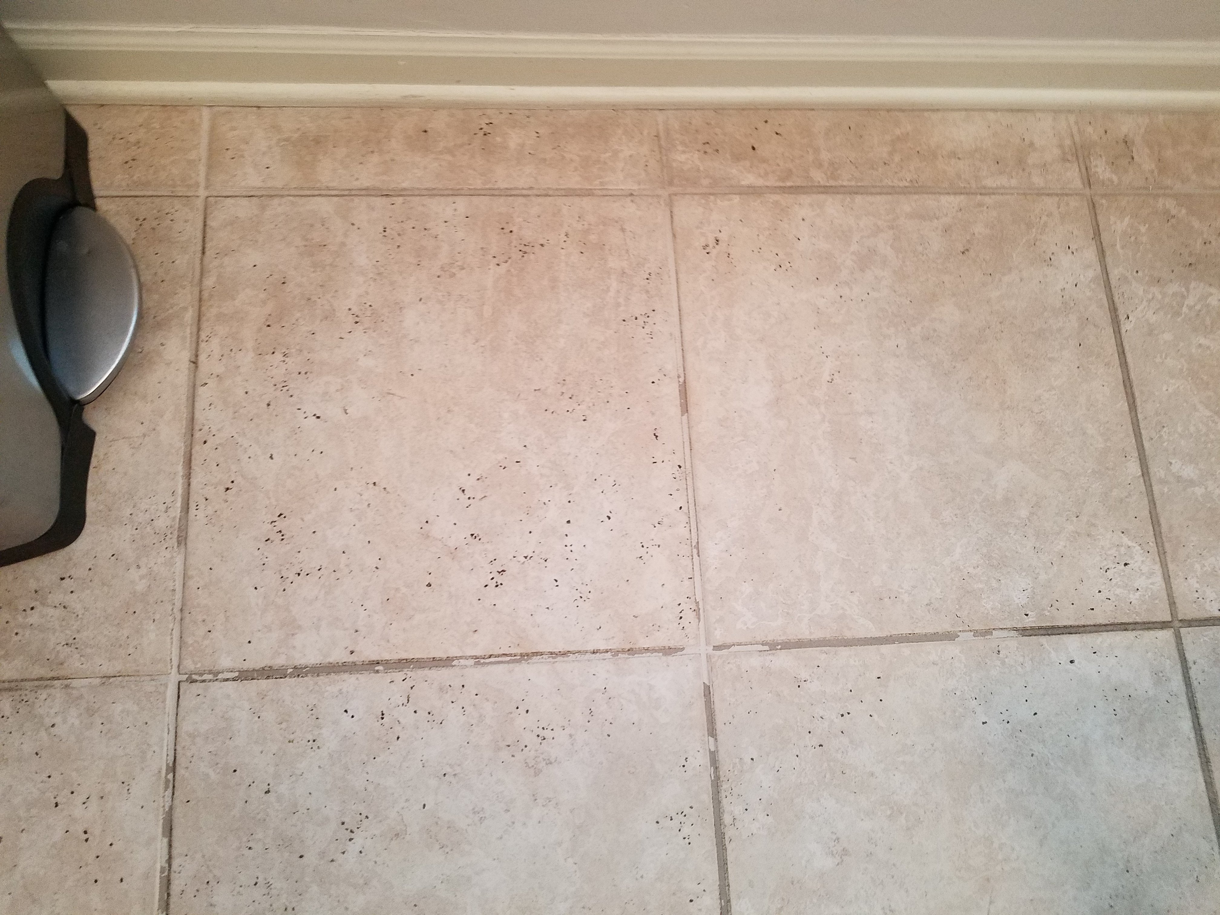

This is all I got....
Thanks Bjorn!

It looks like antique white. You can blend any color yourself and just fade out the edges. It won’t show except it will look new. I carry bright white and a tan and I mix to match when necessary. Antique white is also very common. Run the edges a couple feet past the area and let the brush run dry. You need to be a little artistic but I’ve done it plenty to fix a spot and the customer never sees it.

Look like Snow White. Antique white looks greenish against warm tiles.
