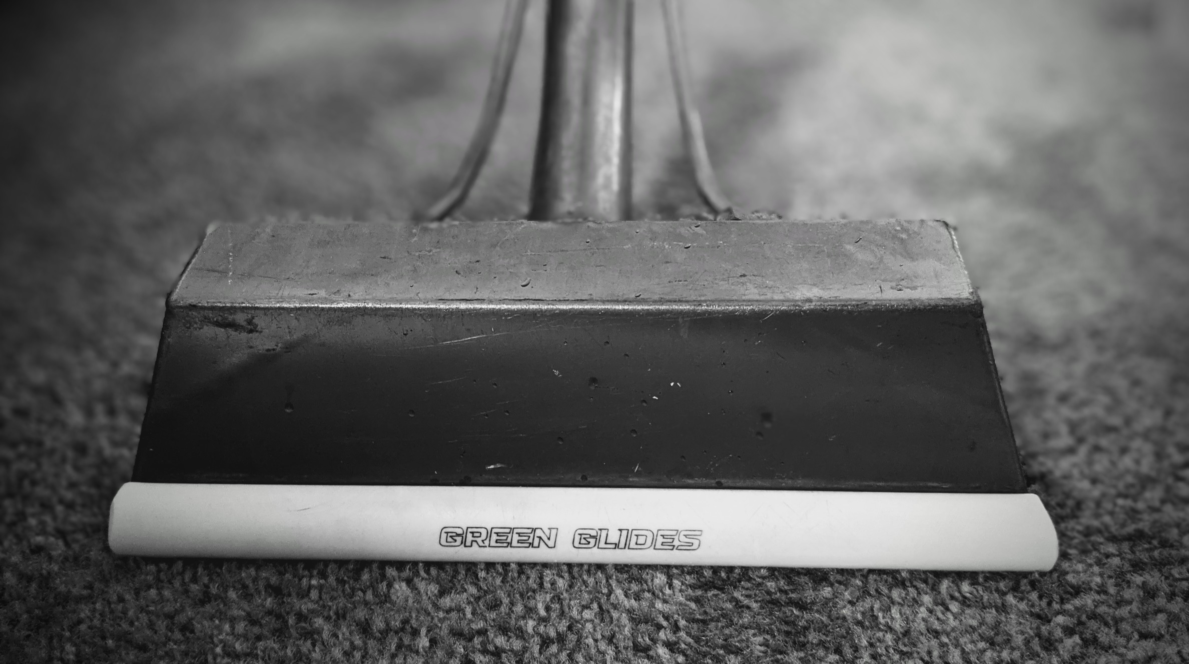

Extra dry strokes for me @ 525 cleaning passes per minute solution on, followed by 525 drying passes per minute, solution valve off.
This is how I can offer the fastest unassisted drying times available.

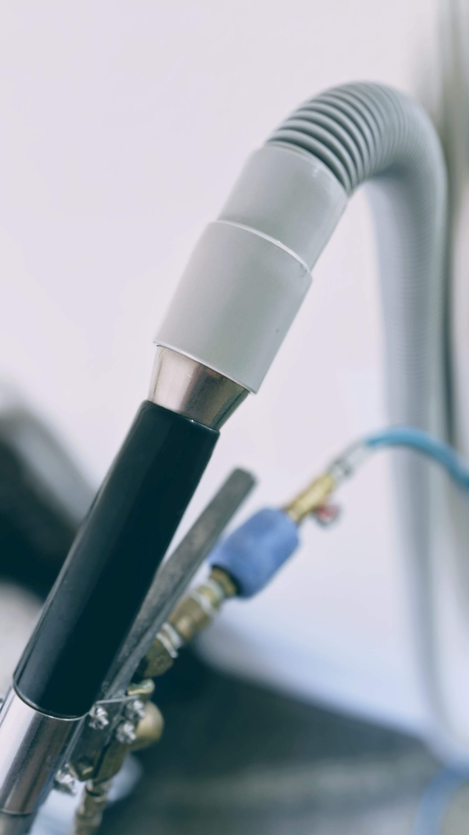

Thats a Joe Valve. Joes is going to pop a gasket when he finds out Sam Miller sent him that.

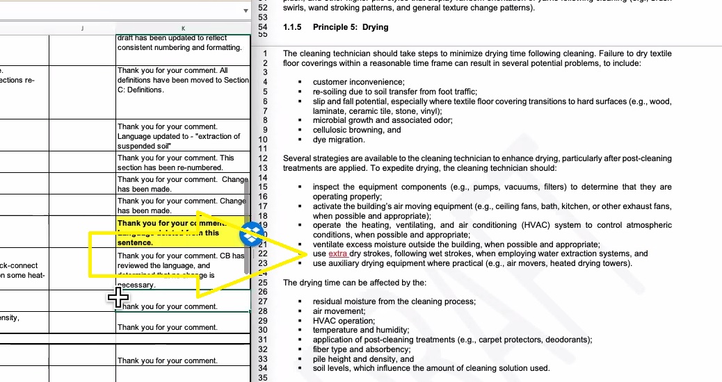

Standard is 1 wet, 2 dry
Extra dry stroke?
One wet and THREE dry...
Pretty straight forward....
What do I win?

Not nitpicking the wording, but consider this:
What we call "dry strokes" are actually passes of the wand that extract more water/soil/detergent. The carpet dries more quickly as a result of extra extraction passes, but it also is cleaner, with less detergent residue, and less chance of wicking and post cleaning bacterial odors.
There is yet to be a system invented that removes the dirty water and only leaves clean water in the carpet yarns.
Wet carpet is undercleaned carpet.
