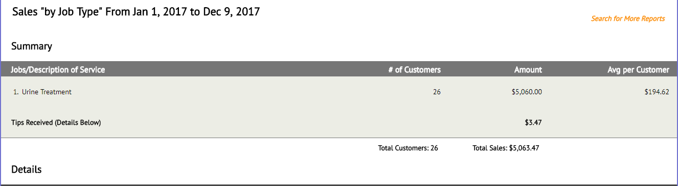

So all this urine excitement got me thinking. So I ran a report to see how much urine treatment I have actually done. Well, this sent me off on a 1 hour search in my database. It took so long because I had a different names for every urine job. The service name would vari from "Urine Treatment, WaterClaw, deep Flus, Urine Decon, Pet Stain Removal". So I had to go through every job for the last year and change everything to the standard "Urine Treatment". I now have a clearer picture.
Although it might not be impressive for you big guys out there, my total so far for the year is $5,060 in just Urine work. It should be more next year since I have started using a faster technique and now offer the service more.

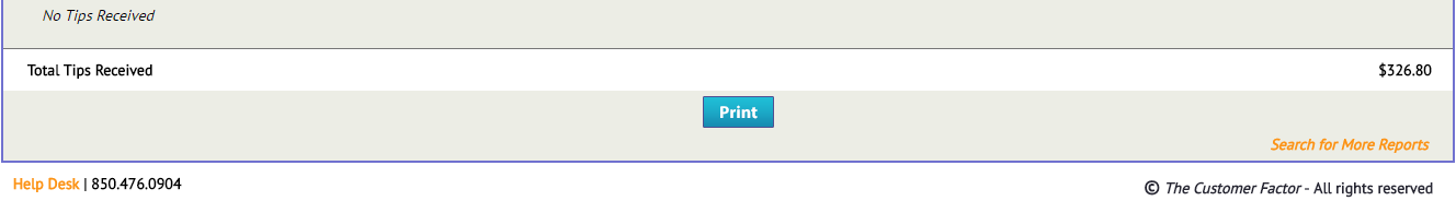

Here was my actual Tips. I never ask for tips and when I see people wondering I always tell them it's not necessary. I tell them just give me a referral.
