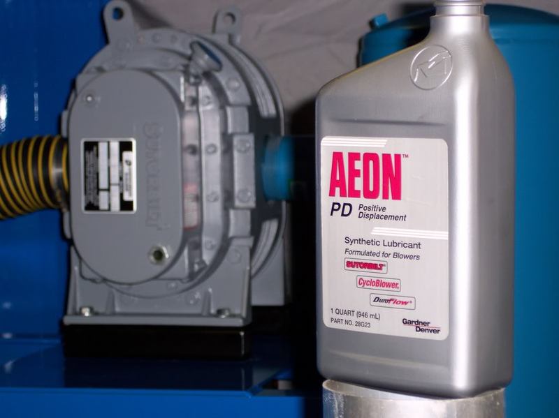

What kind and weight of oil do you use in your blower?
L
Leslie Judson Jones
OIL
BOB
If you have a old blower like 10 years old you can use 30-ND motor oil.
If it's a newer blower use this oil in the photo.
THANKS
LES

We use Aeon synthetic in all of our TM's. It's the best choice
If you need to use a conventional oil it should be 50W on the engine oil scale, to have the viscosity needed for the heat.

I found a Mobil 1 synthetic oil that exceeds the Aeon PD spec and has better performance under high heat applications. I have compared the spec sheets on each product. The part number is SHC 630, it is carried by Grainger (item 6y778) locally and cost less than $15 a quart. I have a Sutorbilt 4MP with well over 5000 hours on it now and it has never had to have any repairs. That's running at 3250 rpm and with my vac relief set at 17" HG. I change it every 250 to 300 hours. I also grease it once every week regardless of hours. The only reason I found it was the local Sutorbilt rep told me he recommended it over the Aeon PD, especially here in Texas and being in the carpet cleaning industry meaning it was inside a van. Both meant higher temperatures and he recommended it for that reason.

Aeon PD is the best choice for Sutorbilt (Gardner Denver), but actually using the Aeon PD on other blower makes, may invalidate your warranty.
This is because the manufacturers specify slightly different straight viscosity grades if you choose a synthetic. For me, it makes no strong logical engineering sense, but I suppose it works to sell the oils provided by the different manufacturers.
Tuthill markets a product called Pneulube Synthetic oil, which they claim is compatible (ISO 100 viscosity) in their blowers, and it is said that Aeon PD, being a slightly lower viscosity is verboten. The Pneulube is also viscosity compatible with Roots.
While it probably doesn't matter a tinkers damn that the two lubricants vary by 10 ISO points, it still is a good idea to maintain the units according to manufacturer specifications while still under warranty.
Some may point out the illegality of a manufacturer specifying or prohibiting a particular oil brand in their units, bit this is not the case here. The manufacturers specify a viscosity grade, and GD Aeon PD and Tuthill Pneulube are indeed different viscosity grades.
If you choose a conventional oil, ambient temperature is taken into consideration. Since the ambient temp is usually above 32 degress F, then an ISO 220 to ISO 320 viscosity (SAE 50 or SAE 90 Gear Oil) should be used.
