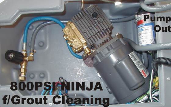

Looking for an ELECTRIC pump recommendation. I am trying to find something that will give me good flow and pressure- over 500 psi- to keep up with a 5 jet wand. Reliability of course is an important issue.
