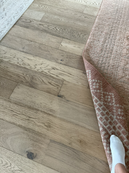

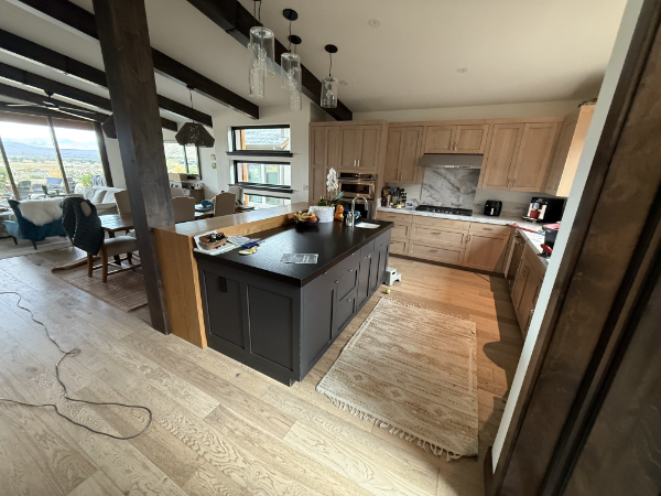

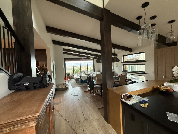

New customer want her 2 yp wood floor cleaned. I asked for photos first and they give me the impression that the engineered wood is a penetrative type oil rubbed type vs a coating
What do you see?
Hi M*********

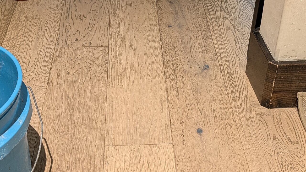

The last photo shows a concerning amount of soil on the wood, the photo give me the impression that the planks are not coated with a polyurethane or similar top finish, but rather a oiled hand rubbed penetrative sealer, which unfortunately often leads to soil absorption from dirty mop water.
It would be best if I came out to test a few small areas to see if we get the results your are looking for.
I have a $200 minimum for this, which would be deducted from the final bill if you proceed with the work.
Cost wise for the wood and area rug, we're looking at $1000 -$1200 If that all sounds do-able, I can come by this coming Tuesday around 9:30 AM to test the floor.

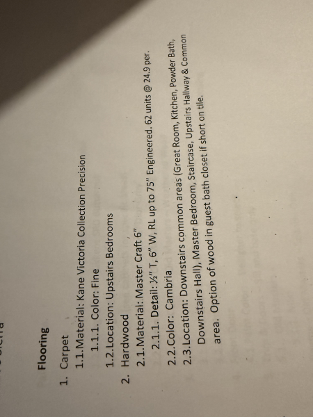

Sure that would work. I would want the cleaning to work. Do you have ability to clean it if it’s oil rubbed sealer?
yes, but the results probably wont be as great as if it were coated.Do you have any record of what wood product it is? Manufacture, product name or style, SKU, receipt or box lying around in the garage perhaps?
Yes. Let me see what I can find!

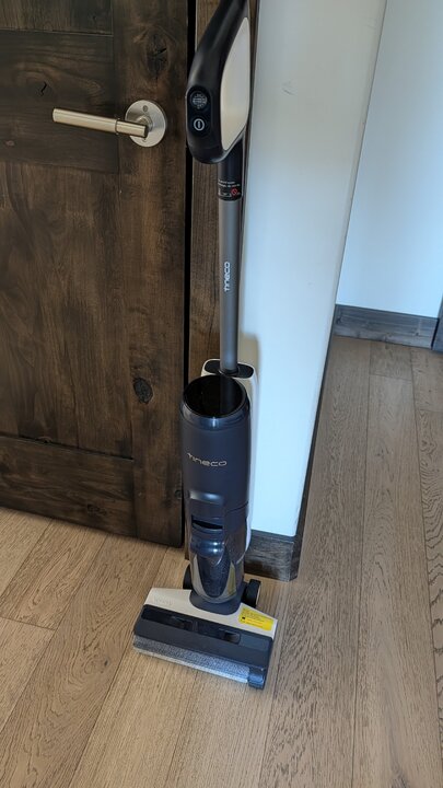

How have you been cleaning the floor?
whats your mopping process?
I have a vacuum Mop- I’ll show you. Yes- come on out, let me know when.

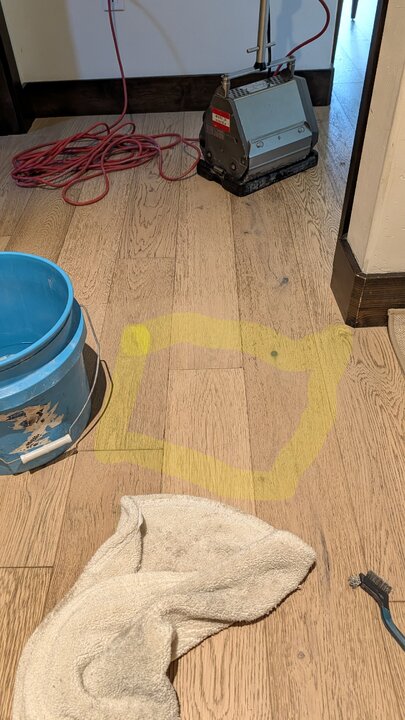

More than likely I'll mop down neutral cleaner at 150 to 200 ft at a time use a white brush under my crb and a 150 psi rinse from the truck mount and it'll clean up beautifully..
If it doesn't respond to doing essentially the same thing by hand, I'll walk
Me that level of soiling looks highly suspect for 2 years worth of living
But she said something later about using some goofy device to clean the floors so it's quite possible it's just recycled mop water residue

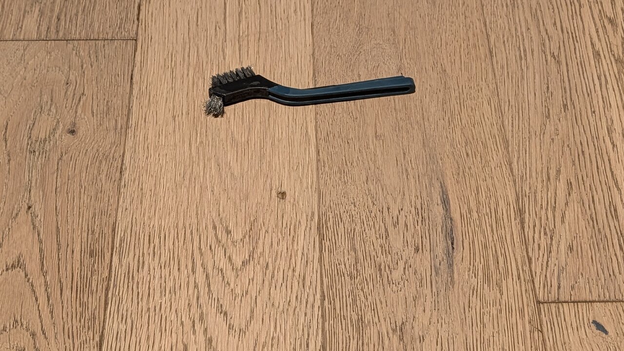

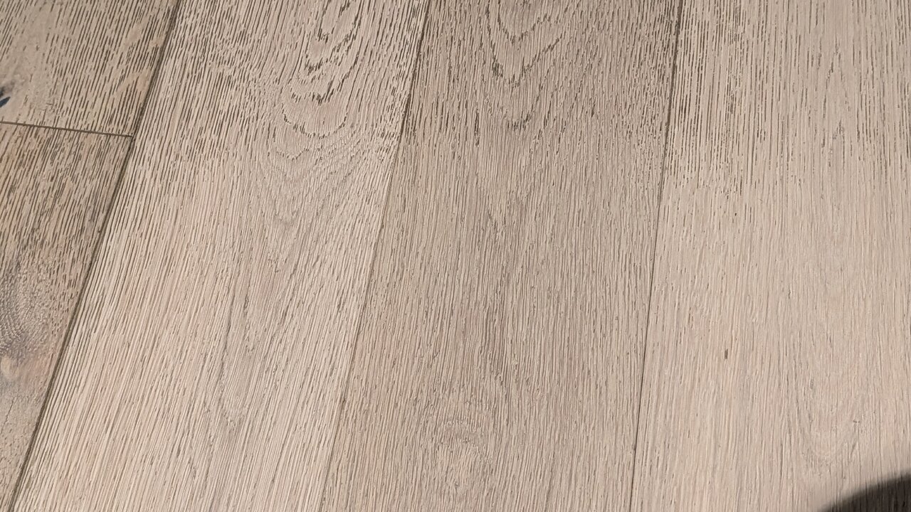

Ran my test today with neutral cleaner and some ham brushes which did not have a fine enough bristle so without the white crb and I'd say I got it to about 90% which she was more than happy with but I'm a little leery of how slow and how many times I need to go over it and how much chance there is for water to seep in
Traditional engineered wood with the valve 1 and 1/2 mm of top layer
Unfortunately I forgot to bring my compound but most likely use it instead of the water-based neutral..
