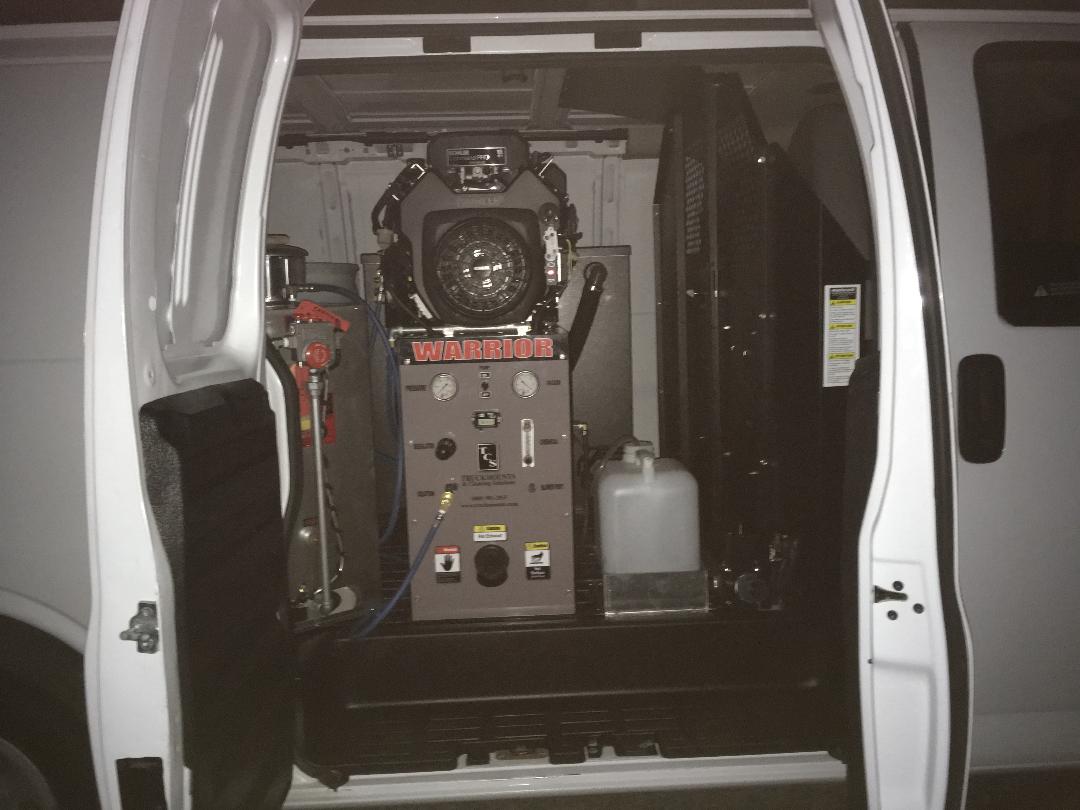

What the bearded man brought.
Jim Williams
Oct 8, 2006
1,465
Jim Williams
Not Santa. Rodney from Sunbelt. Just in time for a tax deduction.

Why not cram it to either side for more free space?
Good question. I guess I should have hung around for the installation to supervise. The heater was supposed to go further back to help keep the pilot light out of the wind better and allow space for a chemical rack on the passenger side. Might have to do some rearranging. If the headpack was moved to the other side it would be a great spot to slide my spotting machine into.

Do you need access to both sides of the unit to do oil changes?
No, everything is accessible from one side. It will be nice when the time comes to change the belts or replace the blower or motor. Plenty of room to work without standing on my head. Having room for my portable to ride with me everyday could be a problem but I don't use it but once or twice a year.
