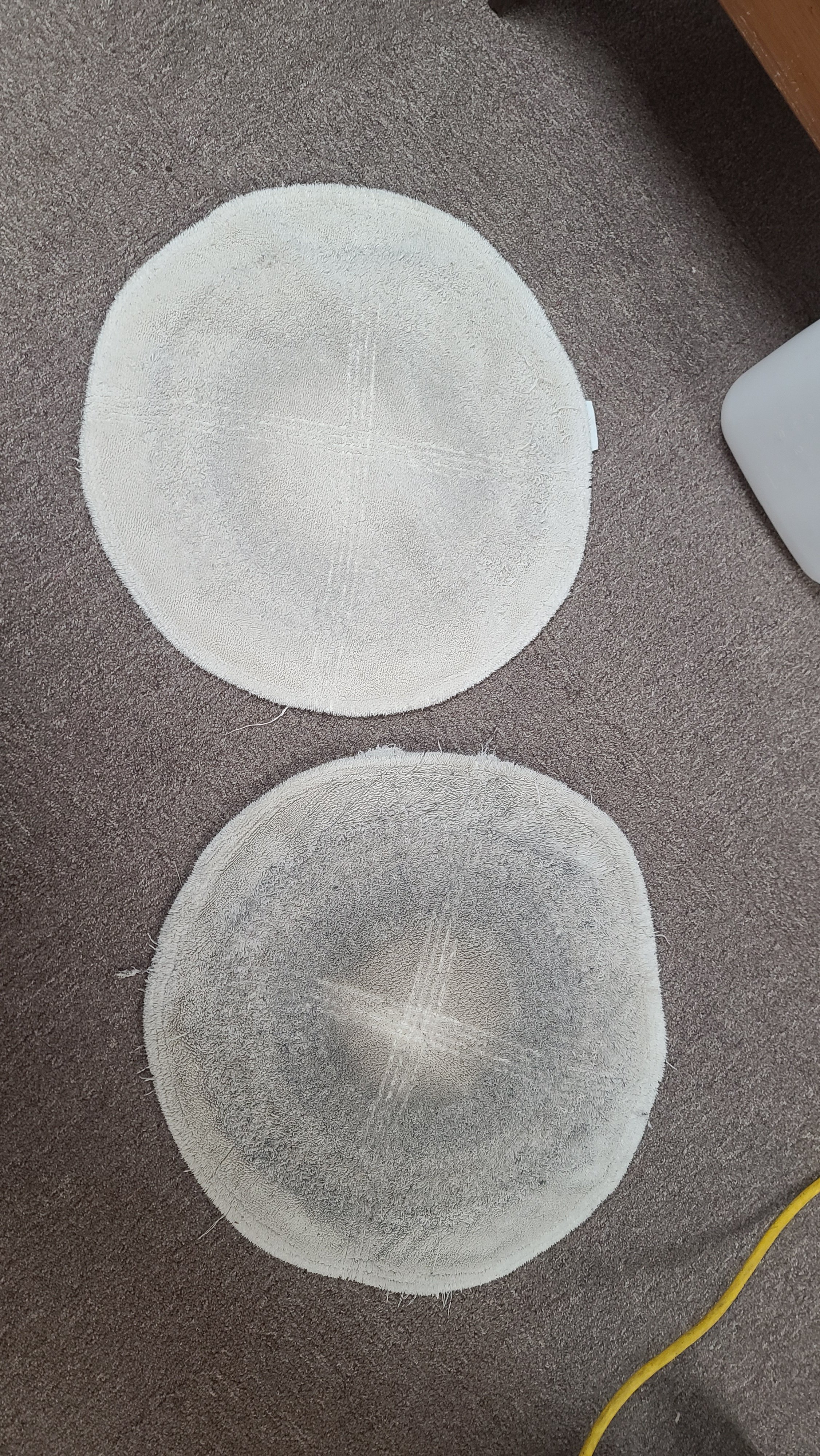

What's the best cleaner to clean your cotton bonnets?
Scott S.
Feb 3, 2008
3,252
Scott
I typically use microfiber wash, but some of them just don't clean up well anymore, do you bleach these?
