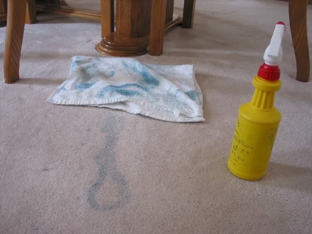

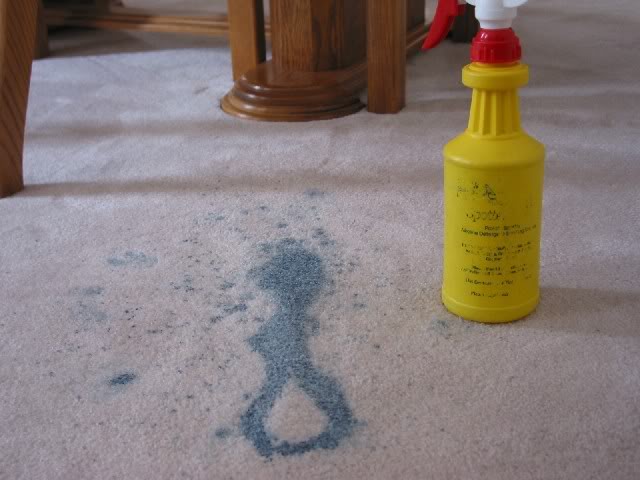

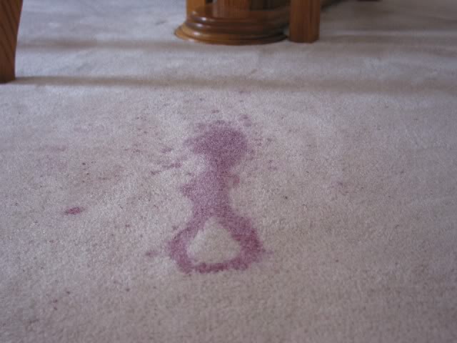

Before and after Wine stain -
Next some Ammonia was sprayed onto the stain. If the customer is watching, tell them that it will turn green - they will be impressed though who knows why.
Towel off, re-spray with ammonia and add equal amount of Hydrogen Peroxide.
Give it a few minutes a and then towel off. If the stain is still visible, repeat the process and if that does not do the trick apply some steam.
