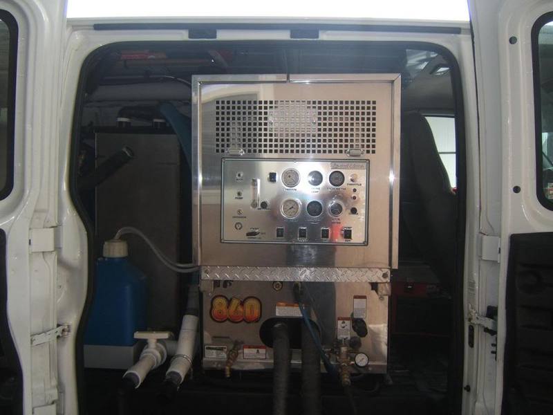

What's this truck mount worth(Ace 860)?
A
Able 1
I know these have been known to have a lot of problems, and rarely see one with over 1000 hour that hasn't had a ton of work done to them. From what I have read the biggest problem is the blower coupler. This one froze hard enough to crack to freeze the stainless heat exchangers, so I would guess the brass heli coil and water pump is also shot. After the big freeze they drained the water out of everything. The machine has only 322 hours, but hasn't been cleaning carpet for at least 5 years though they do start it every once and a while.
Seems to me I would be buying someone's problem, but it has good components( 59 blower, and Nissan engine). So what you offer:

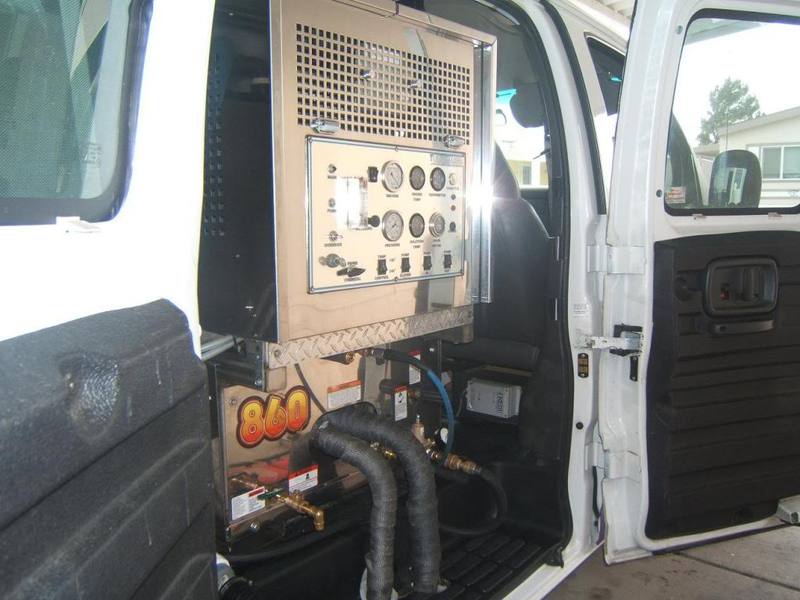

What's the price?
I told him I would post it here to see what you guys thought. He doesn't know what to ask for it. It is in a 2003 chevy 1 ton with 24000 miles, but I'm not interested in the van. I think the van would be worth more without the TM in it anyway. He also has an aluminum 110 gallon fresh water tank, 250' hose reel, aluminum shelf (at least I think it was aluminum).
