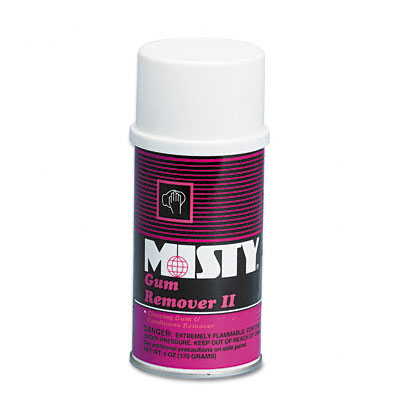

LMAO @ you guys, if you want to remove that gum from the carpet fast , freeze it. I worked Theatre maintenance for 12 years , nothing works faster on commercial carpet.

I agree freeze. Get some freeze spray and thats stuff gets very brittle. Screwdriver will break it into little pieces. Doesn't matter how old it is. You will be left with some residue which I first place my steamer on and then the glide will pick it up usually.
