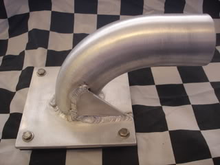

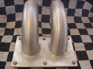

It is the last picture on that stream. The one with the offset ports. He may be able to have it made in a single port for 47 blowers and down. Email him or PM I am not sure. But dude let me tell you it rocks. 8) The increased air flow is way more than you could imagine. Especially on a clutch drive system, as we are limiting the blowers capacity the most.
Greenie

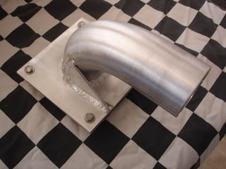

Keep in mind these are Brand New items, I've not even got them refined yet, these pics are of the first 2 or 3 I pulled from the shop bench, I rushed my welder to crank these out as guys were waiting patiently for a long time for the first ones.
We will be making more in larger runs later this month and refining them as we go.

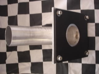

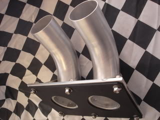

As of right now, the dual ports are on a 6" x 9" plate, and the singles are on a 6"x6", but i will be going to a 5x5 on the next run so more guys can make use of them. I will also make a dual "straight" port version for side tank mounting it will not have the smooth 90º elbows.
These can receive raw 2.5" hose or a Vinyl hose cuff.
Here are the ready for sale pics, including rubber gasket and stainless hardware.
Somebody will ask, the suggested retail with gasket/bolts is $59 for the single, and $125 for the double, avail. soon from any GG distributor.

Most cost effective way to improve vacuum I can think of. I tried the 2 -2"to a y. No comparison to the 2.5" straight off the tank. Plus you can run your 2.5 " hose as long as you want then go to a 2" lead. Much more convenient than 2-2" hoses.
2.5" upgrade. Not just for V/AT's anymore.

I was able to schmooz a single port from Greenie for my Powermatic. I'll tell you this, with a 2" PVC elbow off the wastetank and 50 ' of 2.5 inch, my lift was reading about 8 or 9 inches. When I converted over to the Greenie's set up, my reading is now about 3 inches of lift. That tells me the resistricition point has been removed or reduced and I'm getting net lift now without any outside drag factors.
