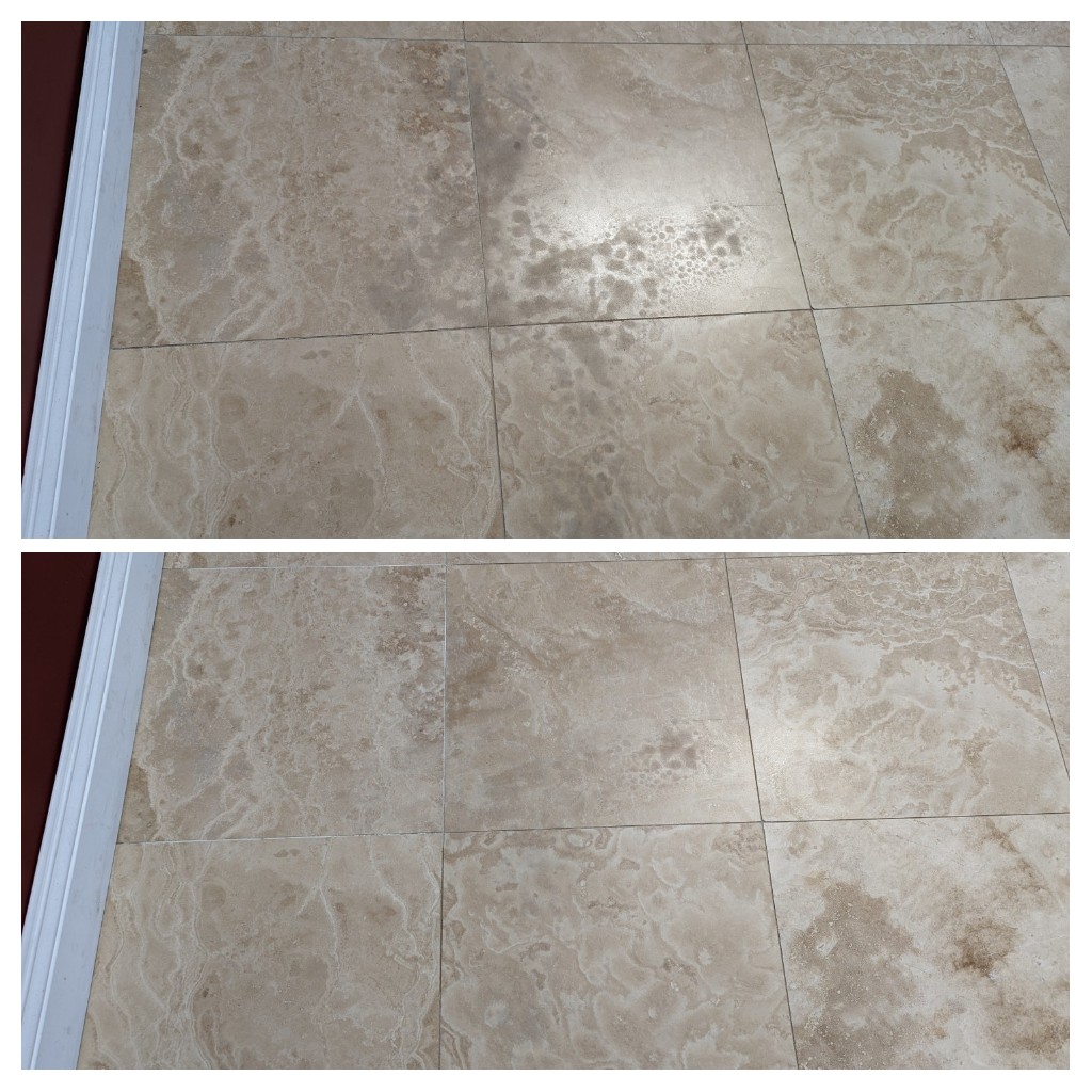

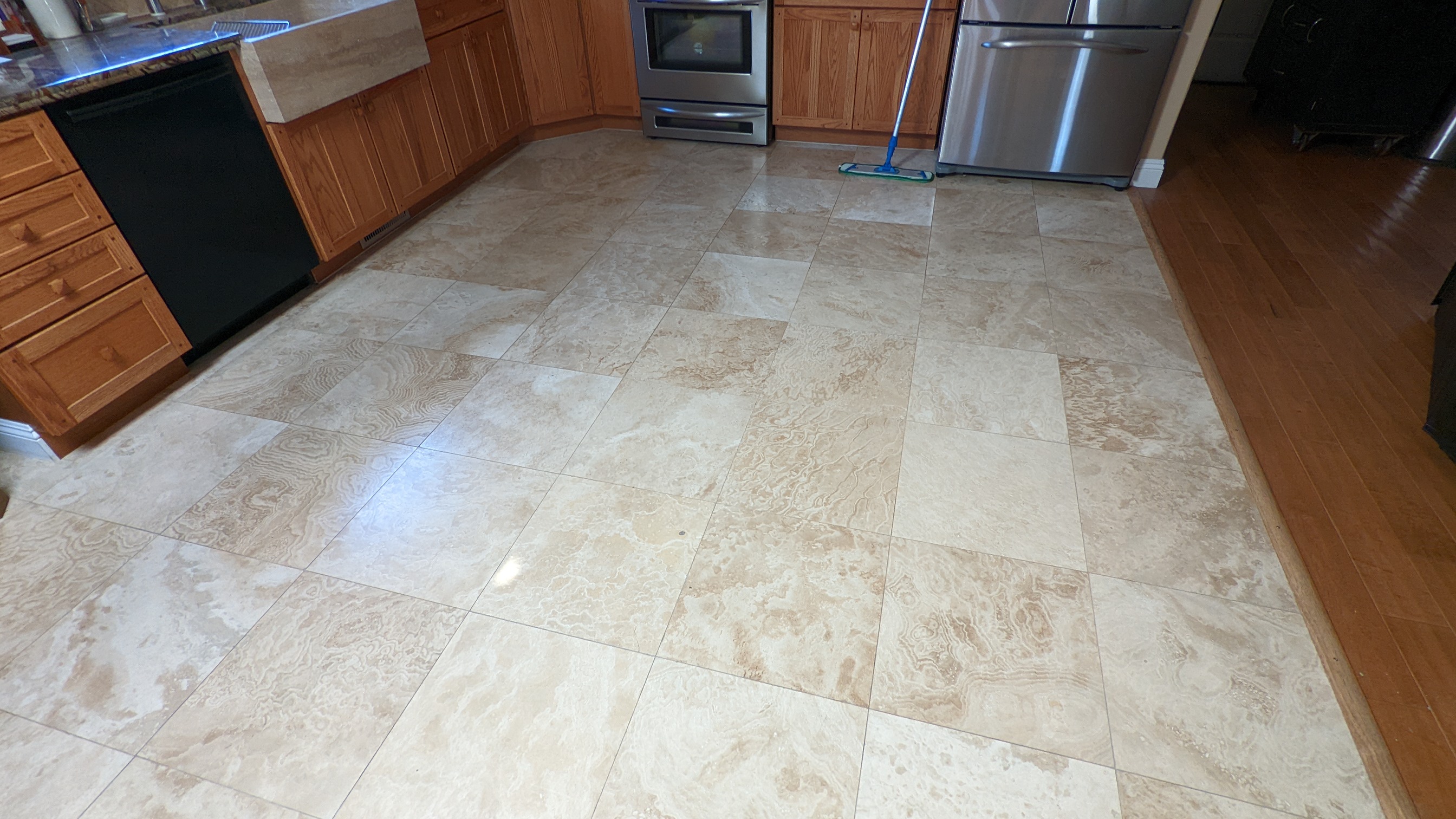

I've left footprints as well using Tsunami. Needs to be acid rinsed to prevent that in my limited opinion.Not only did I misdiagnose this floor from the photograph that I posted elsewhere. I also blew it in the freakfact that my Crocs left footprints after using Sager tsunami and sugar oxy end cap to chemically etch the floor, normally I would have used 40 volume but I removed it as I'm headed to Vegas on Saturday and the only peroxide base product I had was the oxy encap, while it worked well, there were some kind of weird chemical reaction with my favorite casual footwear
You are correct sir and I should have ran an acid rinse but my travertine etch prevention intuition wasn't working well today.I've left footprints as well using Tsunami. Needs to be acid rinsed to prevent that in my limited opinion.
Should have said, my experience, as I don't do a lot of hard surface floors.Wisdom

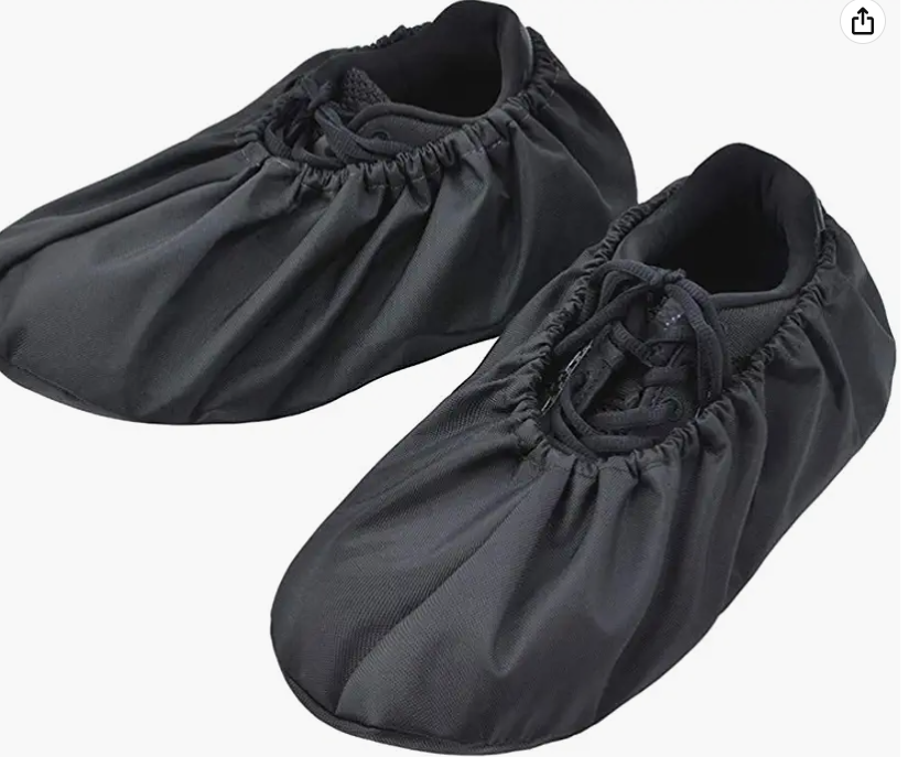

That happened to me before with some tennis shoes. Went to shoe coverings which solved the problem. Also good for giving estimates. They have a tread on the bottom and last forever.Not only did I misdiagnose this floor from the photograph that I posted elsewhere. I also blew it in the freakfact that my Crocs left footprints after using Sager tsunami and sugar oxy end cap to chemically etch the floor, normally I would have used 40 volume but I removed it as I'm headed to Vegas on Saturday and the only peroxide base product I had was the oxy encap, while it worked well, there were some kind of weird chemical reaction with my favorite casual footwear
