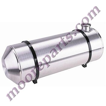

Mounting the tanks on the tongue is the way we do it here. We use Spun Aluminum tanks. A little welding and they mount up easy.
As for your truck you will be fine as long as you don't buy an 18-20' trailer :?

Marine Tank? These are what we use
