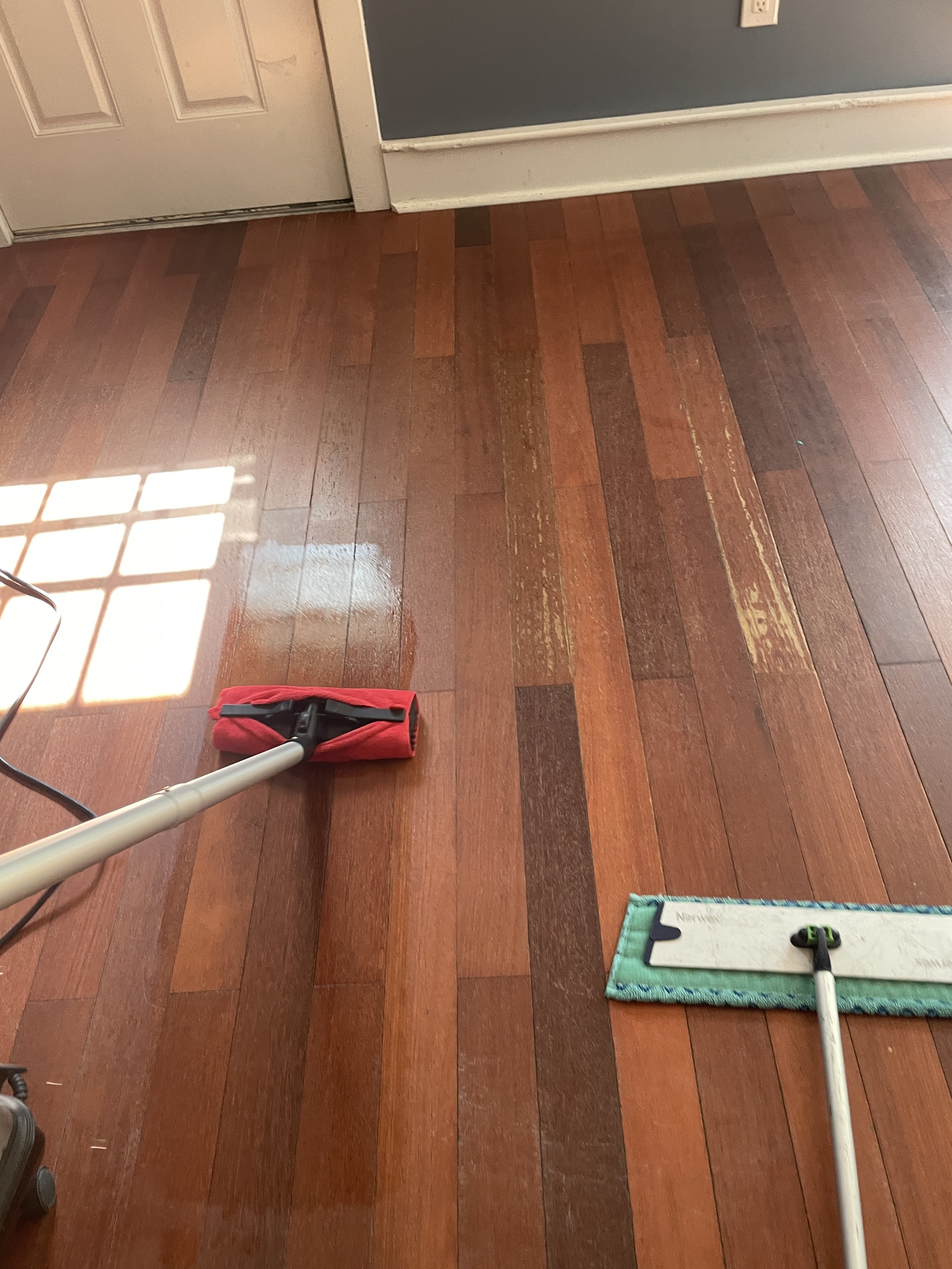

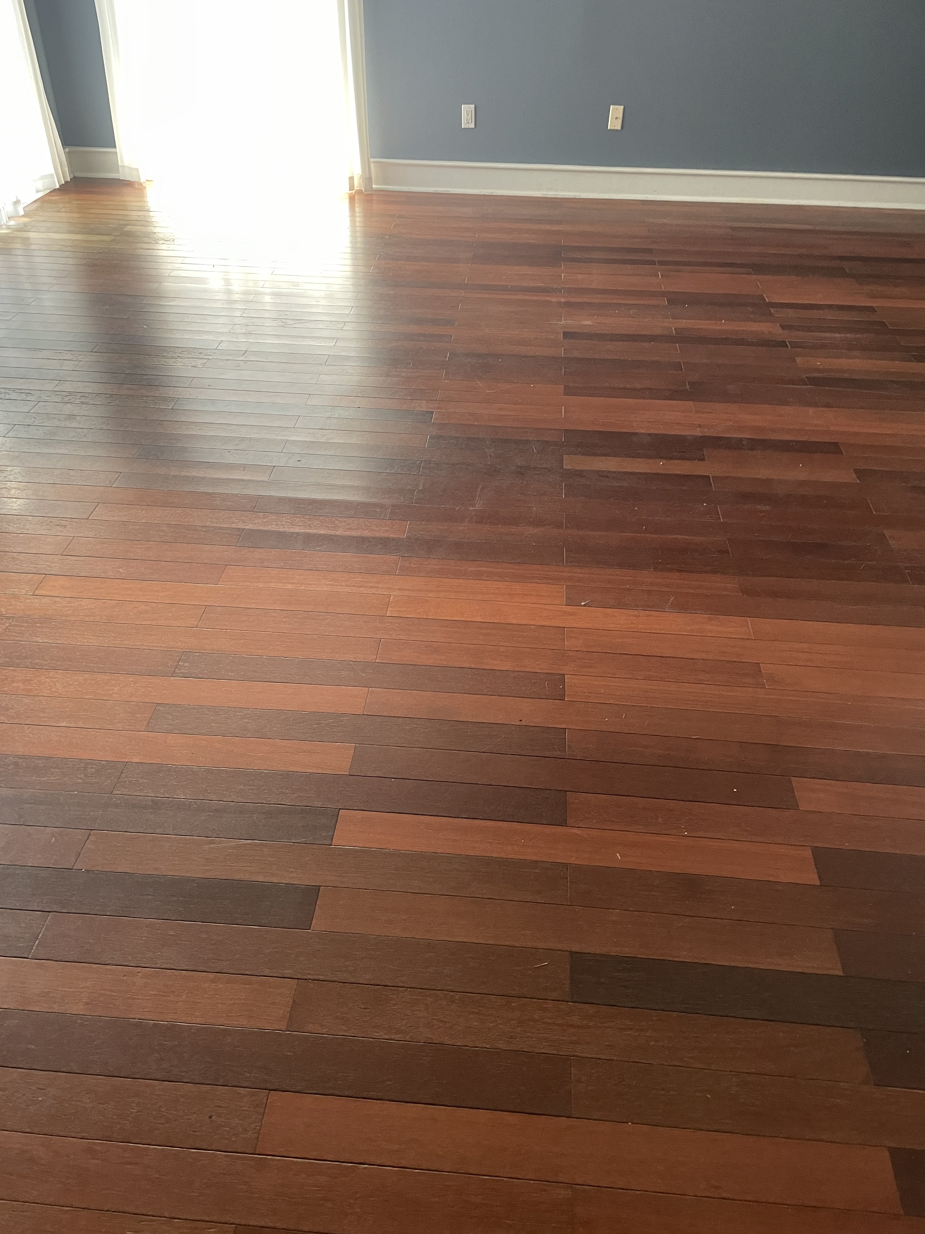

I want to HWE and vapor steam this wood floor. Using the Hydroforce tool with the brush.
Pressure 3-400 psi and go low moisture HWE. I got some Squeaky product (looks) Like windex. I run the HWE and another guy Vapor steams and Microfiber Follow Up Immediate.
Work it in 10 X 8 squares.
What do you think. long time customer moving in to place after a rental trashed it. I took care of the carpets today, the place was dirty.
what's with the steam??
light shining by the slider magnified, looks like the seams are already peaking

IMO. It will not look any different after it is cleaned, whatever the method. It will need the proper finish applied after cleaning. Maybe some buffing before and after. I wouldn’t do it.

Yes, im just talking getting the grime out of the seams. I have a day off tomorrow and I texted the owner and they are glad to let me give it a go. its a perfect opportunity with no pressure. the place was pretty nasty. I will get before and after pics.

I got vapor steamers that kick ass. I vaped cleaner floors just because they wanted me too. Its all about quick dry follow up with microfiber. Hopefully I will have some incredible results. 9 hrs away....
or a pissed off homeowner. Nah, they are good.

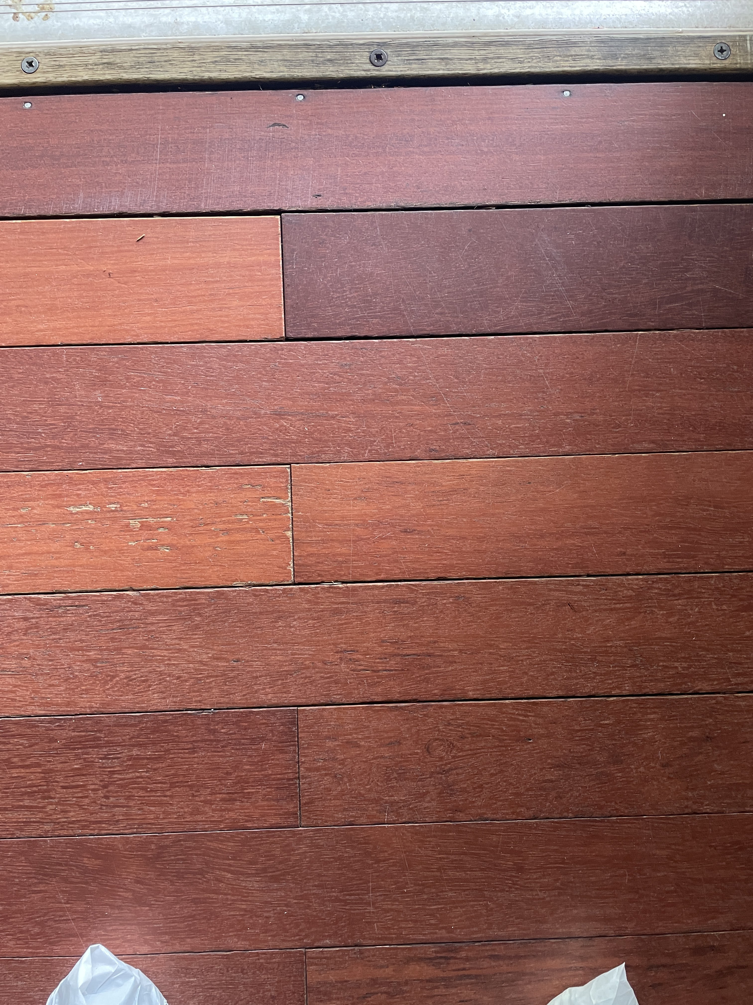

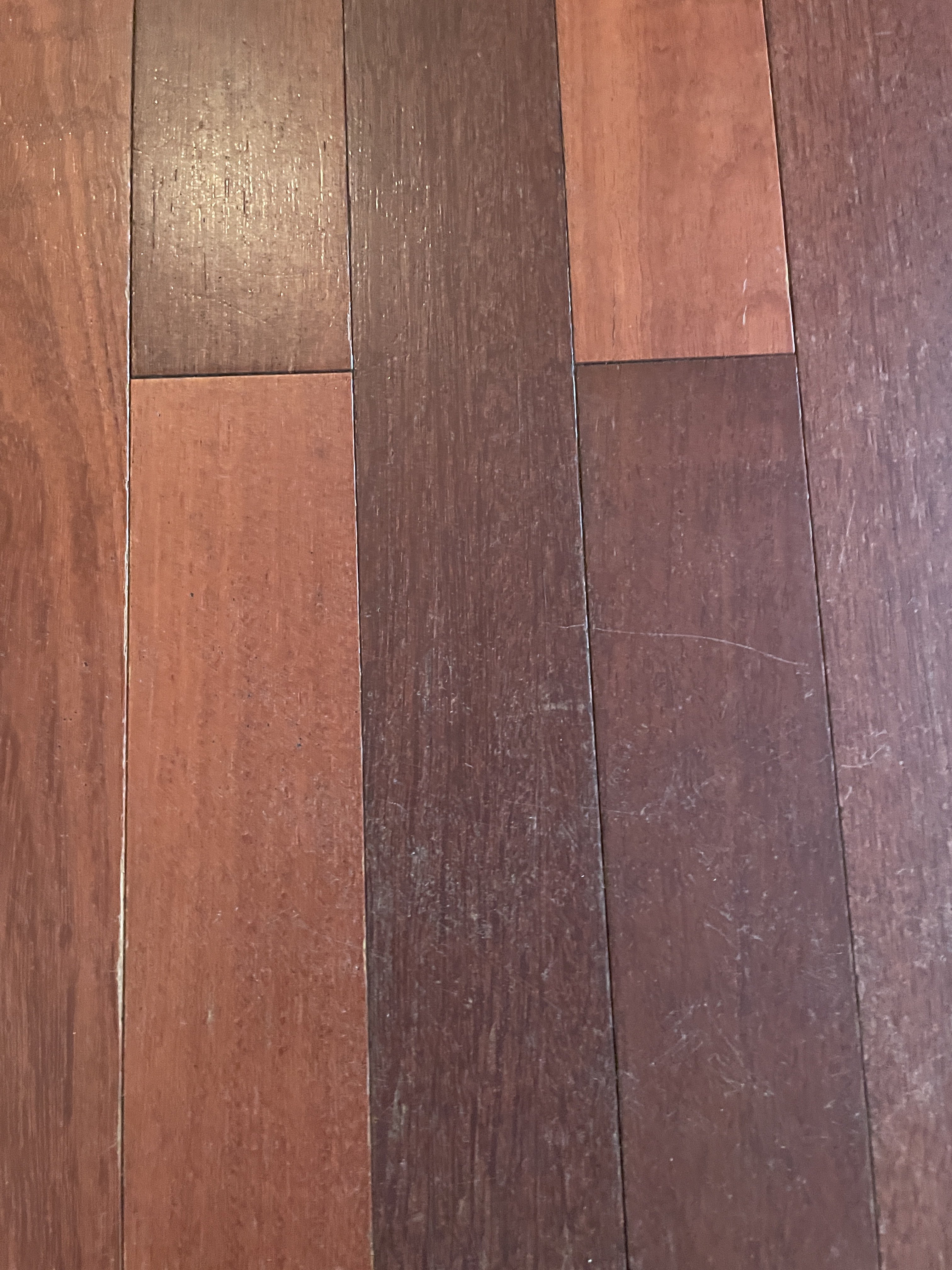

Came out good and clean. Very easy set up made it very easy job.
Before
After
So as long as I don't get a call that the floor is popping off the subfloor, It was a success.
Before I cleaned it, it was sticky when walking on it, now it is clean and can feel the difference more than see it.
